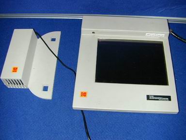

Tell us more about the Kodak if you can
zardoz
Kodak AGAIN
The thing is that i dont know anything about this pannel and i was wondering if anyone out there knew anything about.
TO BE SPECIFIC.
1. Is it VGA or SVGA & Does this matter
2. Can i use it to watch films as some pannels may be to old.
3. Any Other Info About The Pannel
So can anyone anwnser these questions.
If this panne isnt suitable does anyone know where i can find one that is. IN THE UK
Many Thanks
Chris

Where did you find it? Why not ask the seller what model it is etc....

I guess you are refeering to the item from Ebay uk. I made a simple google search for your panel and found some data. I searched the google results and found that the panel is from 1986. All the google hits refeer to monocrome panel so this will not work for projection purposes. If your panel is the HR version then its for sure only black and white.
I searched for the info so that I won't have to see your posts on all the threads screaming for information about your panel. Please be kind enought to the people on this forum to do some elementary checking yourself before getting inpatient when nobody know about your panel.

You probably think we are being horrible to you but we are not.
It just seems that your panel is a very old one that is most likely Black and white and with the word Data in the description was probably used in the old days for static computer display.
Its not a normal projection panel suitable for video use that we know about so I think its not usable.
As far as getting a suitable panel in the UK not much help for you there. Suggest read the good panel/bad panel thread to get an idea of panels that will work for you and then you have to find somewhere that sells one. Probably best place is Ebay same as we all use.

Well thankyou for all your help. And i am sorry for being a little short tempered with you.
Well at least now i know not to get that pannel.
