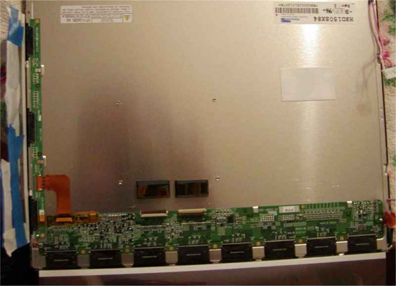

Here it is. Note the short flat cable on the lower left. The connector is a 20 pin subminiature that flips up. This prevents the boards being relocated out of the way so you can remove the backlight and replace it with an OHP. It would be nice if we had a source for extension cables, but I am sure if they were available someone would have posted it by now. If I can find the female connector, I may make an attempt to create my own.
It is now back together and working fine. I didn't look at the pictures until after it was back together, so I apologize for the quality and the shadow of my head and the camera.
