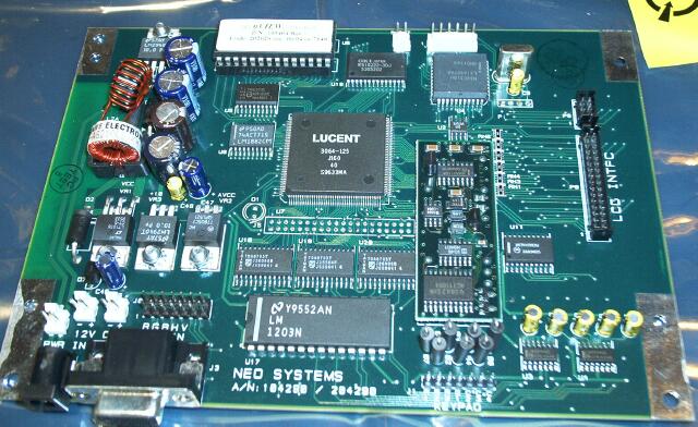

Bottom left is RGB computer input.
Mid right is TTL LCD out.
Bottom right is keypad. Possibly on screen display.
Top right some other connectors no idea what.
Check chip numbers on google might help what they do.
I would guess its an LCD controller.

Top right looks like power in for the controller (4 pin) and the 2 pin connector looks to be power for the backlight invertor.

Thanks for the info, when it arrives, I will take a closer look at the chip numbers and google it.
