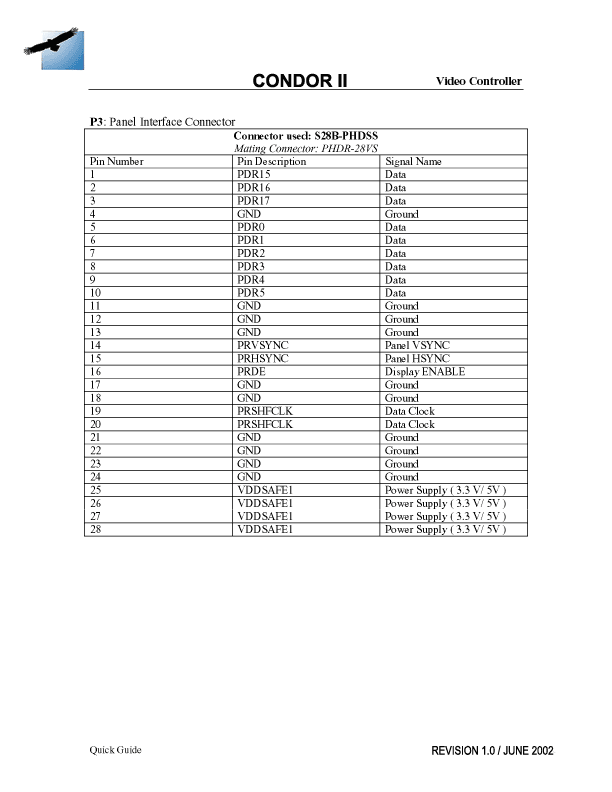

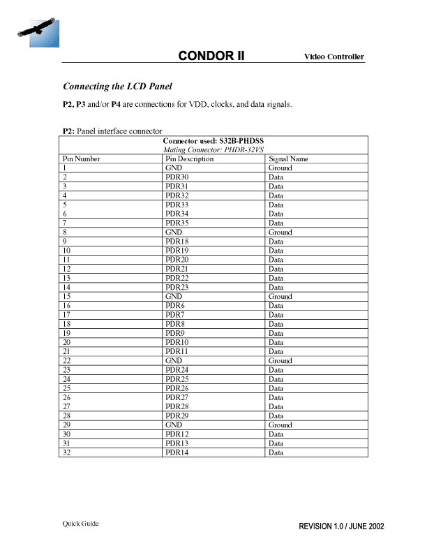

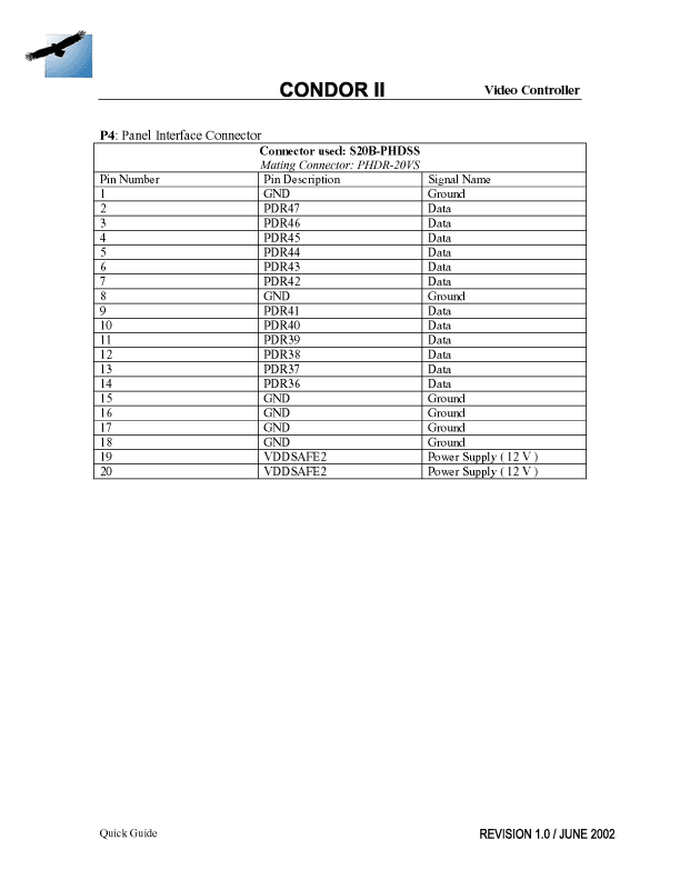

Have you guys found out the specs for the pin layouts yet if not I have them for the 32 pin,28pin and 20 pin I think.
I havent read thru the entire thread yet I got bored and researched a lil and found this page with a controller that has 3 connectors for 32 , 28, and 20.
BTW Im new I hope these will help in some way.

Actually that board looks pretty promising, I saw something similar to that on earthlcd.com, but it was going for $399, I wonder how much that particular board costs, and if we would have to buy it in bulk, thye usually don't sell stuff like that in single quantities. Good find though.

I emailed the rep from the company for those new contorller boards:
"Jason,
I was looking for some information about the Condor 2 NTSC controller board, such as prices and minimum quantities for purchases?
Doug Malick
Jason Replied:
We have a fifty piece minimum our pricing on the unit with cables is 135.00
There you have it. If we can get 50 guys up in here to make a group buy that wouldn't be so bad.
