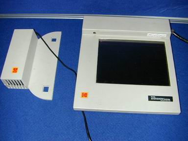

I am thinking I may go this route since I would like to have the most out of the ATI AllinWonder.
Just starting out with the basic OHP and this would get it started in the right direction at least.
Boxing it up can be a second challenge / project for me.
I appreciate you taking the time to measure that out too.
Oh, you mentioned you put the fresnel on the glass, pardon my confusion here, but are you talking
about the fresnel of the OHP or do you have another fresnel with this setup? (Once again, I read your
last posts but dont recall ) Just trying to mentally put this all together and get a good visual of it.
video card ---> Kogi LCD ---> ontop of OHP stage ---> 350w halogen projecting through to top lens...?

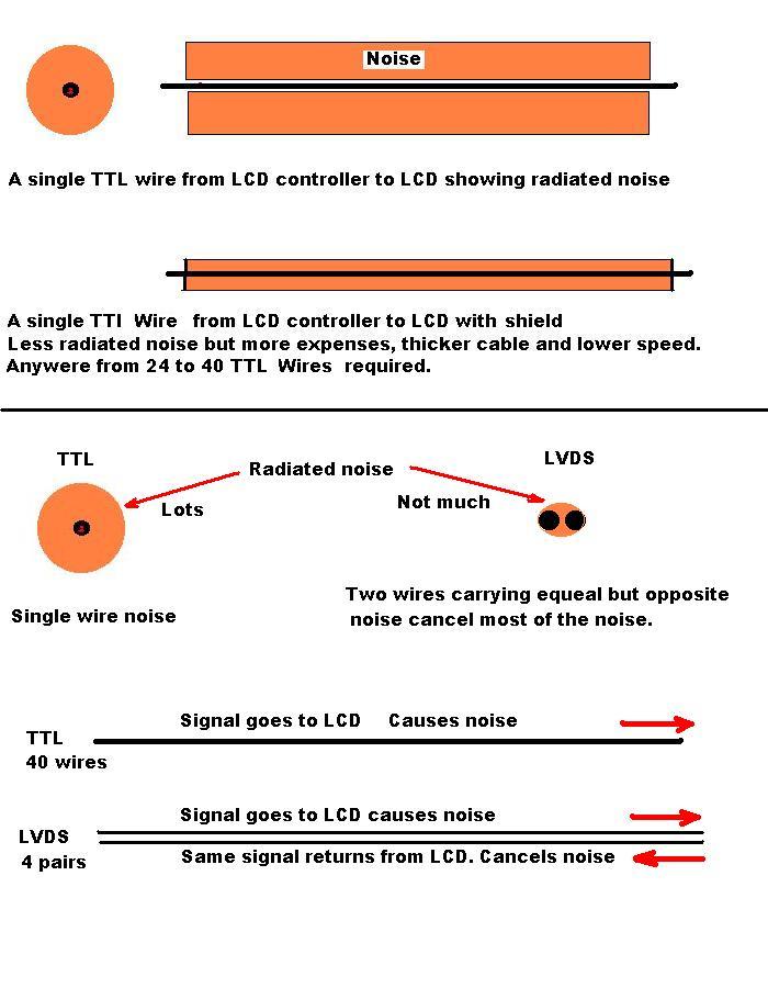

What is the difference between TTL and LVDS as applicable to driving an LCD screen.
One of the things to grasp is that LCD screns demand very high amounts of data to create a moving picture. Very high means extremely high amounts.
There are some compresion systems which send you one frame of a picture, which is drawn on the screen and you see an image. Then if the picture changes they only send you the parts that have changed. This is to reduce the huge amount of continous picture data down to a much lower amount of data. Thats fine except this compression technology is imperfect. So you can see jaggies. Not a smooth high quality picture. It will improve as technology marches forward.
All the better LCD driving systems send you all the picture information all the time even if nothing is moving on screen, so there is a continual large amount of picture data tranfered from controller to LCD all the time. And it looks good.
How do they do it.
As you know there are 3 primary colours in a CRT and a LCD. Red, Green and blue.
If they only sent you the blue picture data you would get a blue screen. It could be light blue, mid blue or any one of a number of shades of blue. Same with red and green. But by sending some red and some green and some blue you get any one out of 16 million colours to colour a pixel. So that pixel right in the center of the screen could be any colour picked from a pallete of 16 million colours.
Sounds like a lot of colours. Sounds like a lot of wires.
Fortunatley there is a simple way.
Inside a digital computer things run on BYTES. One byte is composed of 8 bits. Any of the bits can be on or off.
If all the bits are off the result is zero.
If all the bits are on the result is 255.
The range between 0 and 255 is 256.
So now we can have a red BYTE with 8 red bits that can give us any value in the range of 0 to 255.
Thats good. We can now get 256 values of red ranging from no red to full red
Before bringing in the green and blue lets make a controller to handle the red. We need 8 controllers. one attached to each red bit. This is were the TTL comes in. At the computer end we load the 8 controllers with the red value for a given pixel location. lets say 255. All controllers are on. We send it via 8 wires to the LCD and at the LCD location the LCD decodes the information on the 8 wires and says to itself they are sending me 255 for red , I am now at pixel number 100 or whatever so I will turn on the red part of the pixel full. Thats it. You see a full red pixel at pixel location number 100.
Exactly what is supposed to happen. By now the LCD row/coloumn drivers have moved on to pixel location number 101 and the whole scenario is repeated.
TTL then is a mini controller for each of the 8 red colour bits, for each of the green colour bits and for each of the blue colour bits.
That makes 24 minicontrollers and 24 wires from Video card to LCD. 24 wires. Those 24 wires may be 3 meters long. There is a lot of noisy radiation from such a cable. The longer the wires the more radiated noise.
The FCC have very strict regulations regarding radiated noise from computers so the options are a very heavily sheilded connecting cable or a means to send the TTL signals from the controller to the LCD without making any noise.

LVDS (low voltage differetial signalling) is one of the many ideas thought up to reduce the noise radiated from TTL wires.
In addition to reducing radiated noise by a large factor, LVDS takes the 40 wire TTL signals and instead of transmitting them all in parallel changes them into serial form ie one TTL signal after the other.
This is doen at very high speed, sent down the cable link from controller to LCD and at the LCD end decoded back into regular TTL signals.
In the process 30 - 40 TTL wires are reduced to a much smaller number of wires.
Advantages
Reduced radiated noise
Much smaller number of wires
Not needing double or triple sheilded wires
Can run on unsheilded twisted pairs.
Long distance/short distance
Useful for other devices eg SCSII hard drives
Disadvantages
Additional cost of LVDS transmitter
Additional cost of LVDS receiver although if the panel has it built in no extra cost.
See drawing
Advantages
Disadvantages
See drawing
Speed
Now we come to a very important part of the whole deal about TTL and LVDS.
In part one I indicated huge amounts of data are being sent from the controller to the LCD. As LCD's get more resolution more data is required.
Just to give you an idea take a 1024 x 768 LCD panel.
Good resolution. Nice picture.
1024 x 768 gives 786432 pixels.
But each pixel is red green and blue so we actaully need
786432 x 3 = 2,359,296 picture data
But hold on.
The picture is redrawn anywhere between 60 and 100 times a second.
So at a high refresh rate of 100 times a second we need
2359296 x 100 = 235,929,600
Thats 235 million picture data's per second. Every jolly second that data comes down from the LCD controller to the LCD.
PHEW.
And thats just for a modest 1024 x 768 LCD screen
You can imaging how much data is needed every second for a 1280 x 1024 screen.
Now here is the problem
TTL operates between zero volts = bit off and +5 volts = bit on.
0-5v
In electronics zero volts to 5 volts can take an appreciable amount of time to get from 0 to 5 or from 5 back to 0. Its called the transition time.
The reason for the wide range from off to on is noise. In a noiseless world you could have virtually any difference to signal a bit is on or a bit is off.
For example
0v = off
1v = on
Another example
0 = off
0.0000000001 = on.
In a noiseless circuit the electronic could easily figure out that 0.0000000001 is different from 0 so it could give the correct answers and it would be quite quick moving from 0v to 0,0000000001v
But its not possible at normal temperature.
Noise interfers and thus to make it dead certain that the circuit is signalling on or off regardless of noise they go for the range 0v = off, 5v = on.
So the wide transition from 0 to 5v gives high noise immunity but slows the circuit and ironically causes much noise itself.
Big problem.
How do you get high speed data transfer without causing a lot of noise
The answer is surprisingly simple.
Instead of using a single ended solution,..... use a balanced method where equeal but opposite radiated noise cancels out, and instead of using 0 to 5v, use a much lower voltage swing like 300millivolts on the grounds that the noise is gone.
First get rid of the interfering noise, then lower the voltage swings.
Circuit gets much faster, consumes less power and reduces its own radiated noise.
So we now have a very very fast method of moving data from A to B. How do we use it.
Again its relatively simple. Just get the LVDS transmitter to look at the TTL data, Collect the first piece of data, send that, collect the second piece of data, send that and so on. All happening at millions of pieces of data per second.
The TTL will work by itself but as panels have improved TTL needs assistance at high data transmision rates and distances over a few meters. LVDS assists the TTL signals get to the LCD faster using less power, making less radiated noise and preserving the quality of the data.
This is a simplified attempt to show how TTL and LVDS function together.
There are other ways to do the same or a similar job but if its digital you want, high speed transmission is an absolute must. Otherwise no picture.
How this ties in with LCD panels is like this.
I believe there are thousands of good laptop LCD's available cheap. I think many of them have an LVDS receiver already built in.
But hold on.
PHEW.
0-5v
For example
0v = off
1v = on
Another example
0 = off
0.0000000001 = on.
Big problem.
If you are going to use a computer for projection you will already have a video card. Possibly a very good one.
As you know your video card is all digital until finally it converts digital signals into analogue signals that leave the video card via the DB15 VGA connector. Just before the D/A takes place some of your video cards may have a 40 - 60 pin TTL header. Plug in a small low cost TTL to LVDS transmitter board, send the signal to your Laptop LCD where it plugs into the built in LVDS receiver connector and there you are. Job done.
Life is not as simple as that but it could be. All we have to do is gain some more solid information on TTL, LVDS, DVI. Video cards and what if anything is most commonly fitted on the back of an LCD as a connector.
It's like someone asking you for a drill bit. You say "what size". They say," does it matter". It does matter.
Just a fraction more knowledge and things start to look less complicated.

kodak datview ??? is it dataview?
Yassasin! Yassasin
DATAVÝEW C181 800x600 Pix.
DATAVÝEW C191 1024x768 Pix.
DATAVÝEW E221 1024x768 Pix.
DATAVÝEW M320 1024x768 Pix.
DATAVÝEW 960 1024x768 Pix.
i could not find anything else through a internet search ....
what is the production date of the panel and can you post here ALL the info that you can read on the production tag please ?
dank U wel,
gracias,
merci beaucoup
danke zehr
enne schol!

Re: Kodak Pannels
There's no point in getting annoyed. Most likely the reason no one has answered your post is because quite possibly there is no one here that has had any experience with that panel. I didnt even know Kodak made a panel. If you want I'll tell you it will work first rate....but I have no idea. So cant offer an opinion. Why dont you post it's specs such as resolution, inputs and the like. Then we as a group may be able to "theorize" how it could/should work for you.
Have you tried the "Good panel Bad panel" thread?
zardoz
getem56 said:As no one seems to be answering my questions i am getting really annoyed.
Can I Use A Kodak Datview Pannel For Projection Or has it got the wrong colurs like vga or somthing please help
zardoz
