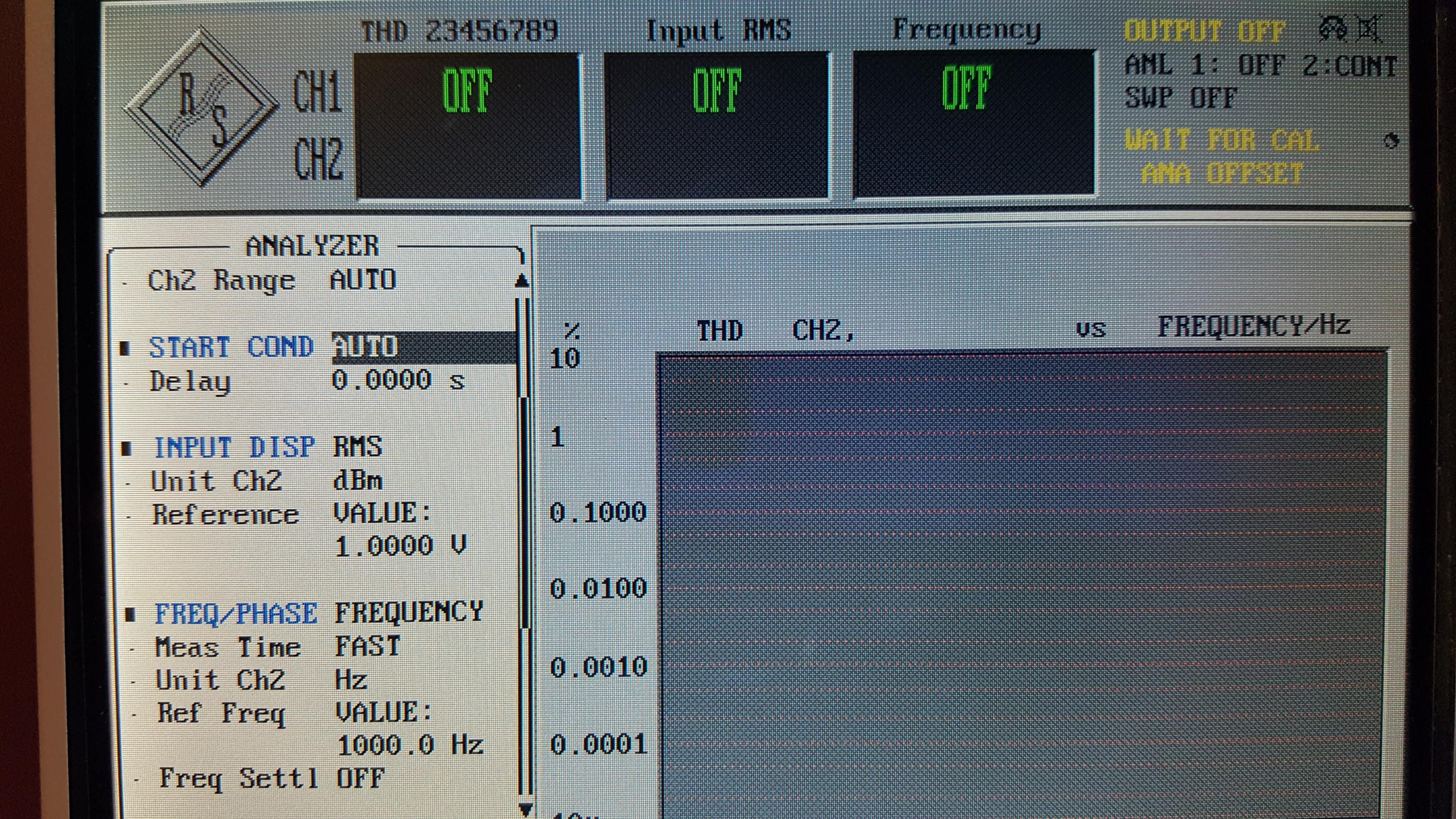

In spectrum analyzer mode with the generator set to sweep mode, it's displaying "waiting for cal ana offset", indefinitely.

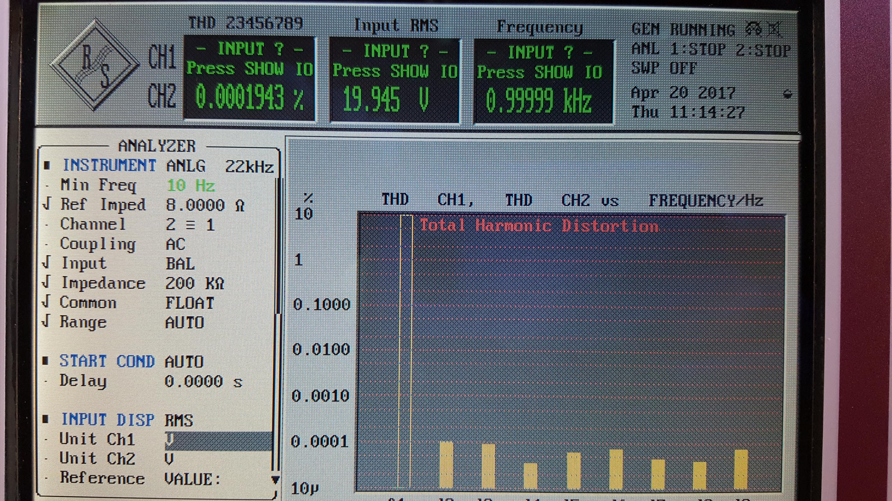

I've got a 20V RMS sinewave input connected to input 1. I'm tracing the signal. Test points as follows:
P4 = 1.8V RMS sine
P6 = 40mV RMS sine
P5 = 80mV RMS sine
P7 = square wave, rail to rail
P2 = 3V RMS sine wave
I note that auto ranging function is not operational. I manually set the range to 10V RMS to get unclipped waveforms for tracing. The analyzer does not seem to responding to start commands, other than the screen displaying "started" or "stopped". No relays clicking in response to input signal variation. If I set the range manually to 3V and then switch to AUTO range, the gain remains on 3V and clips the waveforms (actually, they appear triangular and slightly clipped when overloaded).

As you can see here the input RMS and frequency functions report 'off' condition even though they are unable to display RMS in decibels and frequency. So it does seem that the UI does not communicate with the analyzer. You'll also notice that it says "wait for Cal ana offset."

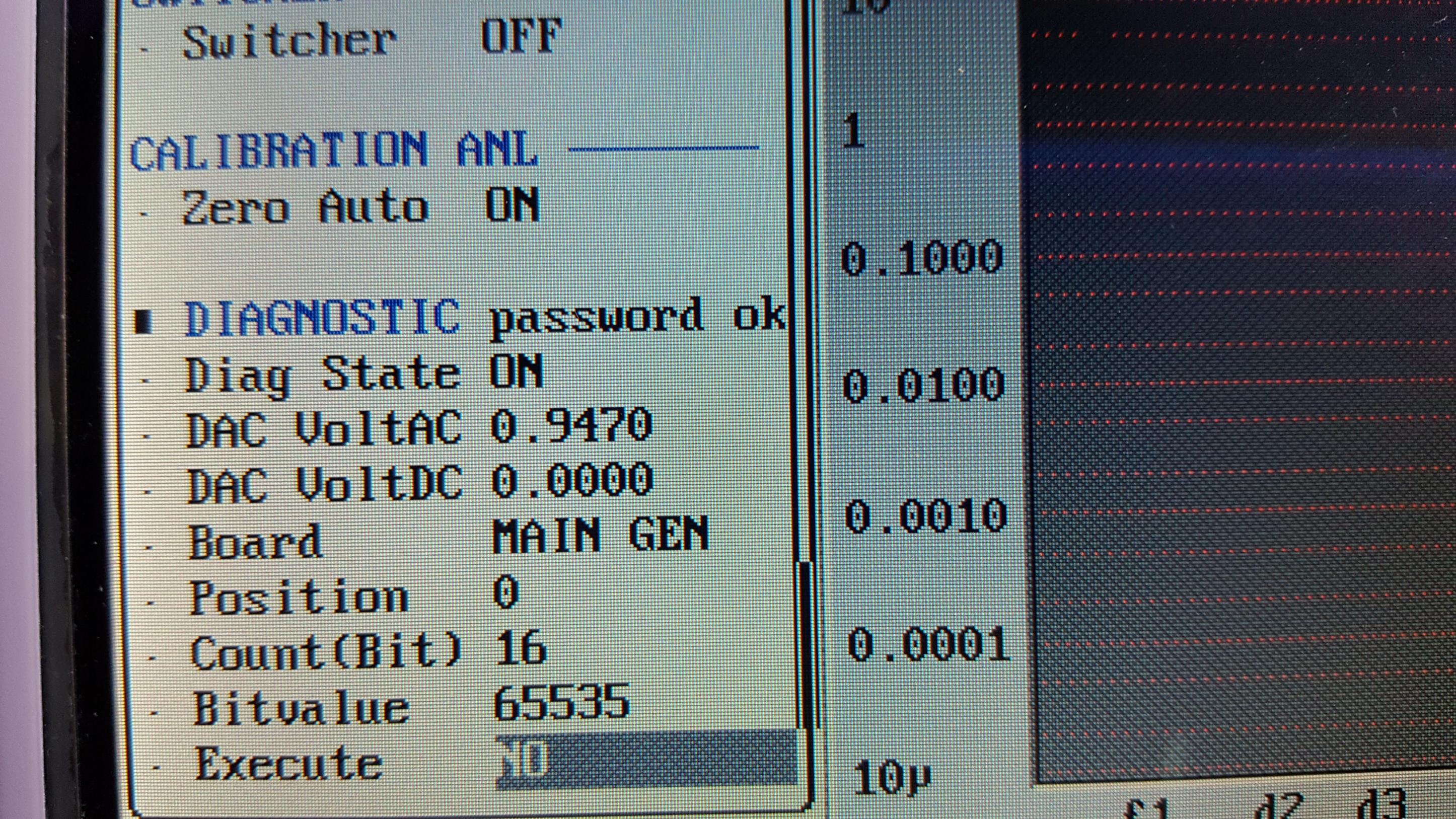

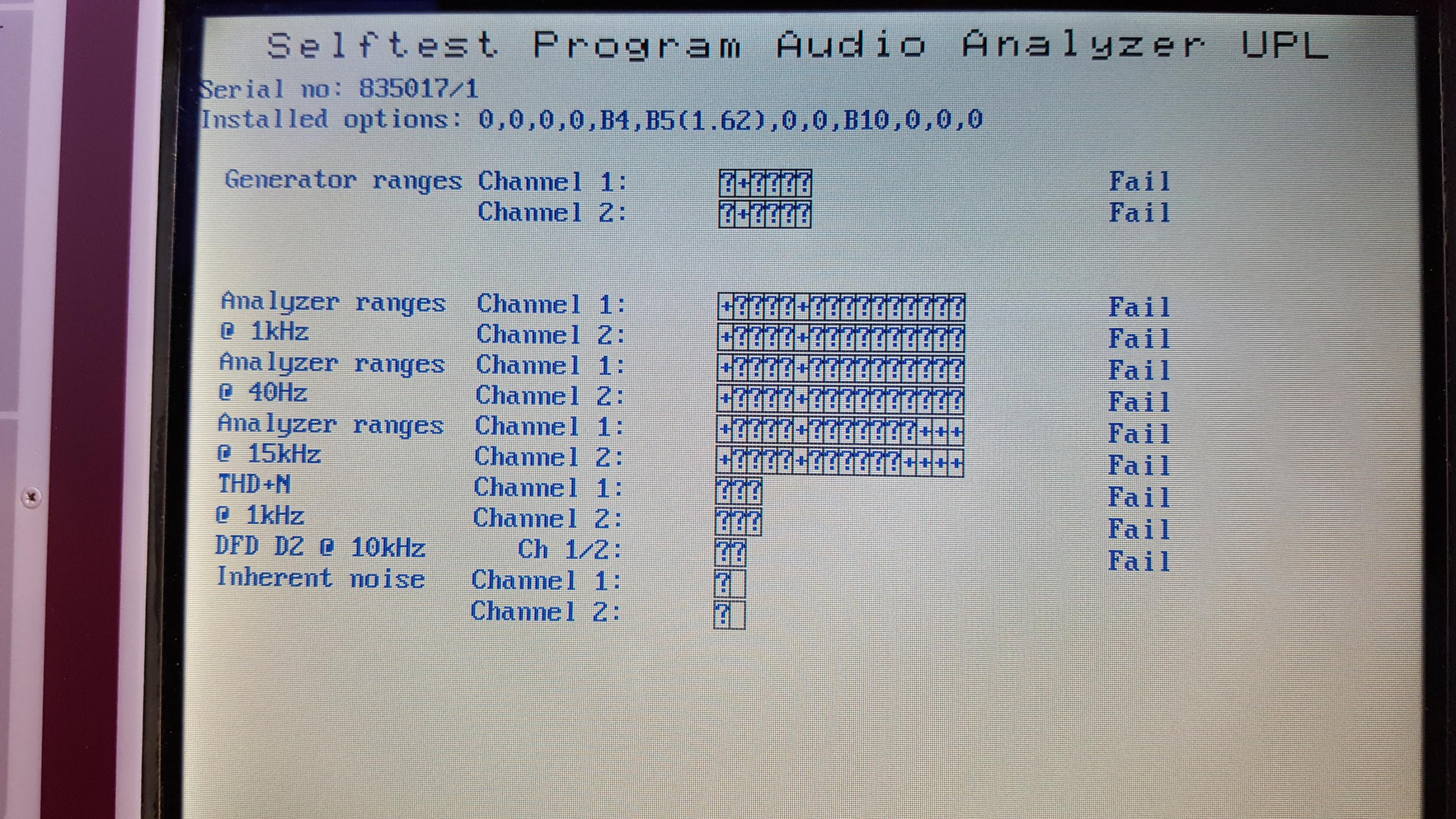

Here is what the diagnostic screen displays. I don't want to go any further because I think it will write stuff to the eeprom and lose the calibration Constants. But maybe we can compare these numbers with a working UPL.

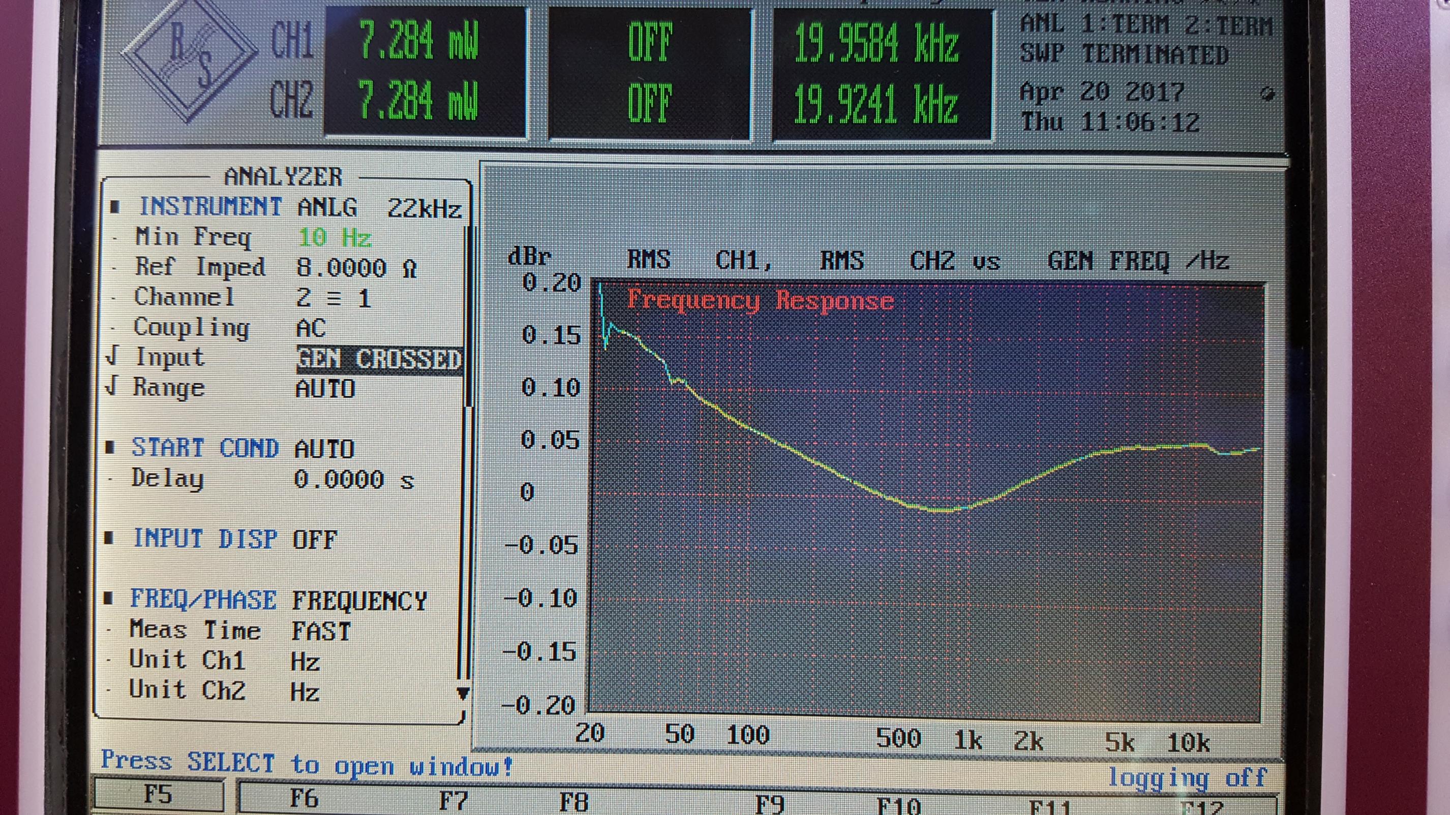

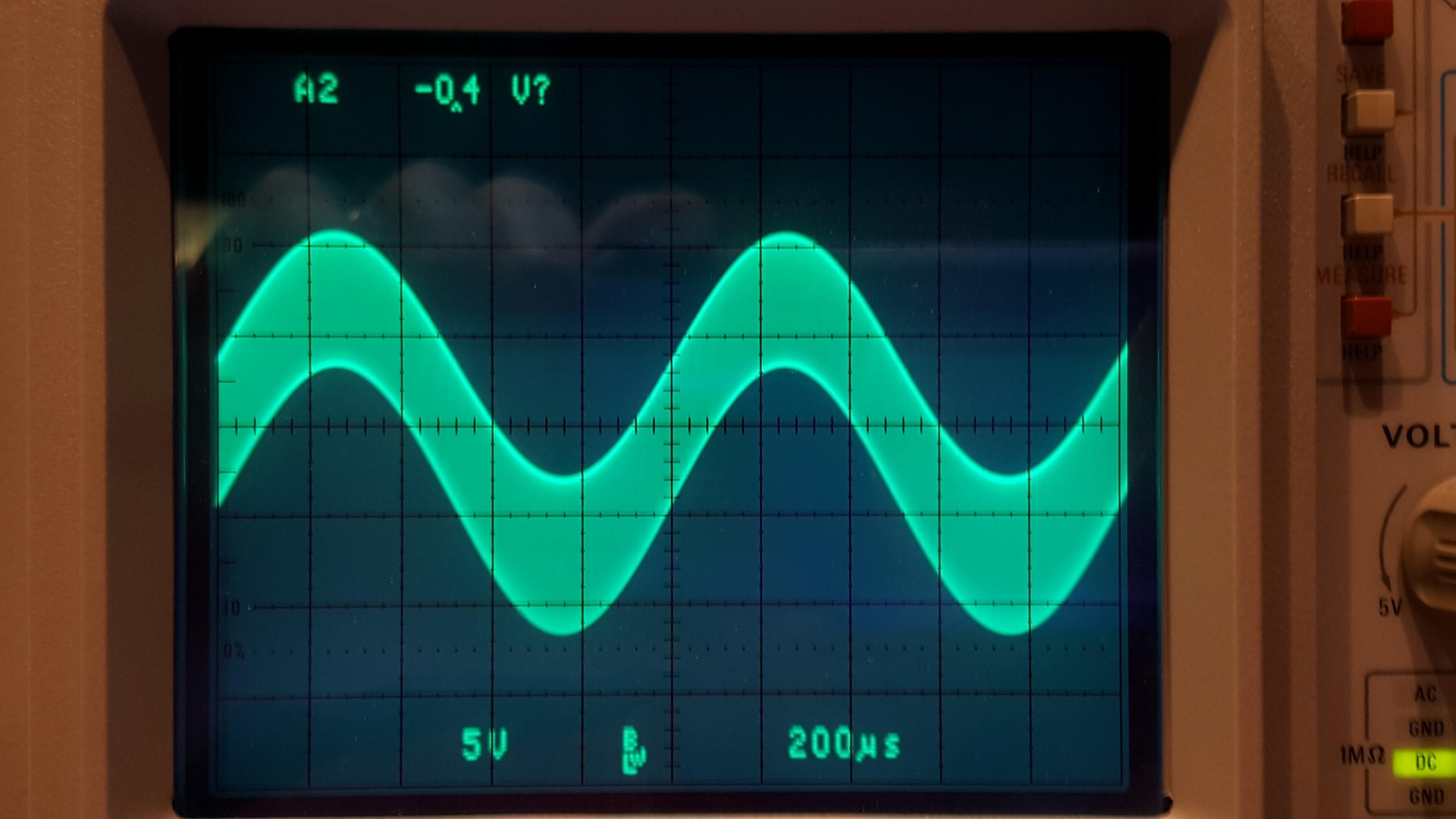

I was thinking of shorting those jumpers to ground just to trick that circuit and that was a good idea that did allow the generator output to turn on. However it appears that the oscillation from the bad op amp is mixing into both generator outputs because there is 348 kilohertz of RF riding on top of the audio waveform. Distortion is pretty high. So it looks like both channels of the generator are used even when only one channel is Switched on for the output. I tried setting up the analyzer for gen crossed mode and I am able to get harmonic Distortion readings so the analyzer does appear to be functional. At this point it appears that the damage is indeed confined to the generator output section and if I can fix it properly and get good enough quality components hopefully the Distortion performance will be on a par with what it was before the incident happened.

I'm a little lost here,where are you seeing the oscillation?
I can only say I doubt 99% that the op-amp is damaged - if its on the Generator output then there is damage to the Gen output stage somewhere NOT the Opamp. A blown driver or somesuch which has slowed down the output stage current buffer.
What is the designation of these current sense transistor?
I'm seeing the oscillation at the output of N82. Signal is clean up to that point. It's possible that some other component downstream is causing it. I will replace the transistors and see if the oscillation stops before replacing op-amp.
