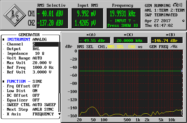

I'm curious to know what level of stereo separation crosstalk I should expect on the UPL? With external jumpers, I'm getting about 92dB of channel separation measured from 20-20,000Hz. I thought it would be more than that, frankly. Has anyone else tested the crosstalk on their UPL?

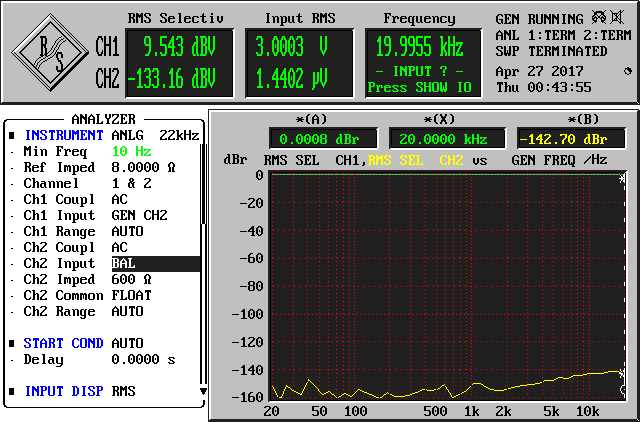

Please define exact test conditions: Bal or unbal, load impedance, gnd ref, "zero CH" open or shorted, analyzer settings etc. Explain or pictures from the screens.
Then I can do comparable measurements.

I think I found the problem. It was a problem with a custom setup that I used to measure the response of FM tuners and the separation crosstalk between channels. The range was set to manual and 3 volts period when I set it to auto the separation increased to about a hundred and 20 decibels are better. In this mode there is no option to ground or float the analyzer.
When I use the RMS select function I can get the crosstalk figures down to almost - 150 decibels. Then it gradually degrades as you get towards 20 kilohertz to about minus 115 decibels. So I think it was just an anomaly of the test setup.

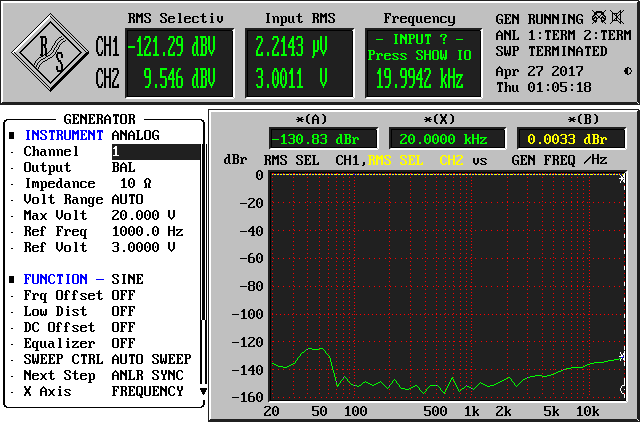

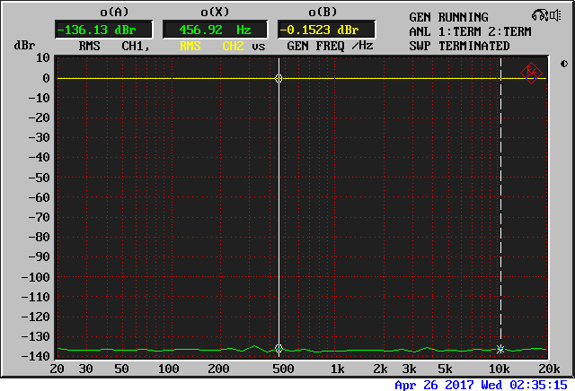

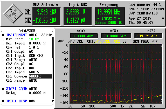

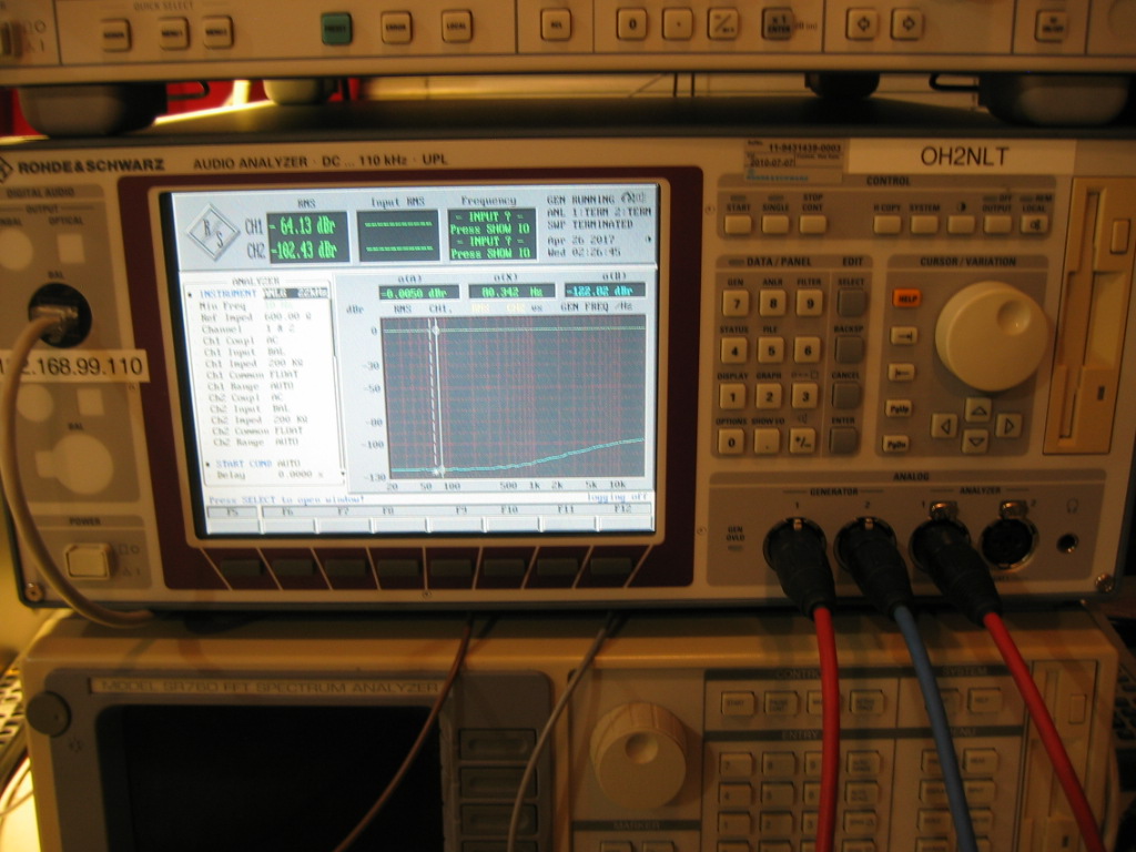

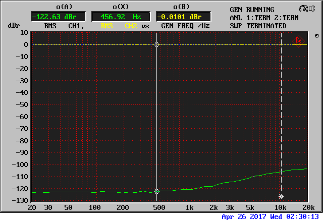

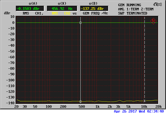

I made test with external loop back cables. Gen 10V, balanced in/out, AC.
Screen 1 and 2 are with 200k input impedance.
Screen 4 and 5 are with 600ohm input impedance.
In Z 200k test it did not matter if I disconected only one end or both ends of the loop back cable.

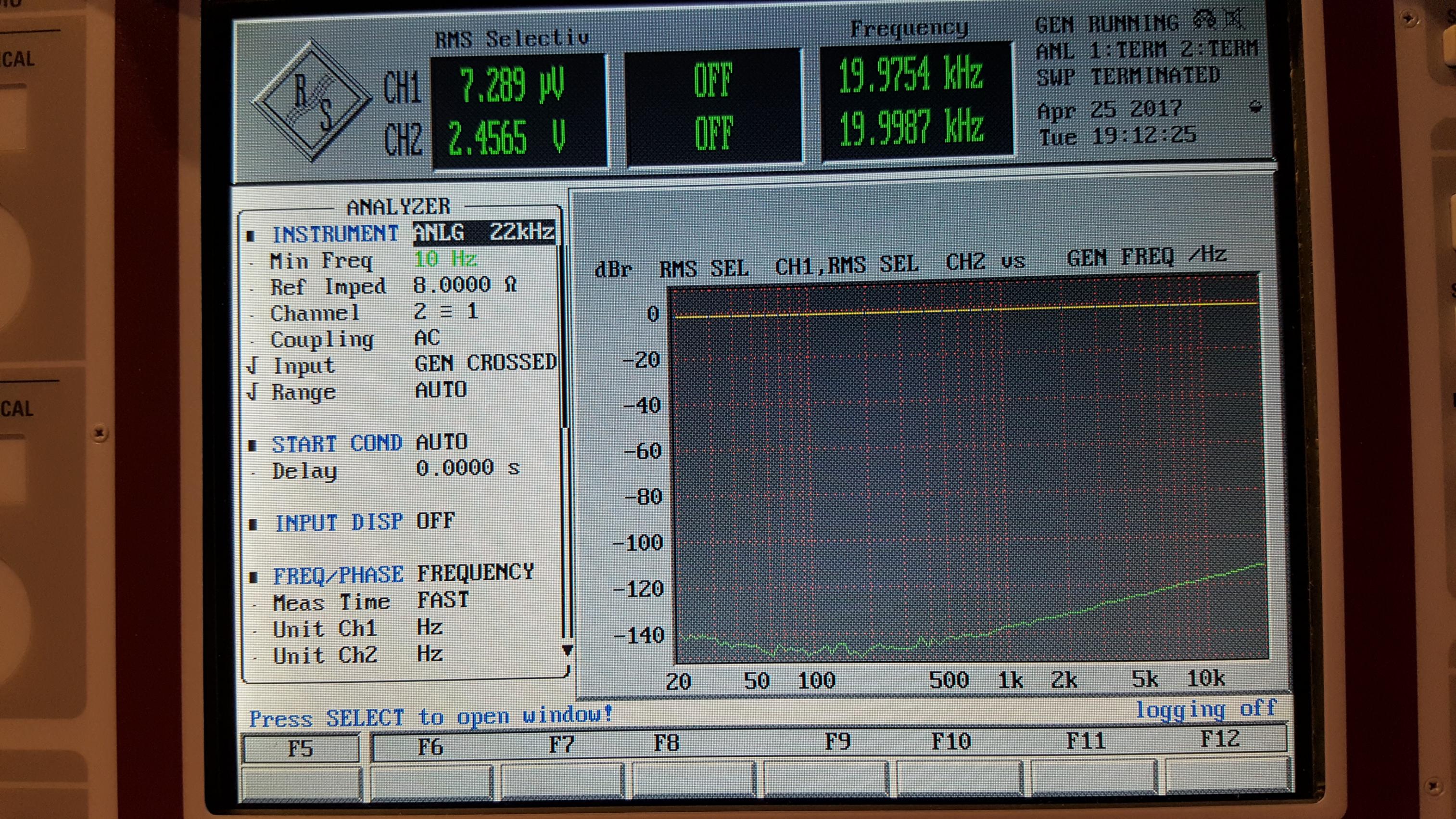

What happens if you set the analyzer to GEN CROSSED instead of BAL?
The first two traces look like my results.

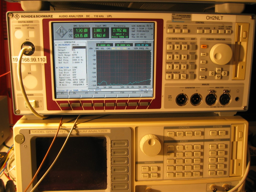

The reason why I'm suspicious of crosstalk is because I'm testing a receiver now with a problem in the left channel. At about the 1 watt level, there's an RF bubble on the waveform. I've found out, using a spectrum analyzer, that the RF is about 1.8MHz.
When this bubble appears, the distortion in the right channel readings bumps up by an order of magnitude. To make sure it wasn't crosstalk in the receiver, I disconnected the dummy load from the left channel of the UPL, and noticed that the right channel distortion readings decrease drastically. The difference goes from .2% to .01%. So the distortion from the left channel is affecting right channel readings. Perhaps this is because of the RF riding on the audio, but I don't remember seeing crosstalk like this in the UPL in the past.

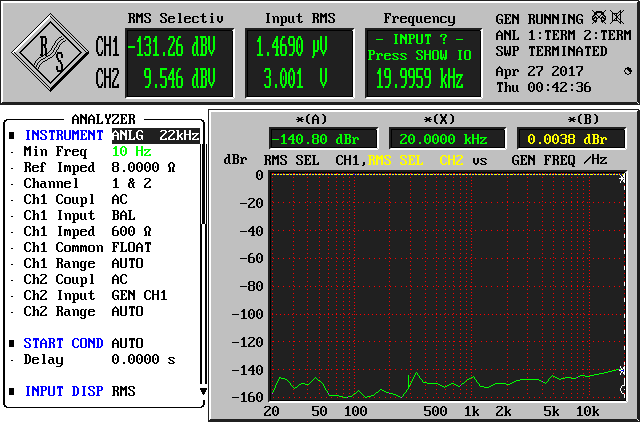

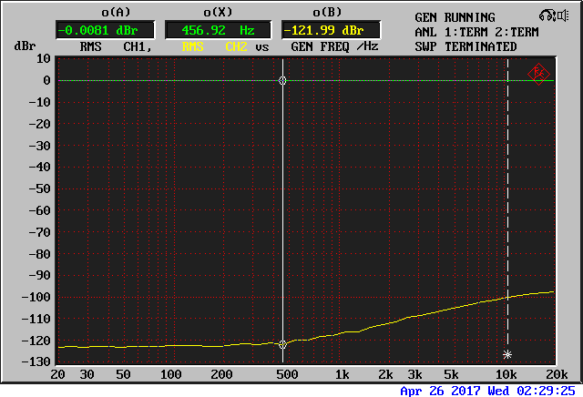

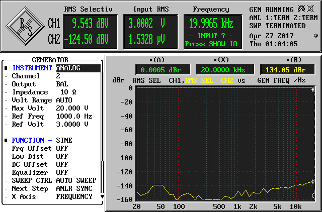

I just made some more tests. Screen 7 & 8 are one internaly connected to the gen and another floating. Screen 9 same + CH2 common to GND instead of float. Makes no real difference.
Plot 0 &1 are both analyzer chanels internaly connected to the gen but gen ch1 or ch2 enabled separately.

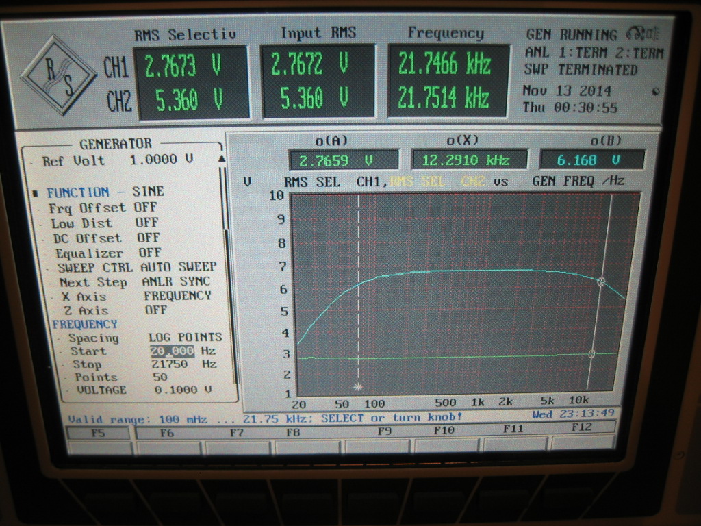

UPL crosstalk & responce
Reducing gen level to 10mV brings above 1kHz crostalk / noise down little bit.

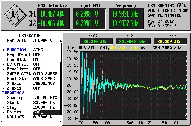

BTW how does your gen -> analyzer flatness look? Here is 500 point sample with gen set to 0.3V. Other setup like in earlier tests. Internal gen to analyzer connections.
If I take the RF out of the equation, crosstalk seems much better. I tested an amplifier with one channel being driven into and out of clipping, while observing the other channel on the UPL. The "control" channel remained at a constant distortion level, regardless of whether the other channel was clipping or not.
So it appears that the 1.8MHz RF bubble that was riding on the audio output provided a "carrier" which could cross into the other UPL channel. Absent this RF bubble, the distortion levels in the two channels behave completely independently.

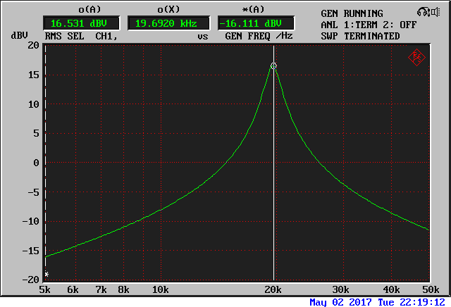

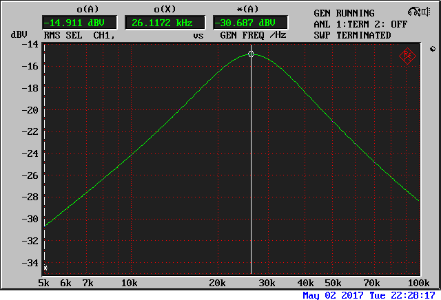

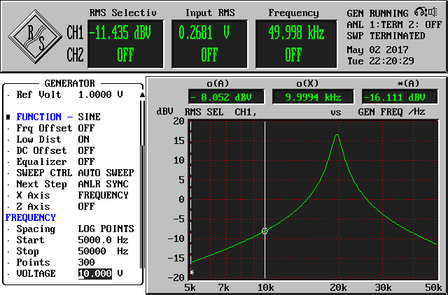

Here is what I finally ended up with:
From this DUT the 15kHz to 30kHz bandpass filter:
Then, if you go back to the first pic of this series you'll see it didn't
even work? That I can't figure out why not. It is what it is.
The input for the bandpass filter is about the middle right, attached to silver mica.
The output for the bandpass filter is the lower right, attached to the thumbwheel,
used as a rheostat.
The common/ground connection for input output is the lower middle, connected
to the 100K resistor and .001uf capacitor.
I'll post the screens settings I used to my blog, but they are
included in my picture library if interested.
They are supposed to look something like this:
15kHz, 100kOhms
High Pass Filter
30kHz, 0.001uF
Low Pass filter

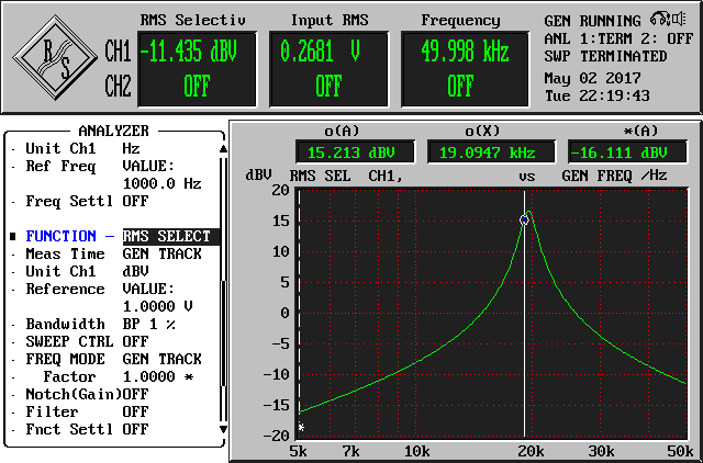

If you like to draw filter or amp responce use selective rms measurement. It is the same view what you would get with SA and tracking gen (this is it)
"UPL stop and calibrate itself" if you mean DC offset calibration you can control it from the settings if it happens or not during measurement.

I think that to test the response of a filter, you need to have the generator tracking the analyzer. The screen shot above shows an FFT analysis of some discreet signals, which don't really give much clue as to the filter response.
Sweeps above 21.75KHz would require the Low Distortion Generator option B1. Even the noise function of the standard generator cuts off before 22KHz.

@ Oh2, that is exactly what I would like to plot.
I'll try to configure it that way. I"ll try to use the
Selective RMS measurement, that must be code
for .707*Vpk.

UPL responce plot example
Here you have two examples of LC resonance circuit response plots. First is 4.7mH || 15nF fed via 10k resistor. Calculated resonance 18.955kHz, measured 19.6. Second example lower Q iron core about 940uH and 47nF cap. From the pictures you should get some hints how to set GEN and ANALYZER. You can freely set display scaling, units log or lin scale etc according to your needs.
Selective RMS is band pass filter set to track the generator frequency. Same as synchronously swept receiver. This setup is the same as earlier mentioned SA and tracking gen. Only difference is that generator is swept here and the receiver or detector tracks the generetor with certain bandwith. There are plenty of details involved and here. I can say that the well written operators is your best friend in this matter.
