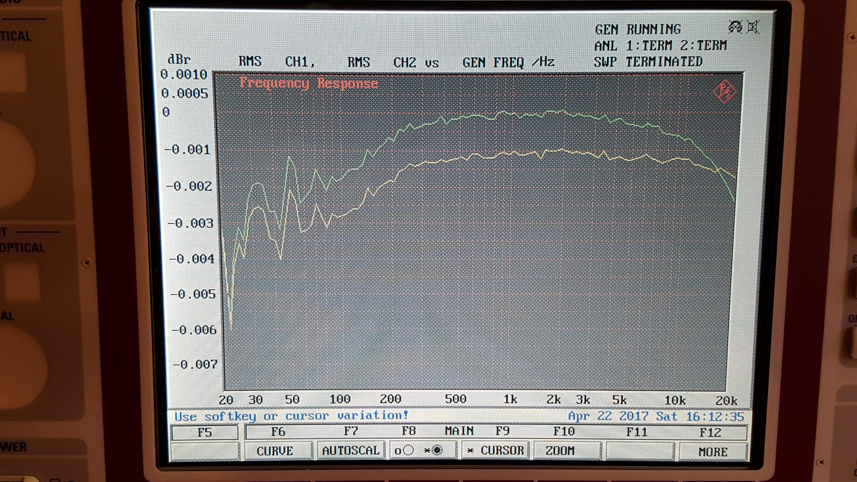

Response is far from flat.

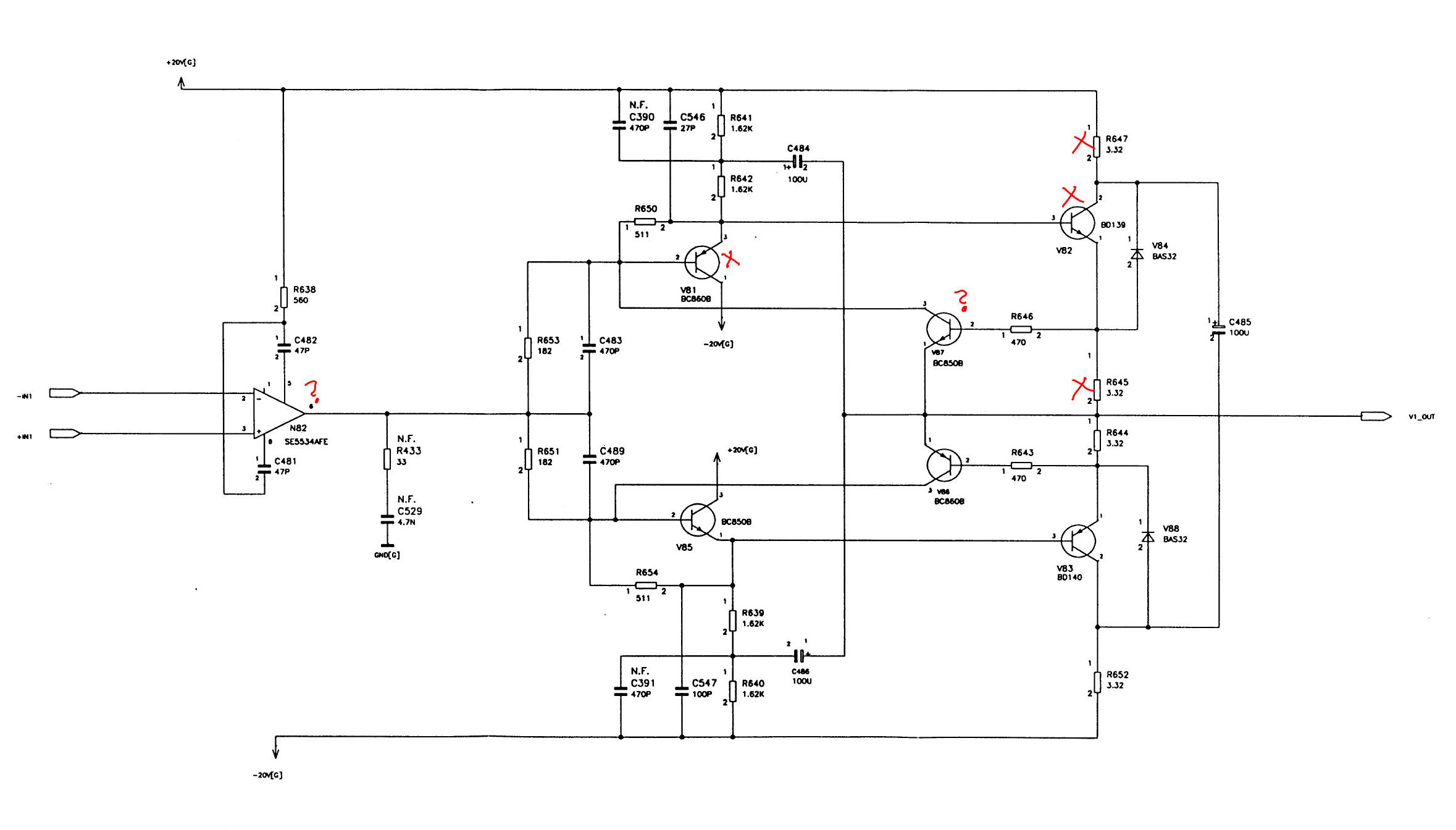

I cannot stress enough - you FIRST need to get the generator repaired first, I really fear you are going to cause more damage, EVERYTHING you have posted is symptoms of the blown Gen Output stage.
When the parts arrive from Farnell, replace:-
BD140 / BD139
BC850 / BC860 on the Output Devices Emitter Resistors
All the 3.32 Ohms resistors
Repair the damaged Generator Attenuation resistors - and then I strongly suspect from experience all will be good (as long as your PSU rails are OK)
Mark,
Is N82 the opamp driving the damaged output stage (I'm not sure which channel is damaged)? if so then for sure you will see oscillation as N82 feedback is taken from the output stage.
V84 and V87? (I cannot read the schematic) are the output current sense transistors
Yes, it drives V81 & V85, which drive V82 & V83. V84 (diode) and V87 form what appears to be a feedback loop in the positive half of the amplifier. I could imagine that this circuit would be unstable without the feedback, but unless the feedback continues to the input of the op-amp as well, I have doubts that it would cause the op-amp to oscillate like this. But when the parts come in and I have replaced all failed transistors and resistors, I'll see what happens.

Yes, we're making progress. I assume that the high distortion and poor frequency response flatness are due to the damaged generator, as is the case with the self test failing on many ranges.
The XL600 has power bandwidth to 500KHz, which makes it a good RF amplifier, and thus prone to instability. The designer attempted to mitigate the problem with that 5R PTC in the ground circuit. But the fatal flaw was grounding the jack shields to the chassis and not the power supply ground. I have encountered this problem in two Phase Linear D500's, whose jack shields became grounded after 39-40 years when the anodizing that isolated the jacks from heat sink ground, failed and the amplifier became a power oscillator when powered on. Isolating the jacks cured the problem. As soon as I saw grounded jack shields on the XL600, I knew what the problem was. 🙂

Here are the bad components that I've identified from channel 1 (see photo).

The interesting thing is that the two generator outputs appear to be independent but in actuality, seem not to be independent. The output at the attenuator input of Ch 2 is clean, but the output of Ch 2 at the XLR jack has the exact same RF-pollution as the output of Ch 1.
The Opamps feedback DOES include the current boosting OPS, its not operated open loop...
I believe your not seeing the whole schematic, if you look at page 92 of the PDF you can see V1_34541 & V2_34546 represent the concerned 5534 & current buffer OPS, where now you can clearly see the full feedback loop... 🙂 all will be good when your repair the damaged Gen Channel 🙂

With an event like this, check the Diodes across the output transistors E/C.

Sometimes you can bypass the output section with a quick jumper to see if open transistors are causing issues. Just jumper from the opamp output to its feedback resistor. make sure there are no shorted transistors although the opamp outputs are somewhat protected.

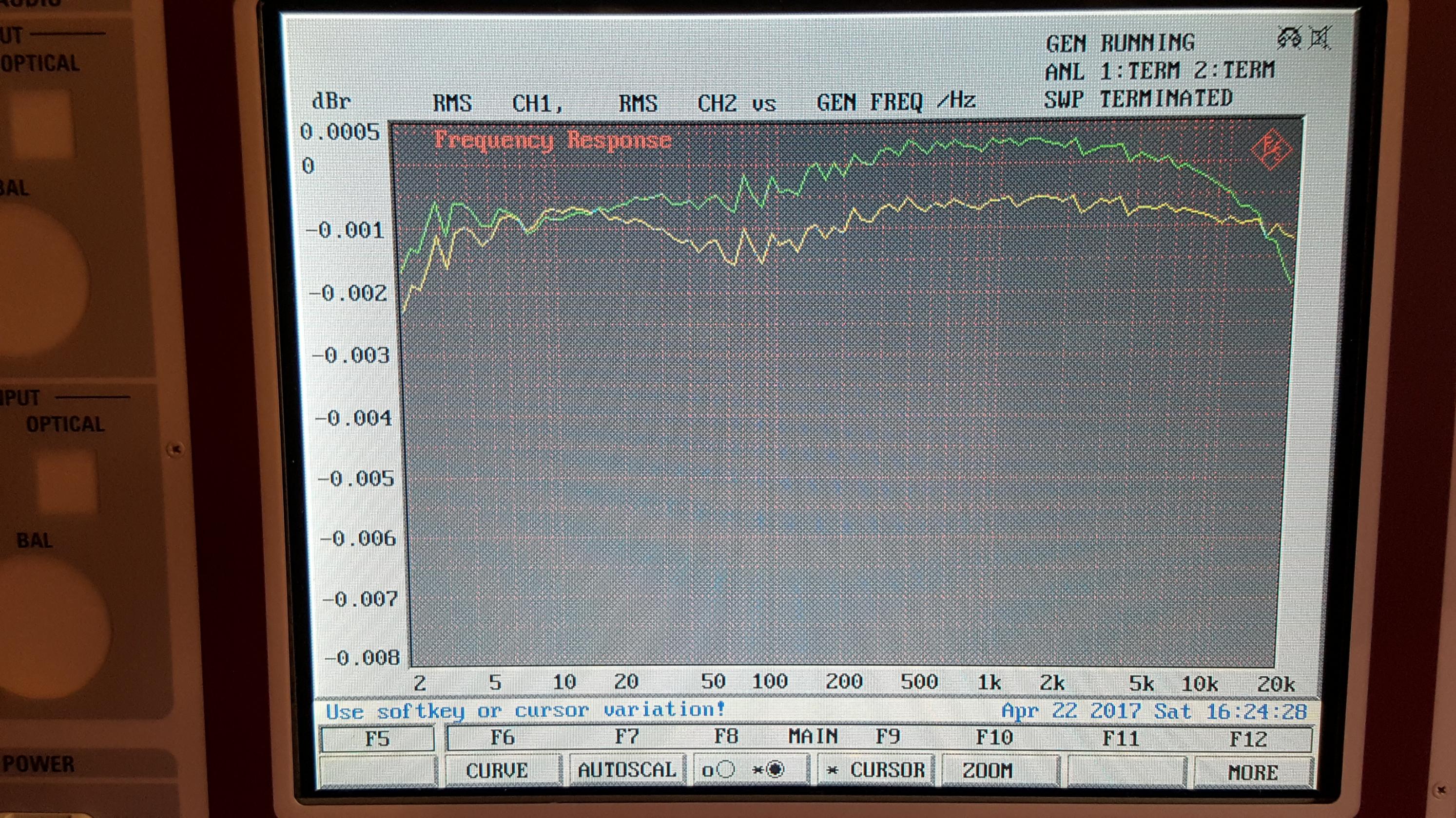

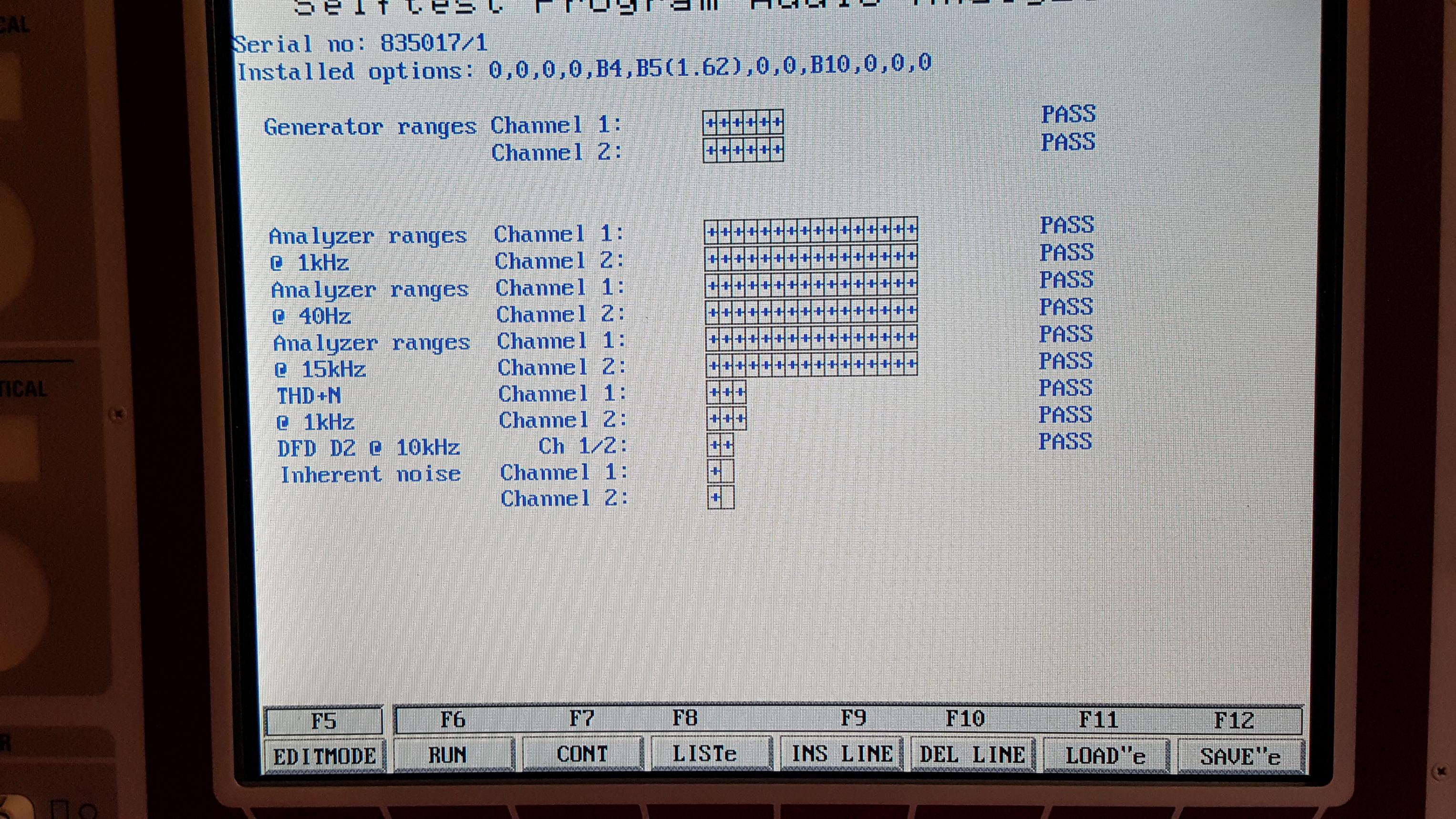

I finished rebuilding the output circuitry replacing resistors in the amplifier stage and in the attenuator. It passes self test!.
The only concern is his this frequency response to non flat? I don't remember it being quite this out of whack.

Those level variations are in the mud. The instrument is not really able to show that level of accuracy even if it has the resolution. You need a thermal converter to verify its flatness like one of these: Standard Voltage Thermal Converter, Low Voltage Thermal Converter, Improved Accuracy Thermal Converter . But its way beyond any performance limitations in the real world. I have a 600 Ohm converter if you really want to obsess. I believe you have better projects to pursue.

Frequency response looks fine, its in the 0.001dB range that impressive...

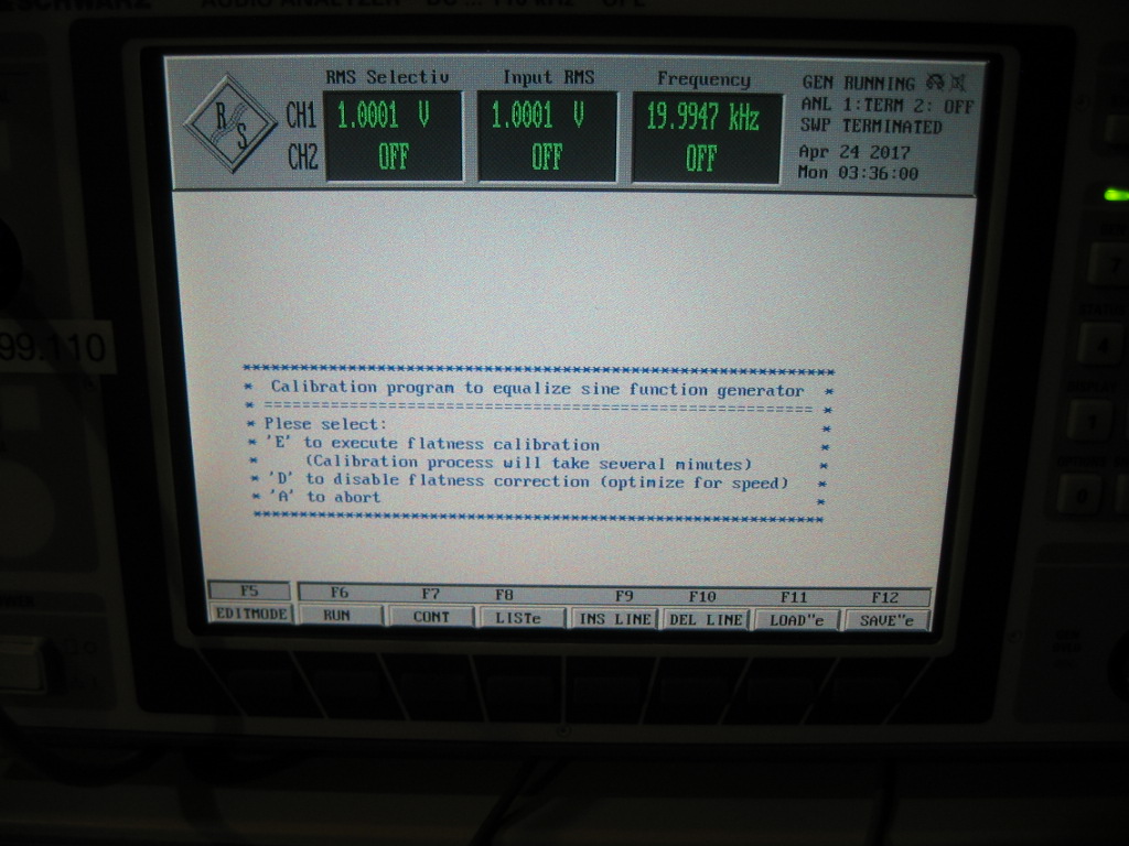

Have you done the user calibration described in the user manual:
2.6.9 Improving the Frequency Response
The analyzer of the UPL is generally equipped with a frequency response calibration for rms
measurements which compensates for the systematic frequency response errors of the internal
components. To activate the calibration it is required that the frequency measurement is switched on
with rms measurements or "Meas Time" set to GEN TRACK.
If – for measurements with built-in universal generator - the frequency response is to be further
improved, the remaining frequency response of the analyzer in conjunction with the generator frequency
response can be smoothed additionally by means of an instrument-specific equalization file.
To create this equalization file ("FLAT_GEN.CAL" under C:\UPL\REF), a BASIC program
FLAT_GEN.BAS is supplied on the "SETUP/EXAMPLES" disk and loaded into the directory
"C:\UPL\USER" with installation. It may be started as a macro, if the UPL-B10 option is installed. The
equalization file can also be created manually using the "FLAT_GEN.SAC" setup. .............

Yes, I ran that macro. The question is, is it persistent, or does it have to be run every startup?
UPL user cal
What I understand from the user manual is:
As long as you have FLAT_GEN.CAL file at C:\UPL\REF folder UPL uses it. In certain situations whwn you do not to want to use flatness cal you can rename, remove or disable the file with FLAT_GEN.BAS utility.
