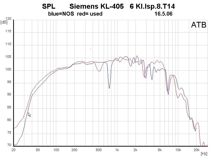

Here is a frequency response graph of a Klangfilm KL.L405 14" driver. Comments?

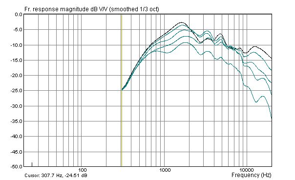

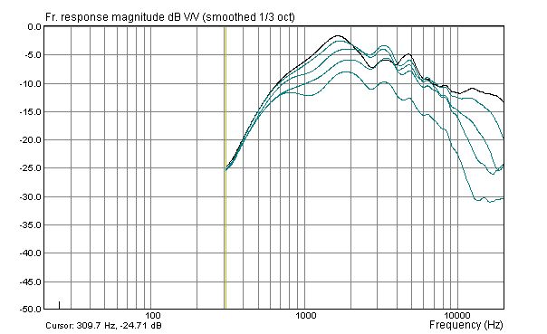

OK, so I did a first batch of measurements with the Vifa 27TG35-06, on flat baffle and horn, and when on the horn then with and without its OEM faceplate, and all this from 0 to 60 degrees off axis.
Test baffle ca. 5x5 ft, outdoors, windowed at the first reflection which was ca. 3 ms (floor, presumably).
Note that the outdoors was not a good idea - there is traffic, AC hum from the neighbors, and I spent ages to conclude what a strange wiggle in the 5k region might be. I thought windowing artefacts, or reflections from my primitive mic mounting "method" with a clamp (which never mattered before). In all likelihood it actually was some cicadas which didn't stop chirping for hours 🙄 ... next time tweeter tests shall be conducted indoors.
Test environment in pic.
As above, but tweeter mounted without faceplate (just pressed against baffle backside. I see no substantial difference, the response inversion 2-5k is still there (brown curve, as above, is 0 degrees, then down to 60 degrees in 15 degree steps)
A direct comparison of faceplate on / off. Surprising maybe that the 4-5 mm difference without the faceplate results in almost 1 dB loading loss in the loading region.
