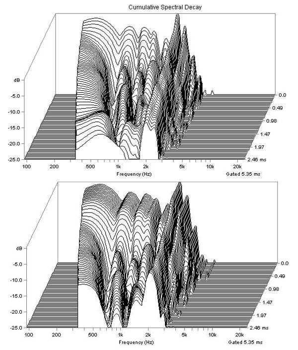

MBK, great CSD, and a nice concept about airiness to think about!
I'm not shure if I got right what the "shoulder" is, you are referring to but it looks interesting though.
From the pictures, to me it looks like the resonances that build up after 1 ms at 500 Hz and 1 kHz correspond to a DIP in the FR.
Am I correct in that? Can you tilt the CSD or do you have a sonogram to show this even better?
IF these resonances - appearing 1ms late - are an effect originating from the edges or of the back wave interferring with the front wave, shouldn't they change in frequency when placing the micro flush with the speaker and - lets say - 0,5-1m away, as they will have different path lengths than?

Here is my "best" in-baffle CSD for my two woofers, 6.5" on top, 15" bottom, baffle 40x24x7", no EQ, 10 ms gate, at 10 cm measurement distance, over a thick futon on the floor. Both clearly show the "shoulder" below 1k starting around 1 ms into the CSD.
As a MLSSA old-timer, here are some hints on getting a usable CSD (your data is unfortunately not usable in terms of saying anything about the drivers).
Start by looking carefully at the time domain. The data after the first reflection is useless - one reflection alone introduces severe combing in the straight frequency response as calculated by the FFT, and the "solutions" of a very short measurement window, or 1/3 octave filtering, reduces the utility to the data to little better than the hand-drawn Fostex curves. (Always be suspicious of FR curves with fat lines - that's not how they come out of any instrument I've seen - either pen recorder or computer data.)
The shortest time window that's of much use is 6 mSec, with 8 or more preferable. The floor reflection, unfortunately, comes in around 3.5 mSec, spoiling the data. I found I had to build a pile of pillows and assorted household furnishing (couch cushions, winter clothing, duvets, etc.) about 2 feet high and 3 feet deep in order to attenuate the floor reflection by 20 dB or more. You'll see the floor reflection go down in magnitude as you keep building the pile.
If you're the curious sort, it's interesting to examine the FFT of the floor reflection by itself (by gating out the direct sound). I found that for typical wall-to-wall carpeting, the floor reflection was full-strength up to 8 kHz, where it finally started to decline in magnitude. So much for carpeting being a good wideband absorber.
Once you deal with the floor reflection, unless your living room is really huge, you'll see the ceiling or side wall reflection come in around 6~8 mSec or so. The benefit of measuring outdoors is you only have to contend with the ground reflection, which can be removed by the usual 2-foot pile of soft materials.
Once you've dealt with the floor or ground reflection, your gating interval should be set by the next reflection that arrives - be sure to exclude that reflection. The longer the uncontaminated time interval, the better the frequency resolution will be (in direct proportion) and the CSD's will "clean up" and be more usable.
For dipole, the rear wave diffracting around the baffle contaminates the measurement. Your ear and the FFT do not hear in the same way: your ear is a cross-correlator, with excellent memory of preceding (and anticipated) sounds, and can easily discriminate things that are just clutter and noise to the FFT and CSD. The FFT system has no memory, and does not build up a long-time store of the acoustic characteristics of the local environment, while your ear does all the time with no effort on your part.
In fact, if this complex and ever-shifting acoustic environment disappeared, even while you slept, you would notice immediately and go into a threat-assessment mode. You would not be relaxed, but very alert and wary. This is part of your endowment as a mammal and a human being, and cannot be turned off. But the FTT has no acoustic memory and knows nothing about its acoustic environment.
So you have to cater to its deficiencies, which is an inability to separate out different sources of sound. The diffraction coming around the edge of the baffle is just as disruptive to the FFT as the floor reflection, and will make the CSD fill with artifacts, making it unreadable.
The only solution here is a BIG baffle, made from scrap wood. Vibration isn't that important for the fairly quiet measurements you'll be making. Although I recommend scrap wood, it is still very desirable to inset the driver so the front frame is exactly flush with the face of the baffle. Small mounting errors of 1 or 2 mm can severely degrade the measurements for a tweeter, for example.
I've never tried anything as audacious as cardboard for making OB measurements - I suspect it is acoustically transparent enough to spoil the measurements. Then again, if it comes down to a too-small baffle vs a baffle extended with several feet of cardboard, yes, I'd use the cardboard. Even a bad baffle is better than no baffle.
Hope this helps. First you need clean time data, with an obvious ring-down and decay before any reflections arrive. The FFT and CSD must be derived from this "clean" time window, not contaminated with reflections.

completely agree with your assessment. While I did take care to window out reflections bar the floor, and dampened the floor by measuring above a futon bed (i.e. futon 1 ft above the floor and speaker above that, quite "good enough" to get halfways decent simple FR without dramatic florr induced peaks), it is in my opinion the OB rear wave that contaminates it and makes it unusable.
One strange thing that I could not explain is that shifting the time domain window by just a few FFT samples (that is, tens of micorseconds) could change the CSD's look completely. I think there is also a lot of windowing artefacts in there, I suppose the fix for that is ... more experience in measuring.
Michael: yes, both dips and peaks in the FR are an expression of energy storage and both will show in the CSD. In a perfect world, a perfect EQ of peaks and dips should perfectly get rid of this 🙄
Can you show an example of that by making a screenshot of different windows in use?
Having different drivers in an OB that perform comparable under comparable measuring conditions might tell us something about the measuring technique (as Lynn outlined ) AND may also direct our attention to one thing ore two that can be learned about OB behaviour.
Therefor I was curious about the resonance that seemed to start with delay corresponding to a dip in the FR (which would be quite unusual) and asked for a slight variation in measuring setup for comparison.

Here we go, variations I did one day before, with a shorter gate and less attention to eliminating room effects.
Top and bottom are from the *identical* pulse measurement, gating length and FFT resolution are also identical. In the top graph the gating starts something like 2 FFT samples before the impulse visibly starts. In the bottom graph it starts 2 or 4 more samples (can't remember) earlier than in the top. Very small difference, hardly visible to the eye on the screen looking at the impulse resonse. Note that when I started the window precisely at the "knee" of the impule in the time domain, the FR was off - the windowing of the CSD probably adds on top of the windowing of the main impule response.
The resonance that starts with a delay at a dip, in my view is nothing but the rear wave signature. Since the FR in the CSD even at t0 already contains in this case 5 ms, it also contains part of the rear wave... just not its full decay.
No need to worry about that.
As far as I can see these two CSD's look exactly the same if you omit the first 10 slices ( T = 0 - 0.6 ms ) or so from the lower diagram (showing all the same FR) and also cut away the last 10 slices ( T = 1.86 - 2.46ms ) or so from the upper diagram.
In this example it seems that you shifted the window in the time domain by around 0.6ms and left the overall window length unchanged.
Nothing wrong here exept that you might have cut away the FR in the upper diagram by one or two slices.
Greetings
Michael
Well, the problem I see is that the cutoff is subjective: if I start too late, I get a good looking decay, if I start too early, I get a bad looking decay. Comparing the two in this example clearly shows that one did indeed start too early, and so the software produced a spurious initial plateau, and then an essentially identical decay to the second measurement.
But, unless I produce a whole series of CSD's I have no way to find out whether I chose the window correctly. Worse, even with several trials I am basically left with subjectively picking the one that looks best to me... After all, the first slices of slow or no decay could possibly be real.
The frequency dependence of the result is not making it easier. Say, I could be choosing a window where the HF had enough samples to produce a correct initial FR from which to decay. The LF however could be just short of it, with subtly altered FR and wrong decay.
To me it looks like the LF with its slow decay is likely due to artefacts, mainly, not enough samples and time slice windows cutting into what samples there are. In all my CSD's, and Paul's as well, the LF shows a broadly increasing decay time with decreasing f. A woofer should have it much easier to stop at LF than at HF. And, the problem of interpretation: I see the point now why some software expresses the decay in cycles for each f, rather than time - it makes whole lot more sense.
No, within its limitations they look exactly the same!
At least your software should have parameters to be set for the time interval of each slice and also the total number of slices.
Chose a larger T (z - axes) to plot the whole decay. You should not be limited to the 2.46 ms of your example.
Shure, if you measure only for a very short time you never can tell anything about low frequencies
Miss that too. Maybe we will have this switchable some time ?

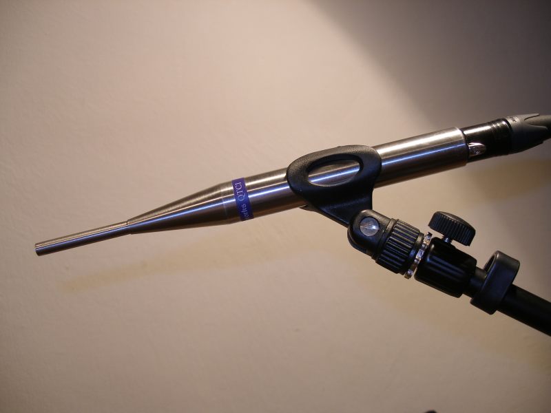

equippment
Hi
At US$230 from E-Speakers, SoundEasy V13.0, combined with the M-Audio 192/24 PCI card, is starting to look good as a MLSSA replacement. I've already got the M-Audio card mounted in my HTPC-format PC, now it's time to order the software and learn to use it.
For a good mic you might also have a closer look at the Earthworks page.
http://www.earthworksaudio.com/3.html
"http://www.earthworksaudio.com/3.html"
I own, use and love the M 30BX (battery powered) and the QTC 1 (around 45 kHz / –3dB) type.
Both are reliable and great performers not necessarily for measurement only.
