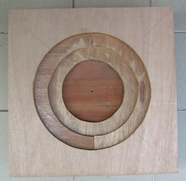

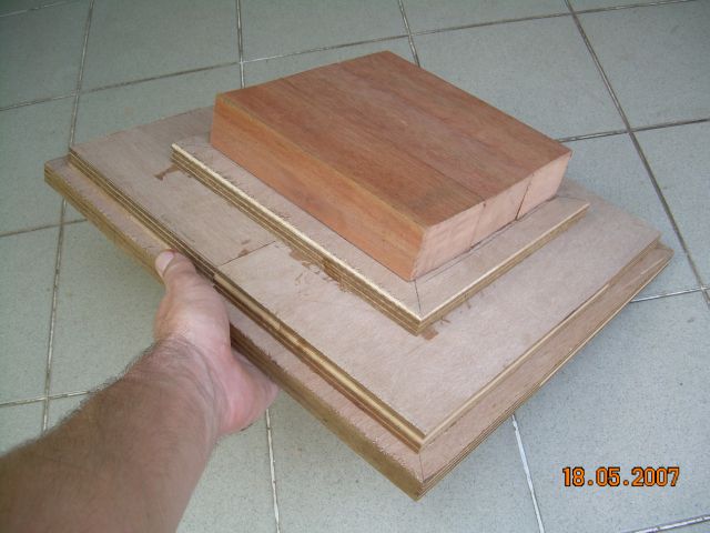

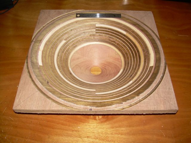

Raw first horn prototype
Let's call it model 1.4-120- 21n15 v0.1
(1.4" throat, 120 degree coverage, 21" nominal mouth, 15" actual diameter, at the stage of raw glued plywood and lumber prepared for milling).
The cutouts are to cut down on CNC time - the CNC works in extemely fine increments and projected first time estimate for cutting out the horn from a solid block of wood was 17h. For this prototype there are a lot of shortcuts - marine plywood for the mouth sections, and we'll find out if it really is void free later 🙄 , solid 2" thick local construction lumber (a type of mahagony I believe) for the mouth. Rear will not be milled for the prototype, and it's going to be with the roundover only carried out to 90 degrees, to fit a flat baffle cutout, (as in the drawing in previous posts) so it is going to be 15" in actual diameter. If I added the full roundover for a standalone decorative horn it would be 21". But first things first, I first want to know how the off axis response behaves.

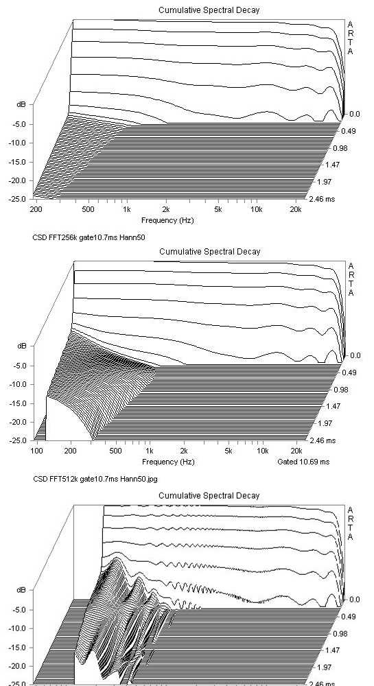

CSD gating artefacts
In my quest for a CSD protocol that minimizes artefacts and whose resultsI can believe, and while still building a larger test baffle, I had a look at pure gating and computation artefacts. Here I show results from one and the same impulse measurement using various gating and FFT lenghts. So far so good, but to make it DUT-independent I just used a loopback measurement of my soundblaster 24bit soundcard, assuming that the electronics should have negligible decay time wrt speakers.
Using the same impulse data and if gating, always using a 512k gate corresponding to 10.667 ms, the other variables were:
- window: Uniform or 50% Hann
- FFT length of the CSD: 256, 512 or 1024 (the largest possible allowed for 512k gates impulse data).

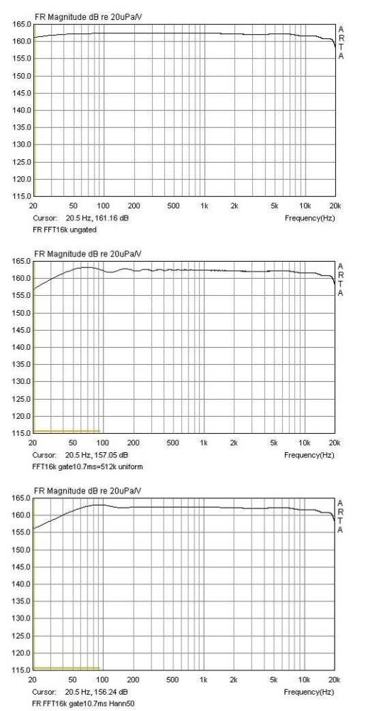

Here are the results for pure FR obtained with various gating methods. One can clearly see the leakage (as far as I understand how FFT combines with gating) that wrecks the FR if a short gate is used with a uniform window. The FR with 50% Hann window is much closer to the ungated one. Even then though a bump around 100 Hz appears.

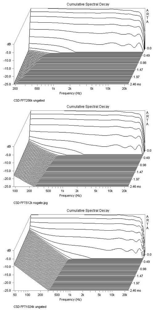

Now for a CSD from ungated data. All is fine except that when increasing the resolution from 256 to 512 and 1024k a monotonic LF tail appears. I somehow already suspected this to happen given the family resemblance of all our LF data with tails, in a frequency region where woofers should have no major problems to control themselves 😀

Now for the shocker, the grand finale. A typical 10 ms-ish gate, combined with increasing FFT resolution (256, 512, 1024). All other parameters in the CSD were left at Arta's default, which is 60 slices at 2 samples shift, with 0.2 ms window rise times.
Clearly, we see those familiar ripples, waves, ridges and canyons in the LF regions appear, as high up as 500 Hz, pretending to show severe energy storage / resonance / ripples.
The only really clean graph is the 256 FFT, half as many samples as data in the gated length. WHile Arta will allow you to set the CSD's FFT resolution to up to 2x the gated sample length, using this allowance clearly is not advised.
Conclusion, if gating is used, use appropriate windows for FR, and be very conservative with your CSD FFT length. The more samples the merrier. At the very least use FFT samples <= gate samples.
And, don't believe the low end decay tail.
Hi
MBL, revealing pictures!
Even better leakage and FR behaviour would be obtained with other windows like described here.
http://www.lds-group.com/docs/site_documents/AN014 Understanding FFT Windows.pdf
" http://www.lds-group.com/docs/site_documents/AN014 Understanding FFT Windows.pdf "
Unfortunately ARTA is not providing such a wide variety for gating.
With the "AudioTester" software the "Rife and Vincent" window is my personal favourite for FR measurement, giving great leakage suppression. Unfortunately CSD does not work really good in AudioTester.

Hi Michael,
thanks for the link, yes, windowing is tricky... but other things as well! Today I was trying to reproduce the effects I measured yesterday, but I only got clean CSD's from the loopback measurement. Further probing and retracing my steps revealed that it's more vicious than assumed, but it's not the windowing alone that's to blame.
Yesterday I made an initial measurement where the FR was oddly shaped. I had forgotten to switch off the Soundblaster card's EQ. So I turned it off and the FR became flat, as it should. I then made many trials, before I recorded the graphs I showed, and they all showed variations of these artefacts. Then I turned the PC off, leaving the EQ off. Today I turned it on with the EQ already off - and could not replicate any artefacts.
Sooo.... turns out that the Soundblaster EQ somehow stayed in residence even when off, *if* the PC was started with the EQ *on* - but not if started with the EQ *off*. I conclude that the CSD tails in the LF were due to a resampling / delay related to the soundcard software. Which neatly translates into yet another possible error mechanism 🙄 Not to mention it shows graphically how badly the resampling or whatever it is, is really capable of affecting the sound.
Still, gating and windowing are just as tricky issues, I'll have to explore that further.

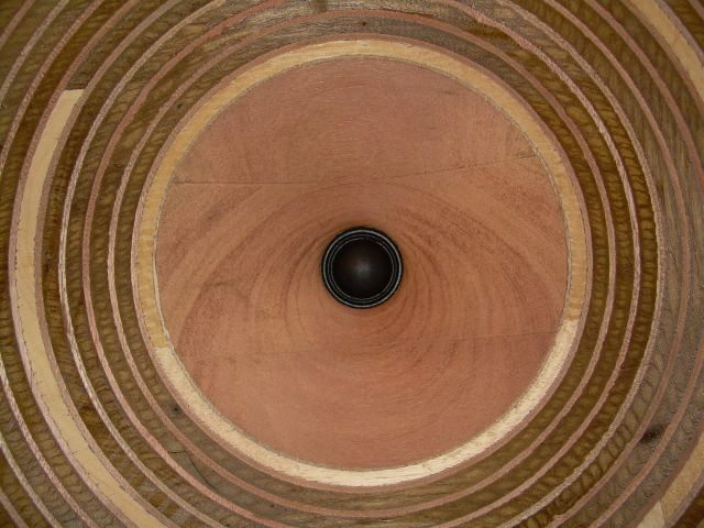

The throat area is solid wood to make sure it is smooth and without gaps or cracks. The driver put for demo her in the picture is a Vifa D27TG-35-06 which I will use to test polar response and FR for the time being. Although an 1" dome nominally, the actual face plate opening is almost precisely 1.4" (a bit larger in fact).
Waveguides are looking good! I used that same Vifa tweeter for some early tests in the MSC WG with good results. Some of the newer soft domes did not do as well as the old Vifa...my guess is the newer design domes were deforming when playing into a restricted space. You'll often see a narrow response "notch" in the 10-15k range with soft domes in a WG, but I'm guessing/hoping you won't have a problem with the Vifa in a fast-opening flare.
Thanks... I am varnishing the prototype now, to get rid of end grain roughness of the plywood and for protection in this climate here.
I had the Vifa in surplus, and Zaph also had his better results with soft domes I believe. I'll also compare with vs. without faceplate because in a WG the faceplate does not really serve a purpose anymore and the fit is actually better without. I have Seas 27TBFCG as well to try out (in my mains) though these didn't fare so well in tests by others IIRC, and taking off the faceplate would also rob it of the phase shield (which is actually just a clear plastic sticker inside the metal grid).
Anyway, that's some material for testing already. Will have to wait for next week though, no time the next few days.
