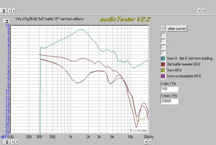

Now for some data processing for better visualisation of net horn effects. All curves obtained by substracting from each other, the dB scale is therefore relative here and correct.
Top curve, petrol: net horn loading (substract flatt baffle on-axis response from horn loaded response to get rid off FR rolloff and wiggles).
Brown curve, second from top: the difference between the tweeter at 60 degrees and at 0 degrees, on a flat baffle. Nothing unusual here.
Bottom two curves: with and w/o faceplate, horn mounted tweeter, difference between 60 degrees and 0 degrees. This shows the net *directivity* effect (as opposed to the net *loading* effect above).
Comments:
On the bright side, loading achieves ca. 9 dB around a peak at 1.6k and still manages about 6 dB at 800 Hz in spite of the just 100 mm deep horn. Also, directivity is maintained well down to 900 Hz (-5 dB at 60 degrees) with -7 dB / 60 at 1.6K maximum.
The directivity at 60 degrees is however a bit lumpy. WHile the expanded dB scale in this picture exacerbates this, I also suspect that the dome tweeter simply really is not cut for horn / WG use. Judging from the loading differential in faceplate / no faceplate compariosn, a ca. 1 cm high dome stiching into the throat area probably does not provide the called for waveform at the throat. Compression drivers assure this via their sophisticated phaseplugs.
So conclusion, this size horn best until 1k, and likely useable down to 800 Hz; detailed investigation of off axis behaviour should be done with a compression driver.

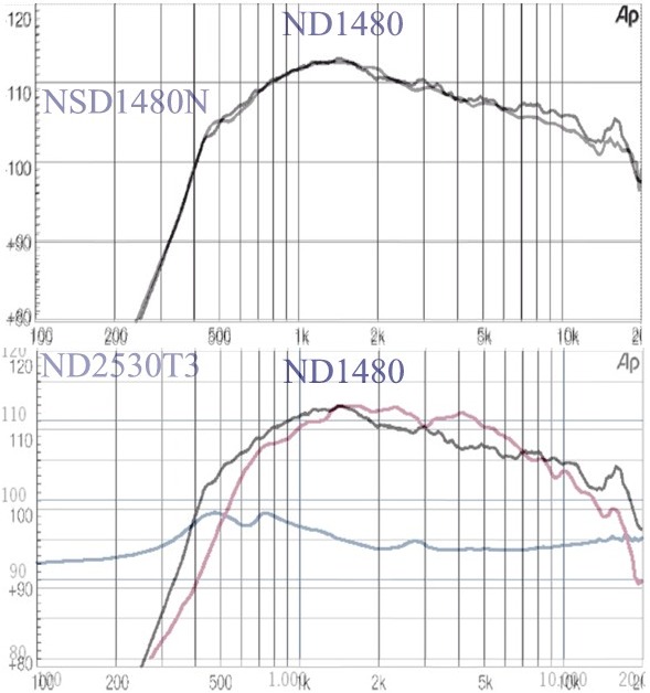

Isn't that purported titanium problem maybe just an issue of metal dome brakup modes, which the typical pro XO ignores and the typical passive home XO isn't capable of tackling? Metal cone midranges also had / still have a "reputation" but with proper EQ nowadays there's less and less comments of the "metal sound" kind of stereotype.
When I look at typical titanium drivers' FRs I see a shelf developing past 10-13k (for a 1.4" exit, 3" VC), with abrupt breakoff at say 16k or so. The shelf makes the response look flatter, more HF extended. In fact I think it's a breakup peak that masks the natural rolloff the driver would have. This is why I found the RCF2530's curve interesting, because it looks like what you'd expect in a natural bandbpass behaviour, *without* the breakup-induced shelf, hence it looks like it droops earlier at HF. My point being, Precisely that it droops makes me think it has less breakup issues.
If you look at 18Sound's untreated vs treated (polyimide film) titanium drivers, the former have clear breakup peak, the latter have this peak broken up and subdivided into a larger, but flatter, region of breakup. But in the RCF2530T3 I don't see any breakup at all.
Just half-witted guesses...
Joined 2003
The straight answer...I don't know. The discussions I saw (AA and DIY-A) were not "metal" vs plastic, but titanium vs aluminum vs plastic. Titanium, and sometimes more specifically titanium surrounds, were cited as the bad guy...not "metal". There is at least one patent that mentions aluminum as better "internally-damped" than titanium. I'll try to find it if you want, but dome material wasn't the point of the patent.
That is entirely possible. Maybe the smaller 2.5" dome is a "sweet spot" just below the breakup of the 3" domes. Is there enough info out there to compare moving mass or dome thickness?
I looked up the 2530 on one US site ($249) and they highlight "smooth, warm, highs".
What I usually do is I take the mf's FR graphs, resize them and overlay them to exact scale. Oftentimes I get surprises because the varying scales ppl use can make for the wrong impression. For instance here below is what I mean wrt breakups:
- top, NSD1480N overlaid on ND1480 taken as "standard titanium". Clearly visible is that the NSD's coating dampens a garbled breakup (thanks, 1/3 oct averaging!) at 7-12k, and a peak at 16k, and makes them more benign.
- bottom, ND2530T3 over said ND1480: no rise between 7-12k in the first place, and only a hint of a peak at 16k. Past 16k, identical curve save for sensitivity. Also interestingly, past 5-6k the ND2530T3 rolloff is almost perfect 6dB/oct. I would have said voice coil inductance, but the ND2530T3 has a copper ring. What gives...
All graphs vertically adjusted for same max SPL because this likely depends on horn type. All graphs were on 80x60 horns but RCF's horns are these squarish, brutish things and it looks like the 3k dip matched with an impedance irregularity, as well as the lesser low end loading of the ND2530T3, are a result of a different horn. On the same horn I'd expect it to have a broad loading maximum around exactly 3k where now we find that dip.
