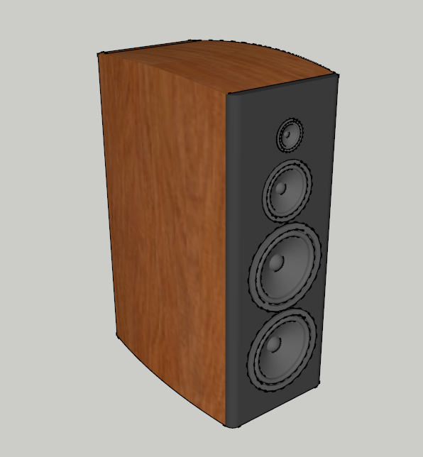

Why do you moved to a flat panel in the back ?
Waiting for the Sketch-up art ...

I changed it to the flat back panel to (slightly) simplify construction. Having a flat edge (top, bottom) meet the curved panel at the back would make things needlessly complex. Flat front baffle gets braced to the flat rear panel creating a sort of I-beam which should be very strong structurally.

I did consider using foam insulation board but thought the pour in foam will be more effective as it will bond to both skins as it expands in place and save time on shaping.

My only concern is how it will look with the bowed external panels.
Hi Brett,
It will look hot, of course! 😉
I'll work on the Sketchup drawing in a bit.

Yes, I find some models with curved external bits very hot.Hi Brett,
