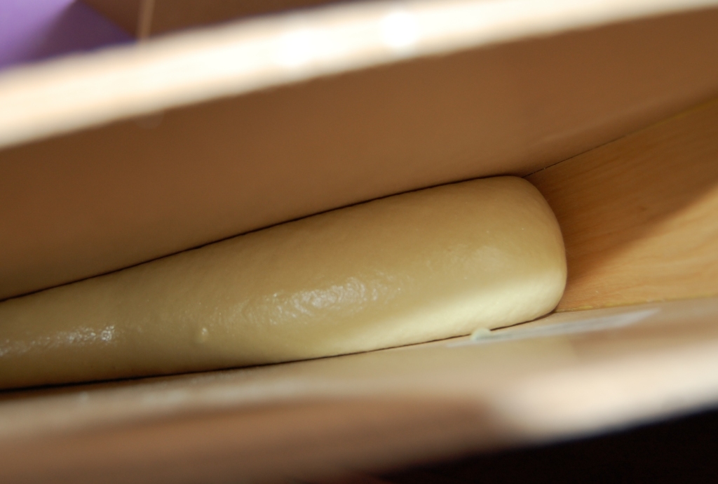

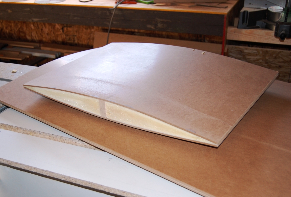

I did some foam pouring last night.
First thing I notice when I open the cans (part A and part B) from US Composites is that they are only about 3/4 full, probably less😡 This means I will not have enough to fill all of the panels in both boxes. Needing roughly 120 litres of expanded foam, including waste would require a total of 240 litres for both boxes. Allowing for the one small panel already filled with spayfoam would be my safety margin (~20 litres). The 8 litres of unexpanded should give ~240 litres expanded (30x expansion). If I only have 6 litres to start, well it becomes obvious that I'll run short.
If I had known that they advertise 2 gallons as a gallon and a half, I would have looked elsewhere or at least ordered the amount extra that I need.
Enough ranting...onward!

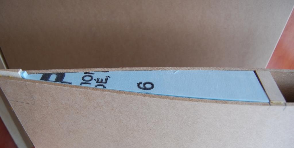

I cut out ribs from 1.5 inch Styrofoam board to create a divider half way down the void:
that way I could pour from both ends:
It took some trial and error to determine the best amount to mix up at a time. An ounce of part A and an once of part B gave the best results:
Otherwise, fairly boring work - measure it out in plastic beer glasses, mix it up while counting (one one thousand, two one thousand three one thousand...) and pour it in. It went in easily without touching the sides and once it was in I tipped and tilted the panel to spread it out evenly to give an even "lift". Each pour was about 5 inches high when expanded.

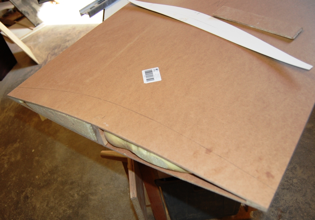

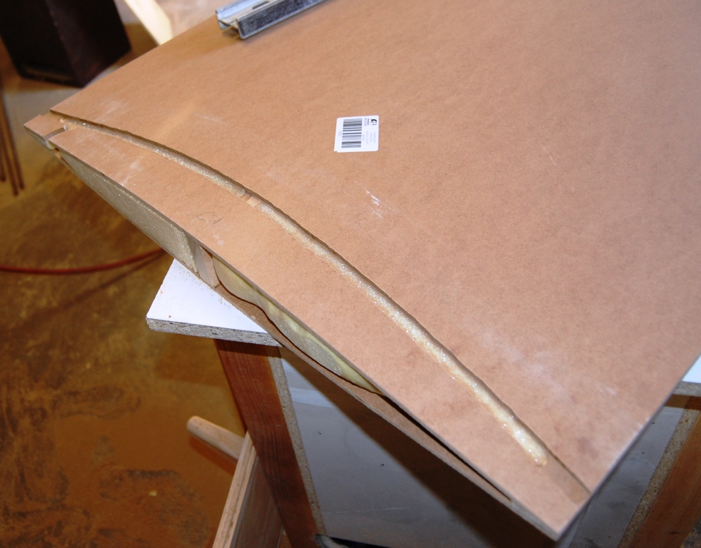

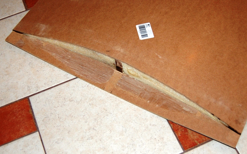

With all of the panels filled for the first speaker, I brave the -10C of my workshop to trim them to size and start fitting them together.
A panel after trimming it to size:

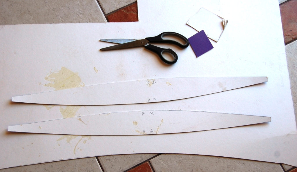

First step is to make some cardboard templates of each curve:
The idea is to cut out the side panels to fit the top and bottom panels which means that some of the "meat" will need to be removed from the sides.
Lay out the curve using the template:
Free hand route to the line:
The sliver of hardboard is taken out along with the foam under it and the piece of the backbone.

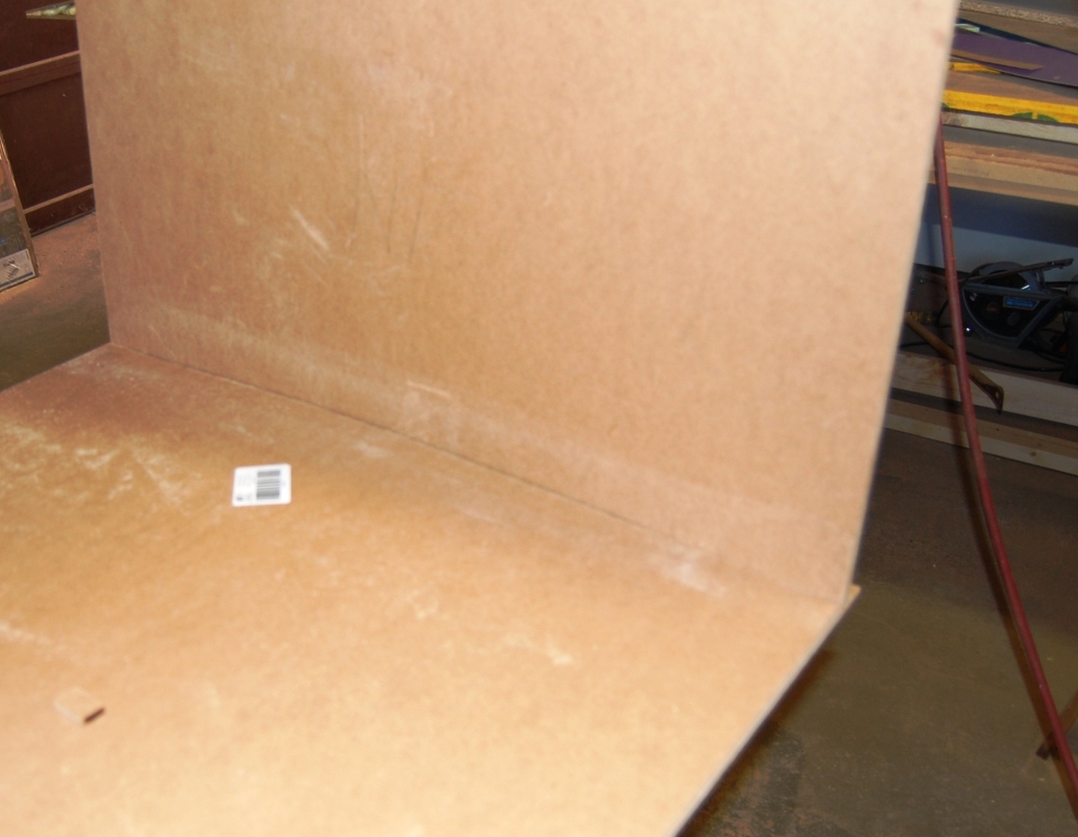

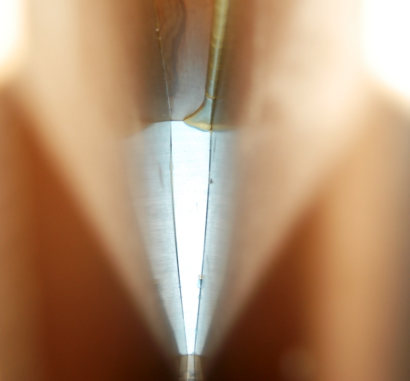

With the meat removed, leaving the outer skin:
The top/bottom panel is then scribed to the curve to fit tight against the inside face of the outer skin:
After it is glued and screwed together, I will trim off the excess.
This is how the inside corner looks:
This seems difficult and it is but didn't take very long to do. Getting everything squared up and making the layout so that it allows for the different curvatures but still maintains a box that is true and square was time consuming.

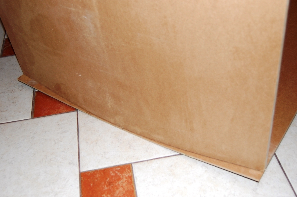

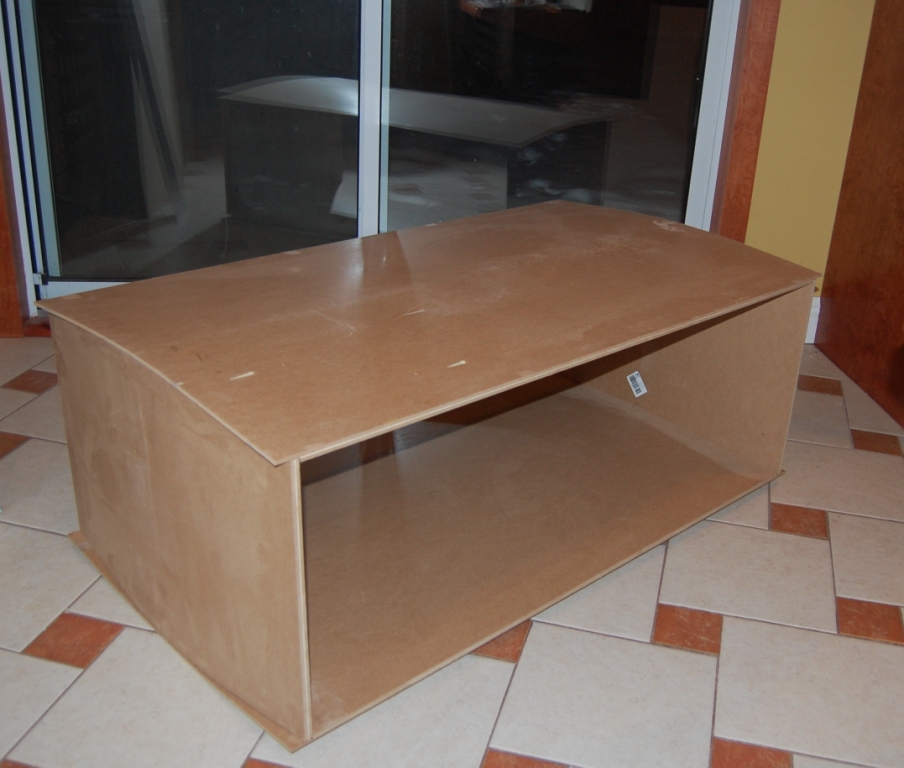

Dry fit of the panels:
Looking like a box? 🙂
The fun starts tomorrow - gluing it together. I need to use large screws thru the backbone of the top/bottom panels into the backbone of the side panels as the major mechanical fastening. I'll use the high density foam as "glue" after scooping out some of the other foam.
I have decided to go with particle board and MDF for the front and back, with a particle board full panel brace from front to back.
