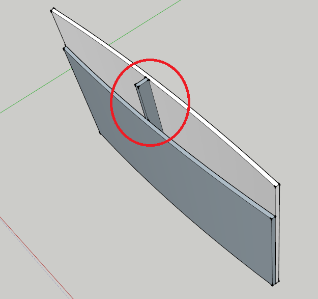

Curving the panel massively increases strength - the way these panels are designed and joined together leaves only one "weak" point: the vertical centre axis of the tallest panels may flex slightly. To help combat this I will use steel flat bar for the divider shown circled here:
Up the side panels and the bottom and top panels will have 1/4" x 1 1/2" flat bar and the back will have 1/4" x 1".

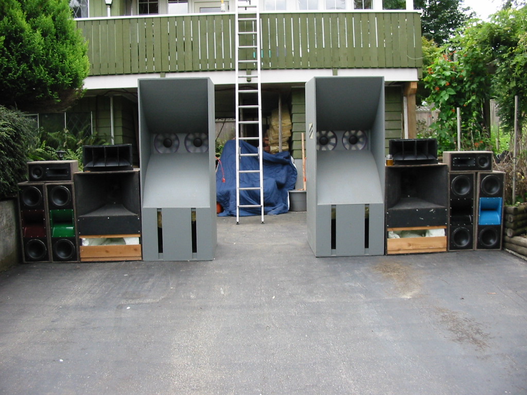

Cal's block party Wall of Sound.
You called?

The idea is to not use extra bracing, that these panels should be stiff enough on their own. Time will tell - I won't hesitate to use extra bracing but only if it is needed.
Fitting the panels together will be a challenge anyway. A slight difference in symmetry would make a difference if I were to miter the corners. Since I plan on coping the corners together, it shouldn't be a problem.

The horn flare will not be a problem to construct - I won't need a CNC (there were and are people that can fabricate accurately without them) and I'll try to go through the process with a few pics to show what I'm doing. I'm a bit pressed for time right now with a few different things happening but I may find time on the weekend to get started on the flare..

I think that the foam will be as good a fill material as any, for the design objective (lightweight, extra stiff). It has some "give" which is probably better than a complete solid as far as sound is concerned. Would something like sand be better? - most likely but it would be very heavy and I want to be able to move these and not have to reinforce the floor to hold them up.
Not mentioned yet is the other advantage of this panel shape: no real parallel surfaces, both inside the enclosure and inside the panels.

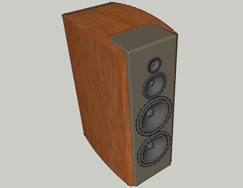

I have been thinking that I will make the baffle a bit more elaborate than pictured earlier. The body of these speakers will be veneered, with the back and the baffle painted. I'm looking to do a marble / granite effect in the paint - something a bit different.

I have to say I'm impressed with the thought put into the cabinet design. And you even thought out the construction in detail as well. I convinced it will work the way you think it will. Most of the naysayers seem to have fallen away. I voted "It'll Work" early.

I've modified the front baffle some. The concept:
Somewhat more interesting looking I think.
