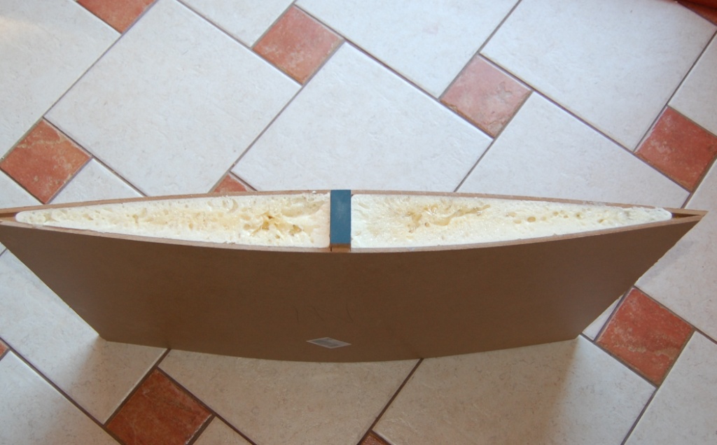

I did an experiment - I tried sprayfoam in a can:
This worked very well on this shorter section but it would be a bit trickier on the long one - I'd have to drill holes to inject the foam at the middle.
Each void of the long section has a volume of ~20 litres and it would be very expensive to fill these this way. Since I've had zero luck finding a reasonably priced local source for this foam, I've gone ahead and ordered it from US Composites. Their price is the best I've found so far - nearly 4 times less than the equal amount at a local supplier.
There's not much I can do until I get that foam, just finish assembling the panels and getting them ready to fill.
If I learned one thing from the sprayfoam filling, it's that this WILL work - my Gods how rigid is that section now!
my how rigid is that section now

small wonder, foamcore sandwich is one, the double-convex geometry added leaves just the compressibility of polyurethane foam as main squeeze.

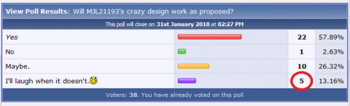

(scuse the vote, poll options like that should be prohibited, i decline responsibility for the four follow-ups)

As Jacco mentioned, a convex foam sandwich is stiff and strong indeed. It's a technique sometimes used on rocket fins. Passing through mach subjects them to large stresses due to pressure, where failure mode is vibration followed by shredding.

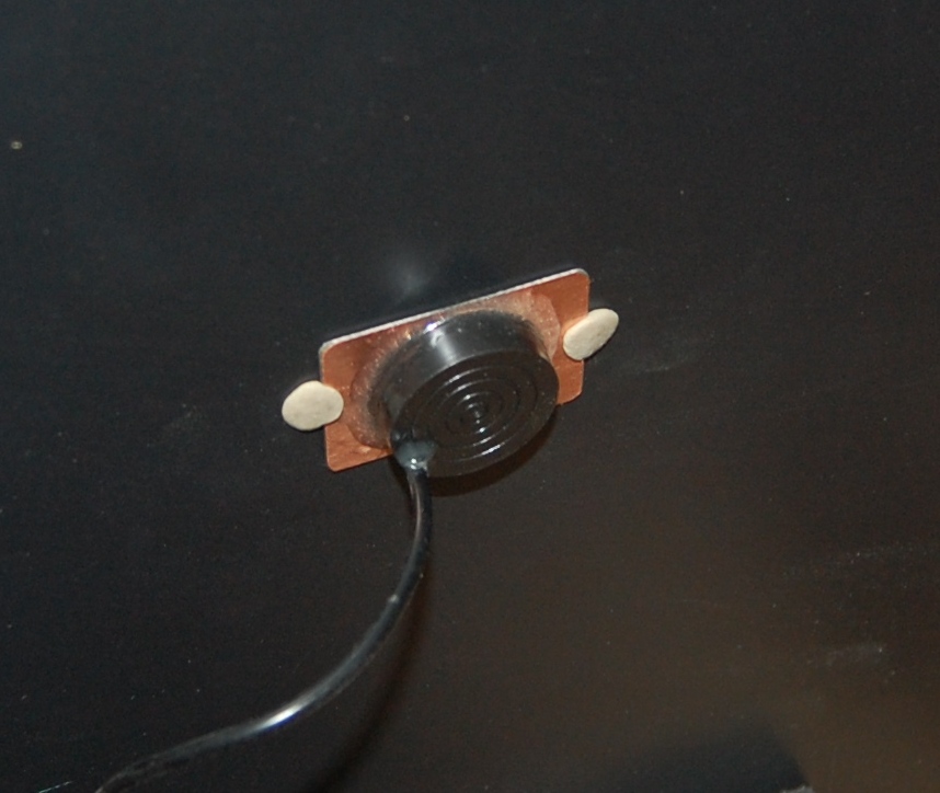

Unlike the materials tests, this time I'll use my homemade accelerometer:
It is very sensitive, has very wide response and gives good clean readings.
