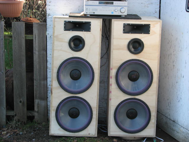

It was an taunt. It would be nice to see something like this with a couple 15's, a strong mid and nice horn tweeter in your plans. This business of a 1" dome tweeter just doesn't cut it when you use the word large John.

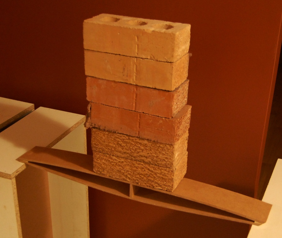

I did a little test this evening:
That is the longer piece loaded with 30lbs of brick. This is just a 3" wide section and with that much weight there wasn't any measurable deflection.
Tomorrow I'll find some more weight to put on it to see how much it takes to have it deflect. It's quite strong.

Yes but those have been subject to a lot of moisture. AND once again we are not recognizing the BIG role the urethane foam will play.
To seal the hardboard on the inside of the box I'll give these a coat of polyurethane. It will stop moisture absorption.
P-laming these panels is not what I want to do - I'd rather go for a superior material in the first place.
Realistically I don't think there's cause for concern.
