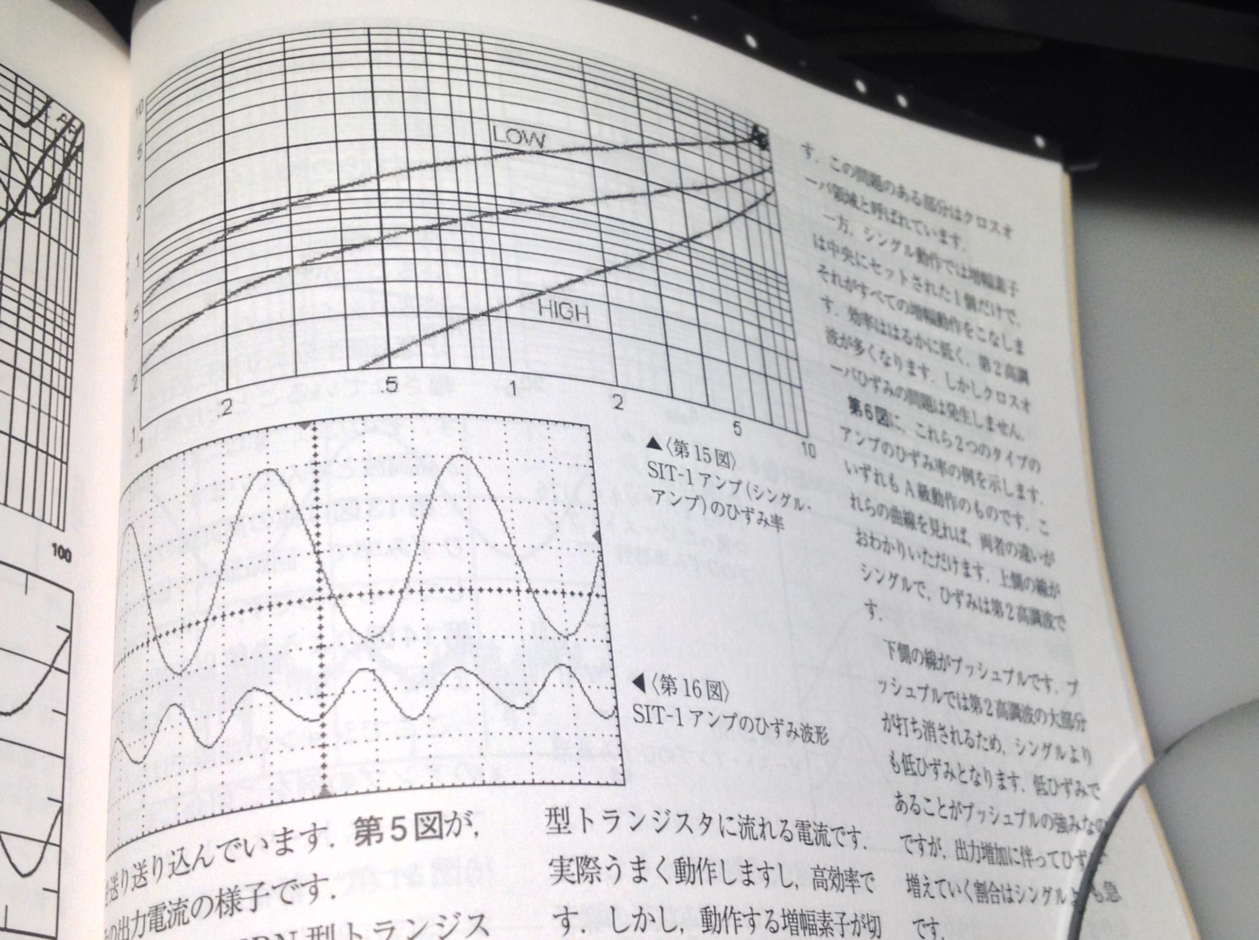

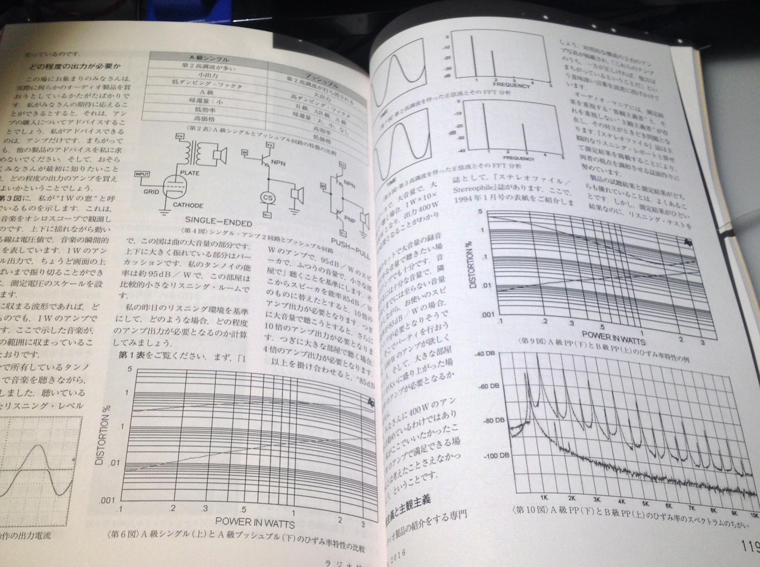

ps : Surprise in Japanese Diyers MJ Magasine Nr 909 | 4 | 2016
i find Mr Pass article speak at California Audio Show haha cool 😀

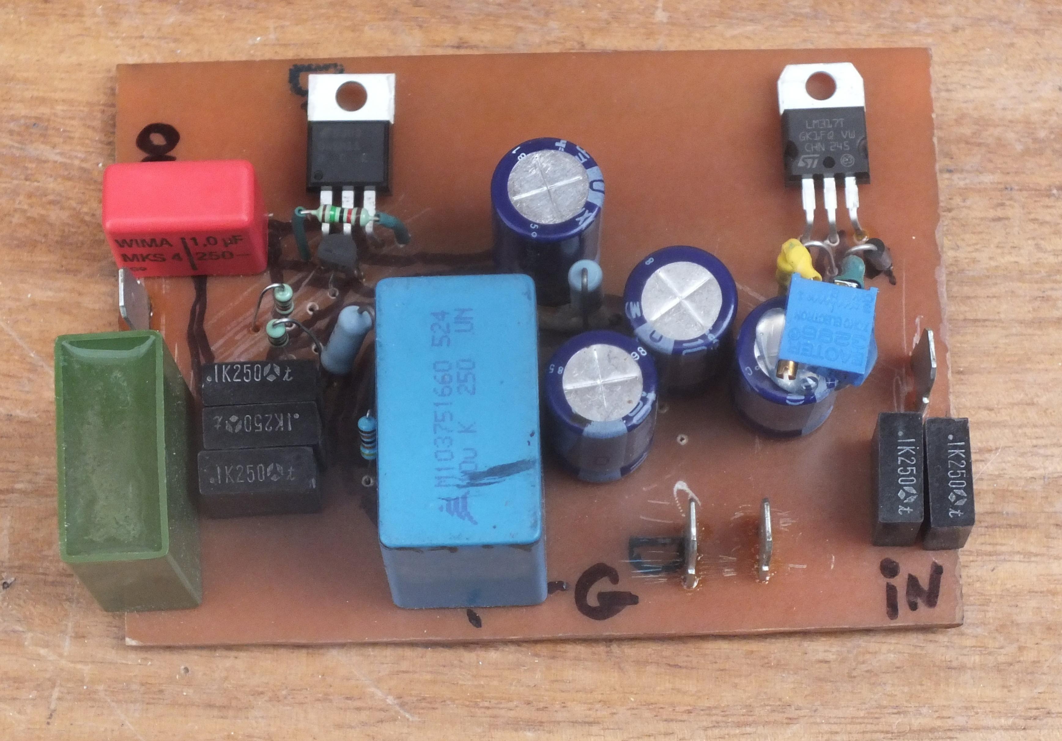

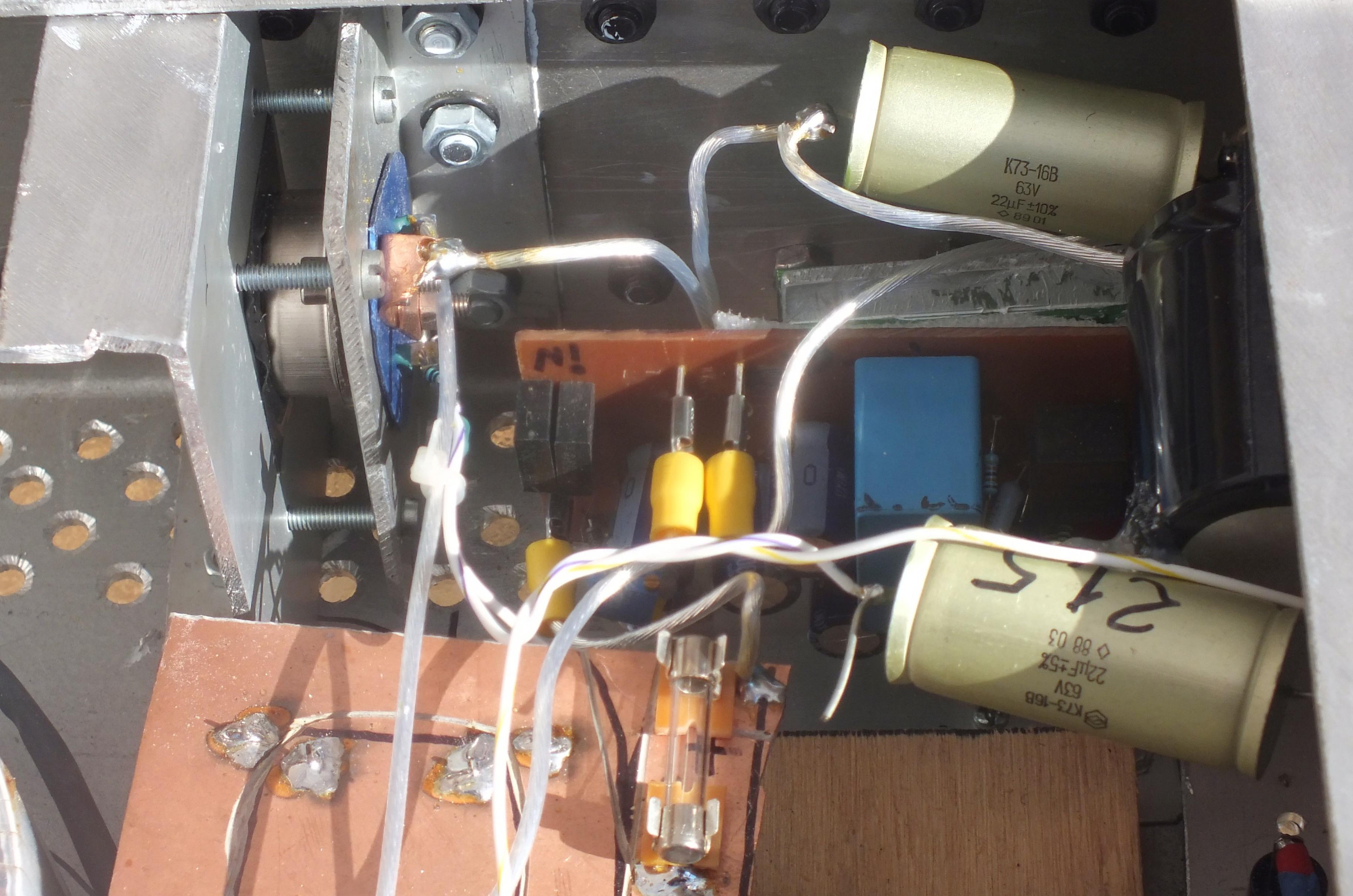

I am the happy father of a new single ended SIT amp with 2SK180. Thank to Mr Pass, Mr. Rothacher for all his input and encouragement and last but not least, to Nishizawa San. 🙂
I didn't have a decent L bracket so I created a sandwich heat transfer device (the 180's top being flat) to double heat transfer area, for my ugly DIY box 😱
It works so far, for around 1A bias...
BTW, Vbias and B+ get their own regulated supply and I used 40mF pre-regulator capacitance, an excess for me, of regular quality caps, reserving the best quality electrolytics for the output, this time. I use a combination of PETP and polyestyrene (Russian War surplus) for in/out DC blocking. Works very well.
A couple of pics from the power regulator and sandwich heat transfer system, pre-finish.

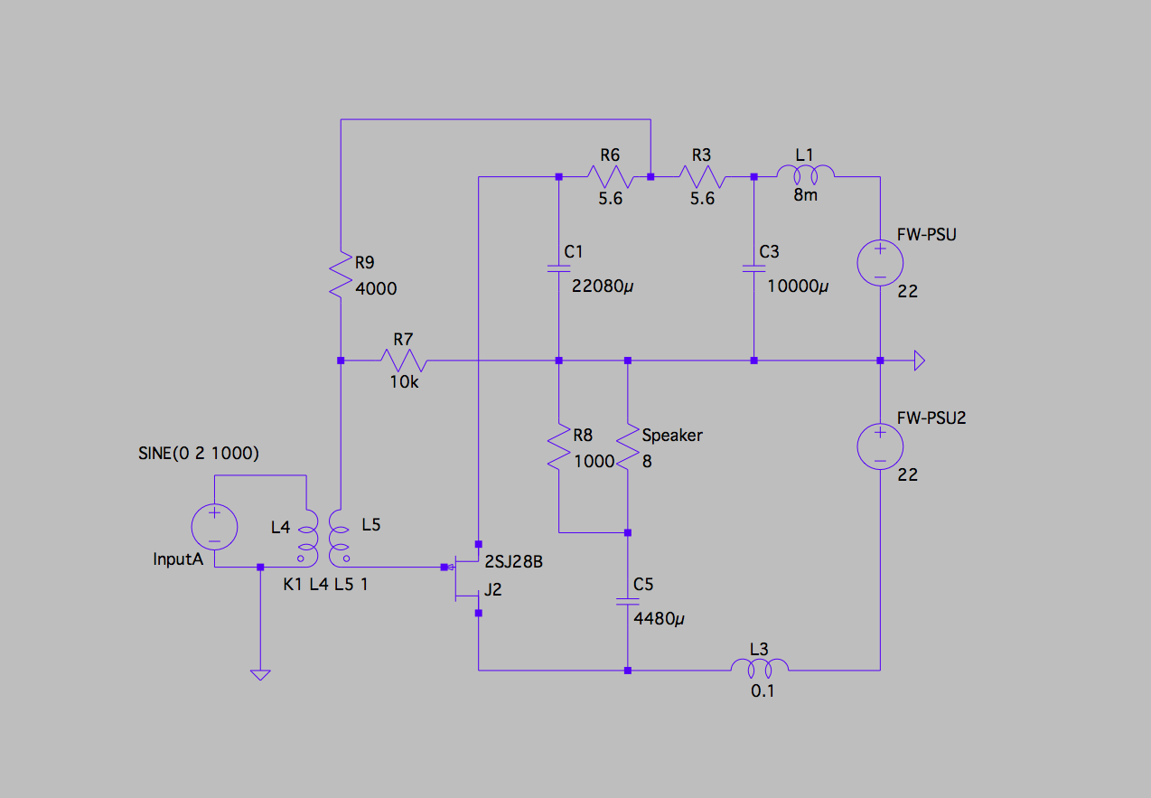

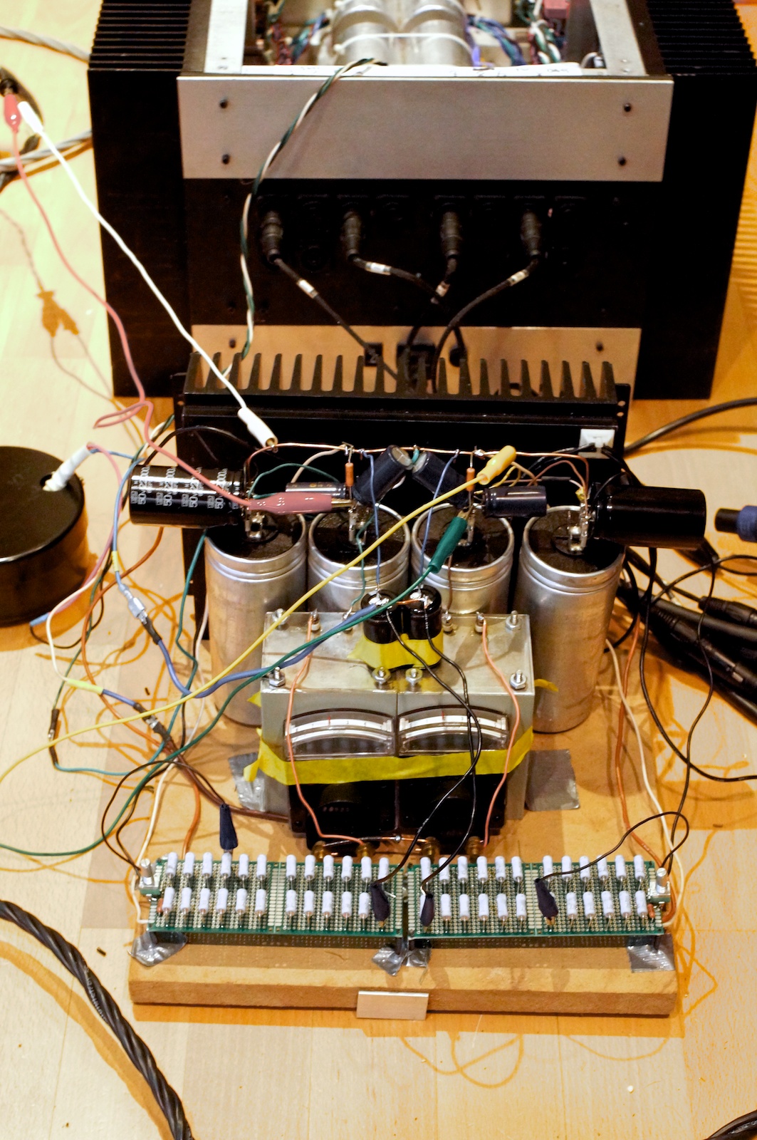

Dual PSU L'amp
I prototyped L'amp with regular First Watt supply. A few members here are probably still wondering if it's doable, so I post the result of my experiment.
1 Choke version - My choke is a surplus 0.1H 2.5 ohm 2.25A from Ebay. Works fine, but it gets warm as expected.
2 Transformer input - My DAC has 600:600 output transformer, so I just directly connected it to the input of the L'amp.
3. Resistor bank -This is a self biased version. The bank enables to adjust the voltage and bias with croc cables for matching left and right. Popular 0.47 Panasonic, and they get hot. An additional pot enables further bias adjustment as well.
4 ZM recommended motor caps are really good. I also recommend motor caps for this amp.
5 Additional LC filter was needed to eliminate the hum. I used 8mH and 10000u, and it works great.
6 My prototype is with 2SJ28 but 2SK82 should work well.
Conclusion - Amp works very well, and sounds really nice with no hum.

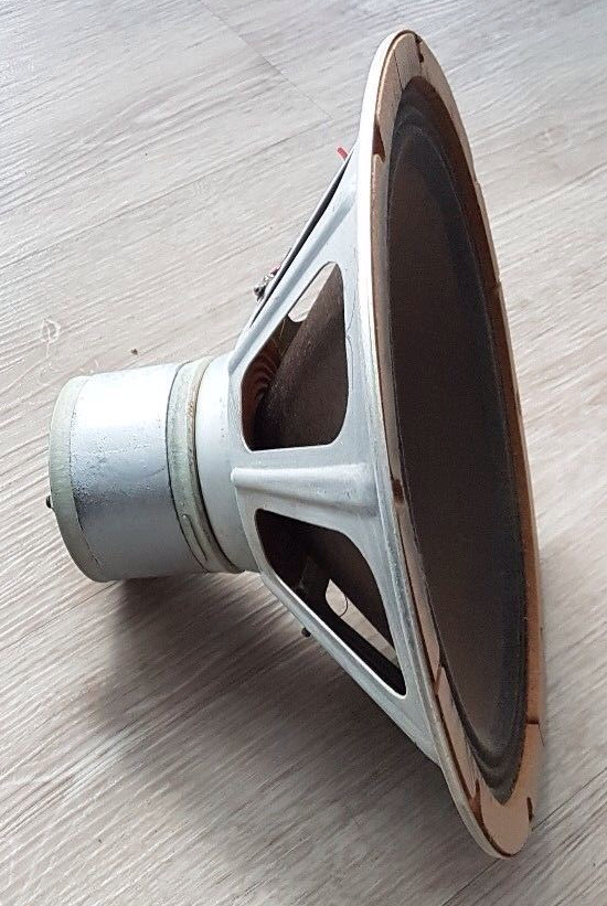

My is not finshed yet because i spend last week's all my hobby €$ budget on new drivers
and the next vintage 12'' full range alnico's pairs too.Full ranges are 98 dB.
Drivers have 102dB efficiency so i can enjoy flea watt's amplifiers use practicaly 1 watt and that plenty.

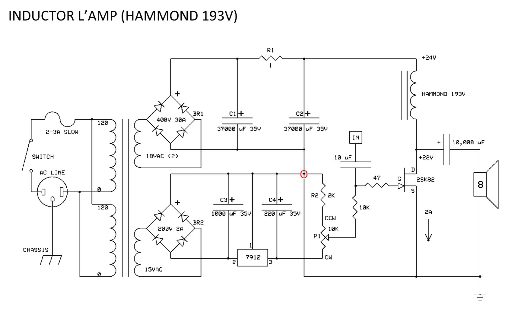

My Inductor 193V L'Amp project is for play music with this new efficient stuff
@ Michael Rothacher and Diyers

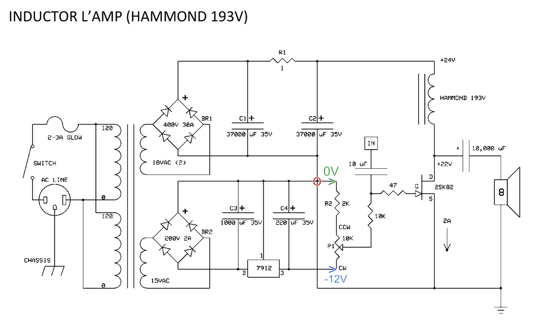

No 18 V secondaires toroids for the moment to power on my prototype but i get 2 bench power supply's 30V/5 A.
My point-to point wiring is practicaly ready, bias circuit too.
I am affraid to start power on because vfet is depletion type.
My question : how i make them safe power on with 2 lab psu's ?
If you mean to use one bench supply for B+ and the other for bias then you just want to make sure the bias supply is switched on first. I do this sort of thing all the time. I usually set the bias supply for -12V or more then slowly bring it up to where I want it after I switch on the B+.
Remember to have fun 🙂
Just turn on the bias supply first and verify negative voltage at gate. -12 volts is a good starting point. Then turn on the +24 supply. Finally, adjust the bias supply while keeping an eye on the bias current.
Thanks Michael and PSz for helpful answers.
Ok psu for the bias first.
On the side of 2K resistor i need 0V right ?
Green ground of the lab psu connected together with red (+) i guess.
Best regards 🙂
Or connect first lab psu black (-) with second psu red (+) and the green ( ground)?

My attempt is probably not really practical, but I was really curious if my LTSpice simulation would work the same in real world. I'm happy to see it works, and I find LTSpice is more accurate than I expected.
Now I have more confidence to realize LTSpice emulation.

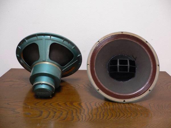

Nice Altecs! What is the other one? Phillips? Now my L'mp is connected to old Jensens.
Yes silver colour is the alnico 1255 Phillips 8 ohm's bi-cones.
What i like they are large 12''~30 cm not 8 ''
can play music without crossover contrary to coaxials.
You can find them at affordable price on the flea market.
What your Jensens reference ?
Me like that high quality old school audio model's.
Must go sleep now but tomorrow i do try how Phillips sound
with Inductor L'Amp prototype if all work correctly
