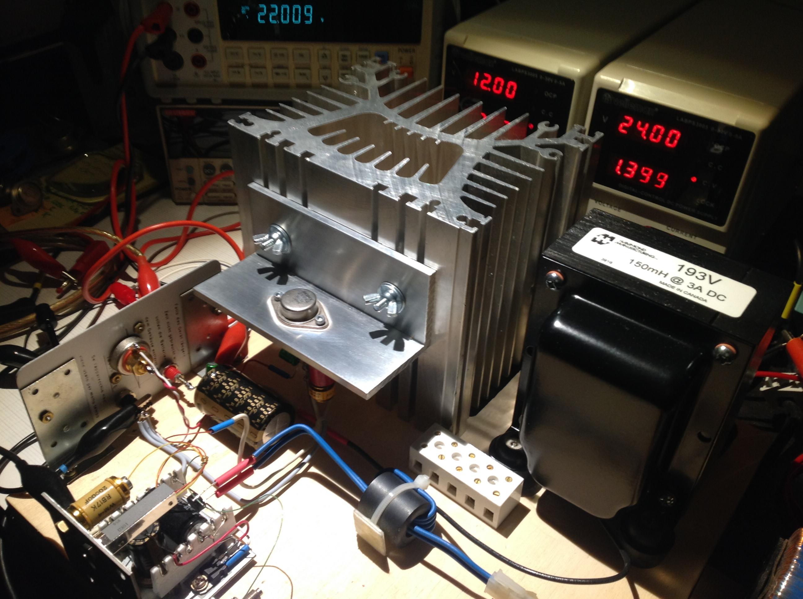

Haha Yes Angels are visiting my listening room now.
Amplifier from the first start power on work like a charm.
Was sleepless night full of songs and many music hours today.
Trimming 22V from drain to ground was quick to find and after temperature stabilisation
i plug them with CD player , triode preamp and 12'' alnico full ranges.
Incredible nice voices and good surprise about bass .
Now i feel highly motivated to build final version monoblock's.
It's fun and bunch of satisfaction diy project

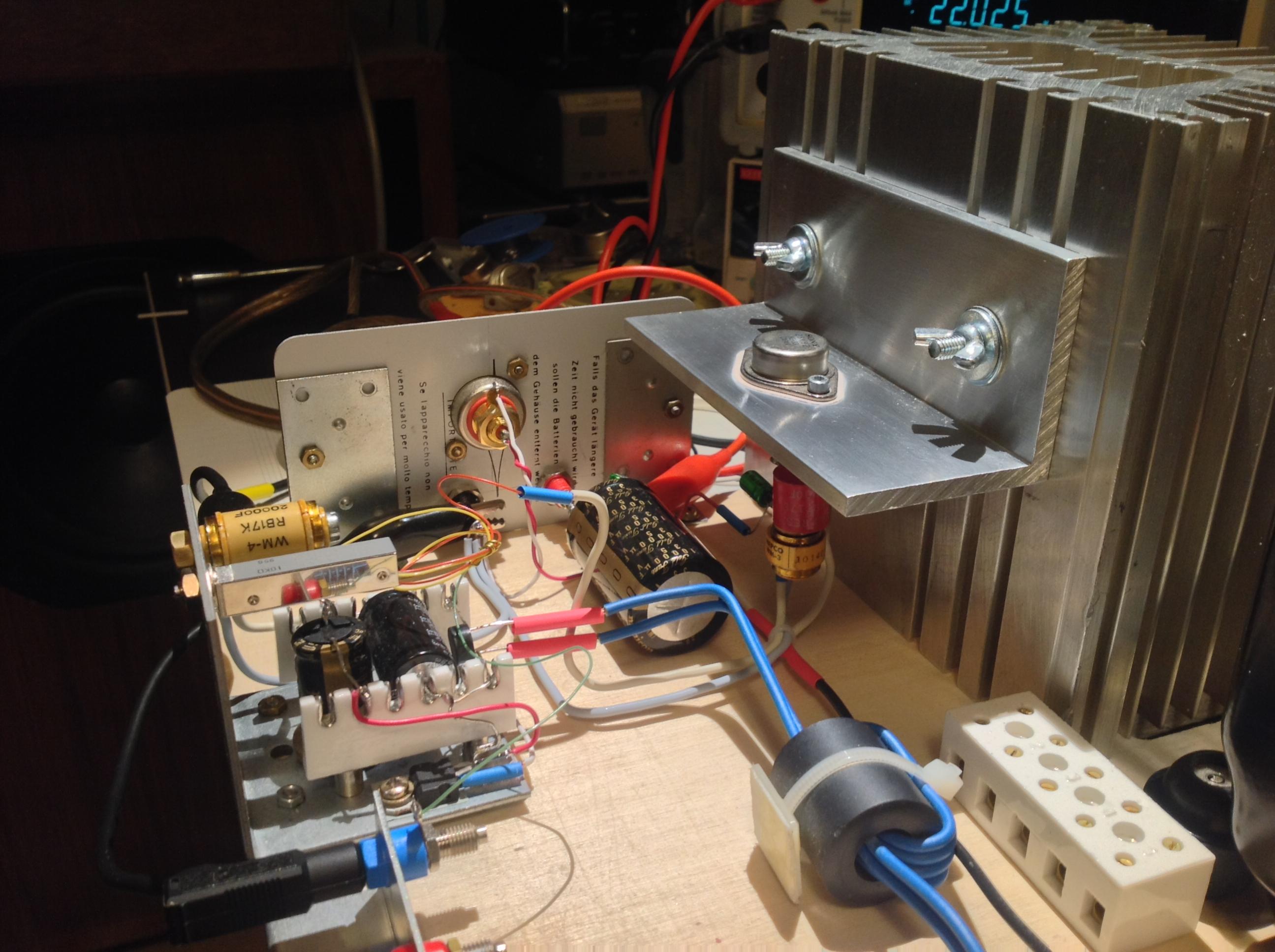

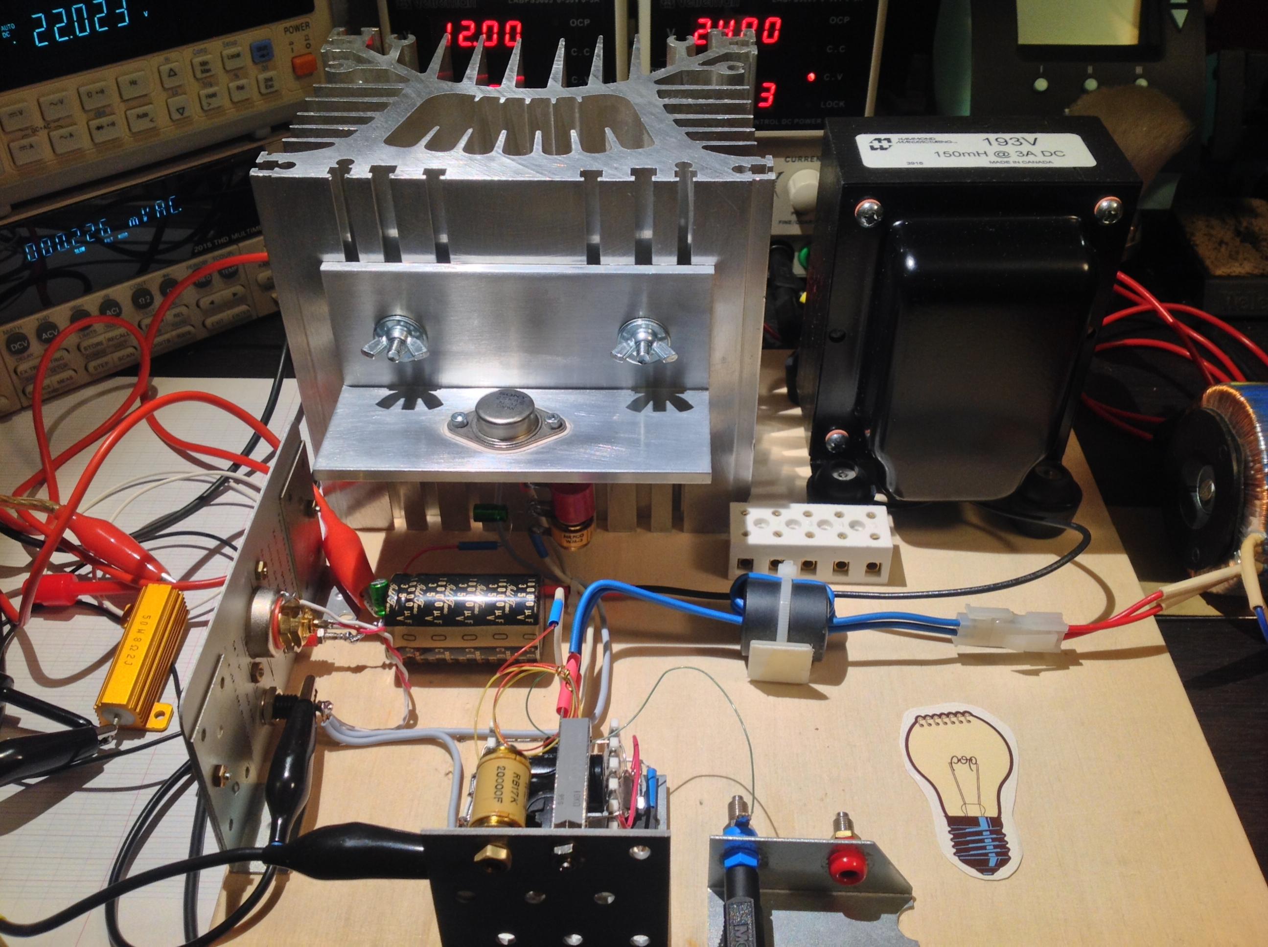

intringuant l'ami !🙂 what is the red cylinder just under the VFet ? the yellow one seems a variable capacitor what is for?
Haha i am always curious too and like share my findings.
Was interesting to do something i don't have ready made so
i try not use classic metal film resistors and the cermet trimmers this time.
Concept is 193V L'Amp with all wire wound Ayrton Perry
non-magnetic materials resistors and high quality wire wound trimmer 10K silver grey colour.
Red cylinder = 47 ohm's , yellow one are 10K and other is 2K in bias circuit.
All components the same like on original schematic : input cap 10uF is bipolar Muse
and electrochemical 10000 uF|35 V Nichicon Gold Tune bypassed with second green bipolar Muse.

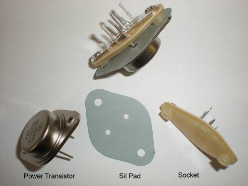

For pleasure of experimenting to try other technology resistors my 2SK82 have place
into TO-3 socket i do not solder or desolder directly on his pins and keep them safe :house:

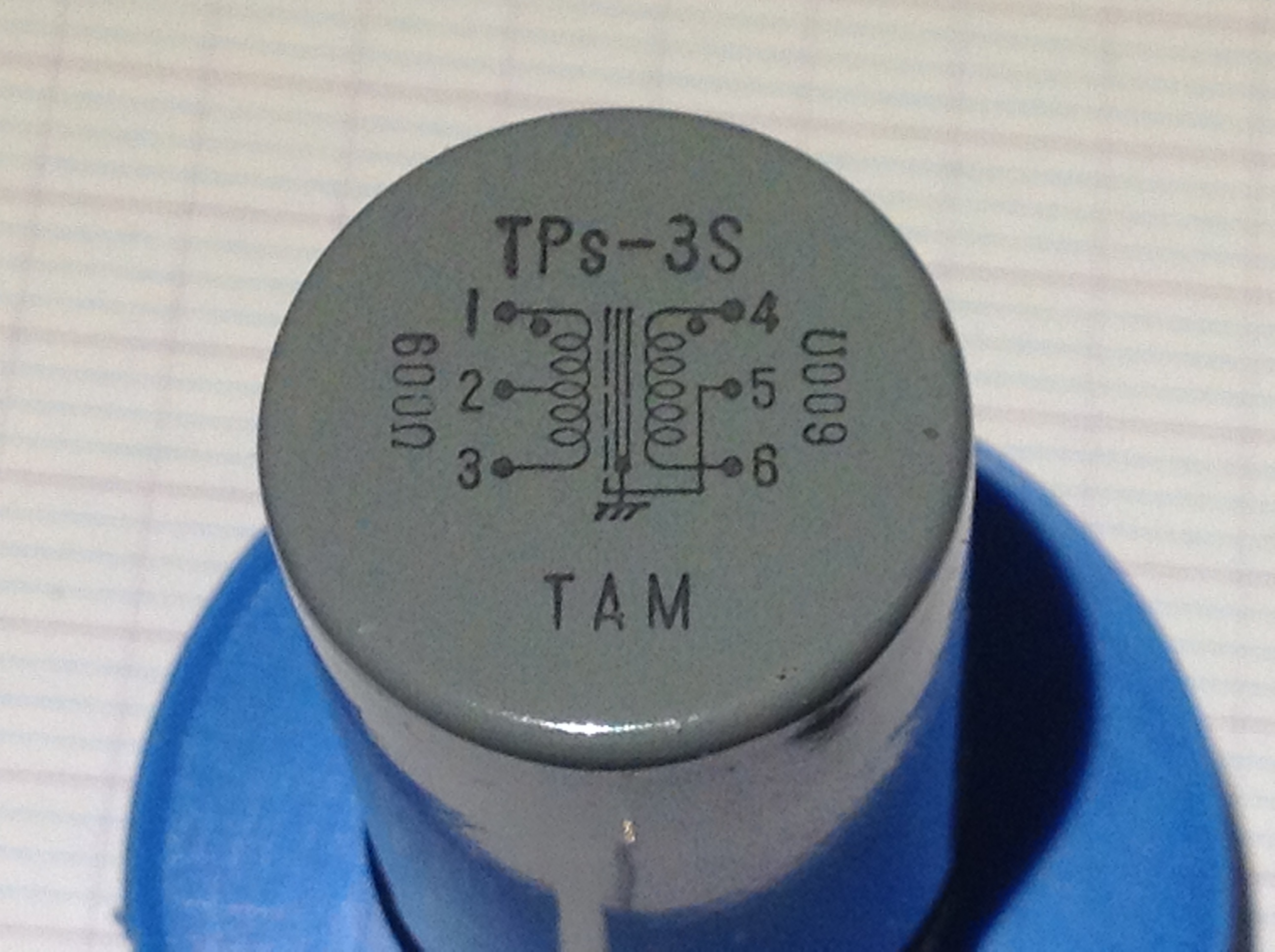

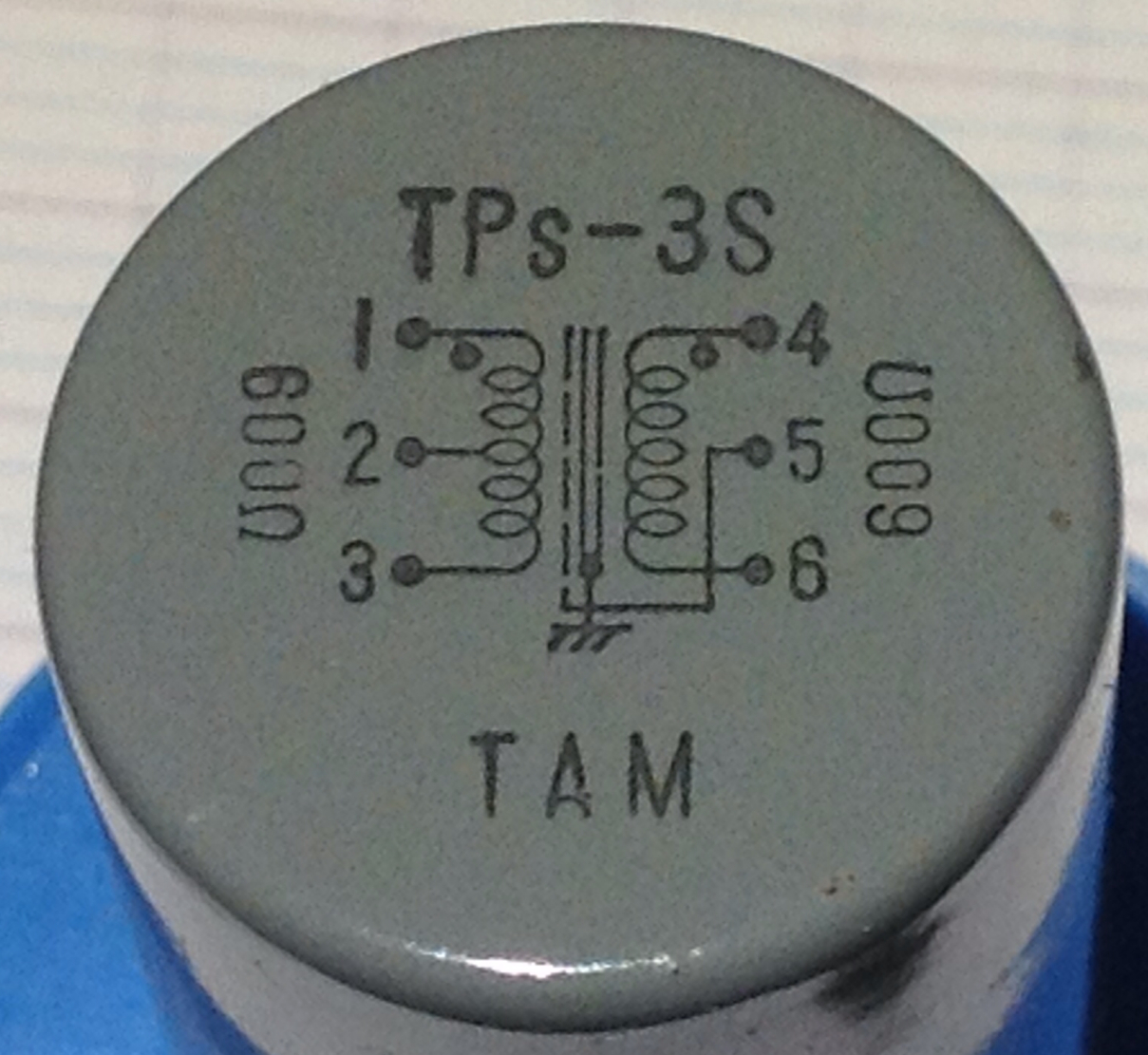

Connecting 600:600 input transformer on the place of 10uF is worth to try ?
Some wait in drawer. If yes how wire them for best performance , dot directions , (-)(+) any tips ?

4 should be connected to Bias + 10K, otherwise no bias voltage on the gate. I'm curious which you like better, Transformer or Cap.
On the schematic they be like that ?
Must be sure no ruin working amp with wrong wiring.
Yes with pleasure i write you what cap versus input transformer sonic difference is 🙂
