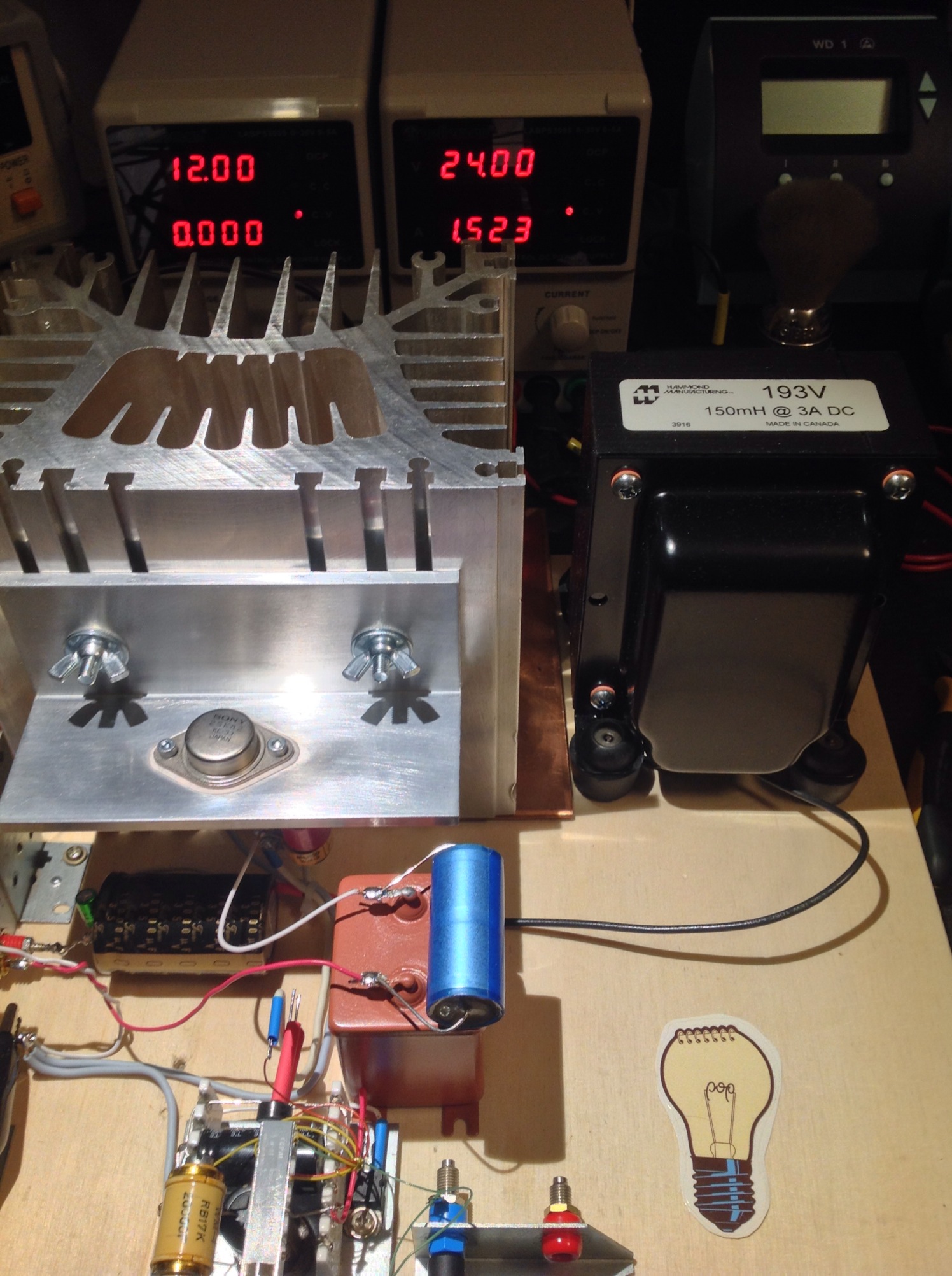

Good news i not need be worry about high temperature.
After few hours heat sink are hot without burning sensation.
Btw drills of TO-3 holes in L profile inside the kichen was my last time 😀
For final version i do this with adapted professional workshop tools.

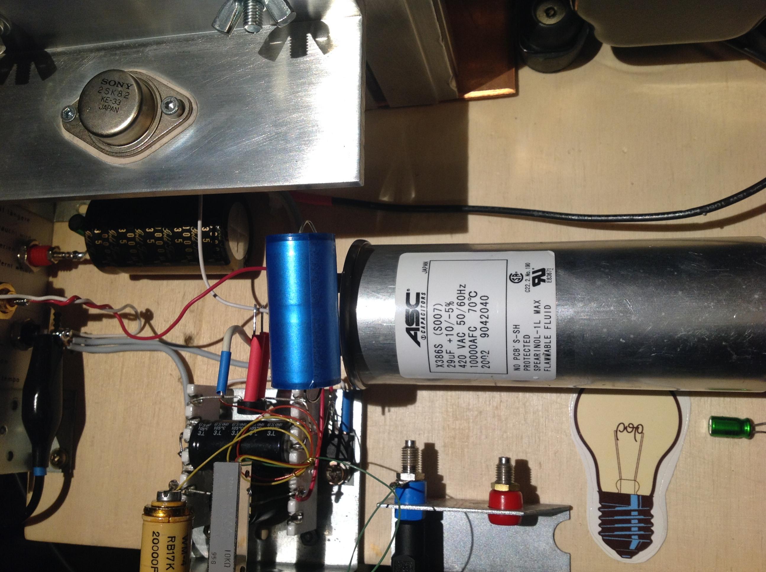

Input Capacitor
I was think solder transformer on place of 10 uF Muse cap but i change my mind.
I try what happen if i change for other capacitors first.
Let's have fun little longer before game with input transformers.
What i can say now they all bring his touch of personality to input signal.
Under test was PIO brick from Russia, ASC and Bosch all with 0,1 uF Ero MKP.
Preamp is switched on high gain output , full volume show on the photo.
Iron was cheap in Western Electric golden age , cap's was scarce to get contrary this modern days

Play with Inductor 193V L'Amp now 🙂

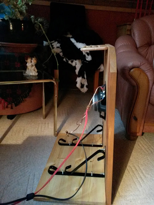

L`Amp resistor version with OB
Hi to all.
My SK82 homemade L`Amp has been giving me pleasure for several year now. And with the addition of the LuminAria(also with SK82) it is an never-ending joy in music.
And the last year (in my past-sickness time) build me a version of the Betsy OB - my old Alpair 12P is mostly resting in the background. The 8" driver fills the room and is softer and nicer soundwise? More substance to voices and more involvment in OB-solutions. Maybe get an OB-planar to fill in the upper end of the spectrum - maybe. The Alpair 12 is more distinct and hifi right!
So my journey in Hi-Fi is at a halt and for the moment just enjoying music and trying to recuperate in this pre-oldtimer moment😉
Best
Olav
