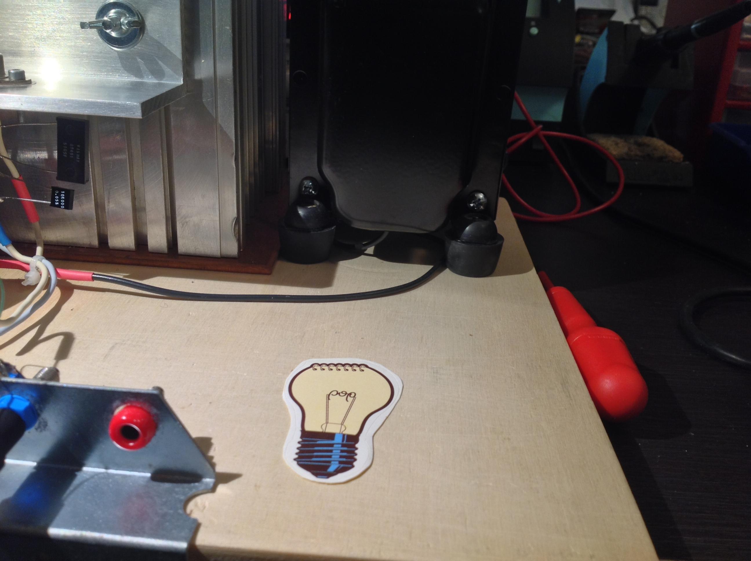

Hello JP
Bias supply needs are small wattage : 5 VA is a lot but if you get bigger transformer that work too.
Bridge diodes for bias supply is 2 A or more.
Your vfet is better on aluminium L bracked they can't be on the pcb directly because high temperature.
Your first design is great http://www.diyaudio.com/forums/pass-labs/201655-lamp-simple-sit-amp-278.html#post5089678 with huge heat sinks 😉
Have a nice day

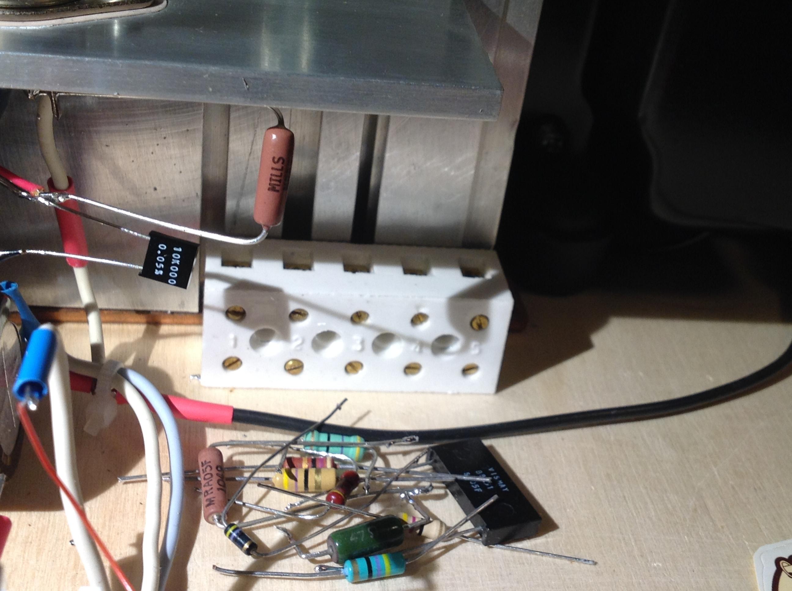

That for the future....play this morning L'Amp version with bulk foil resistors.
Have a nice sunday
I will try resistor version this week, too. Let's exchange our opinion about it.

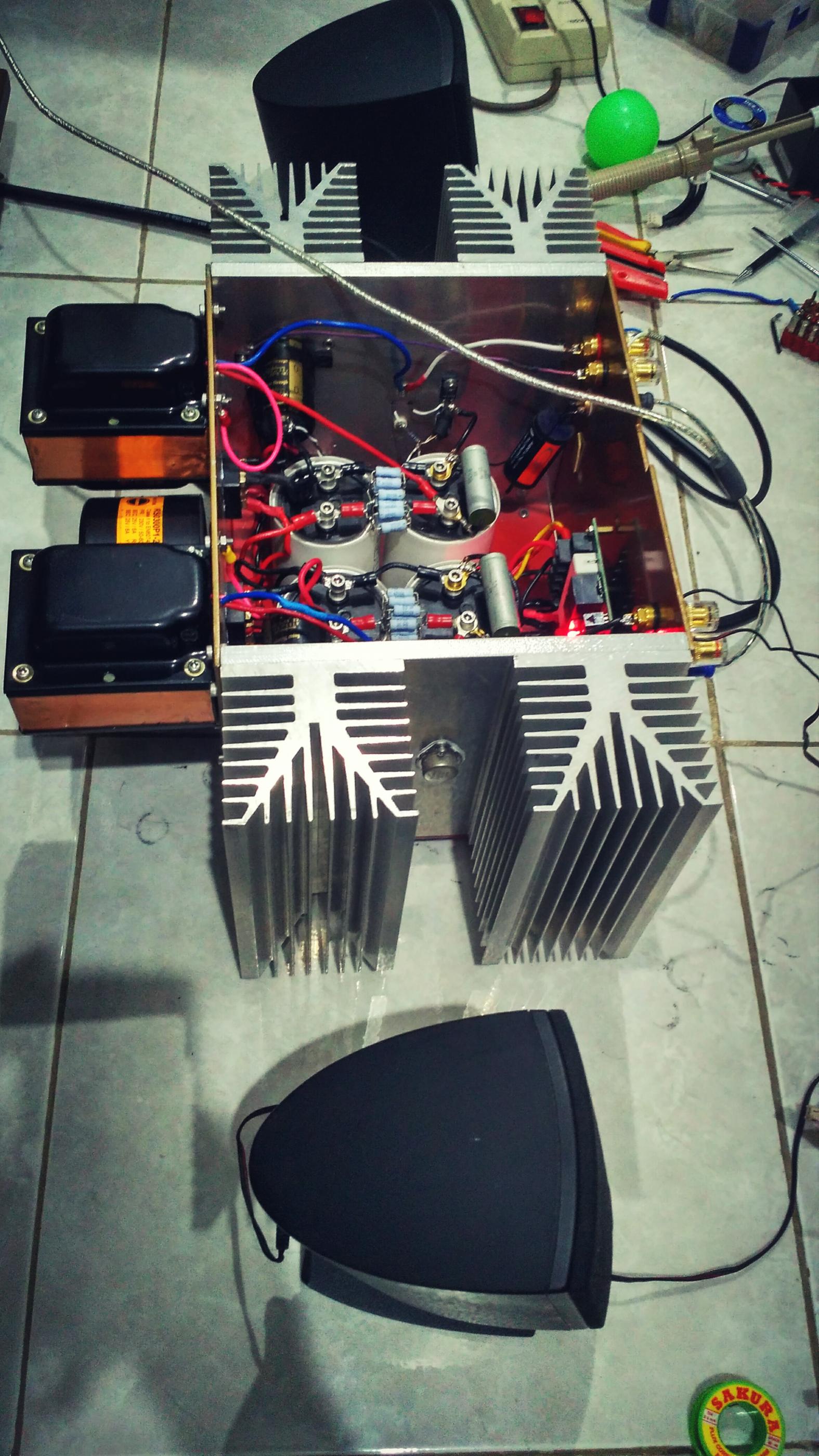

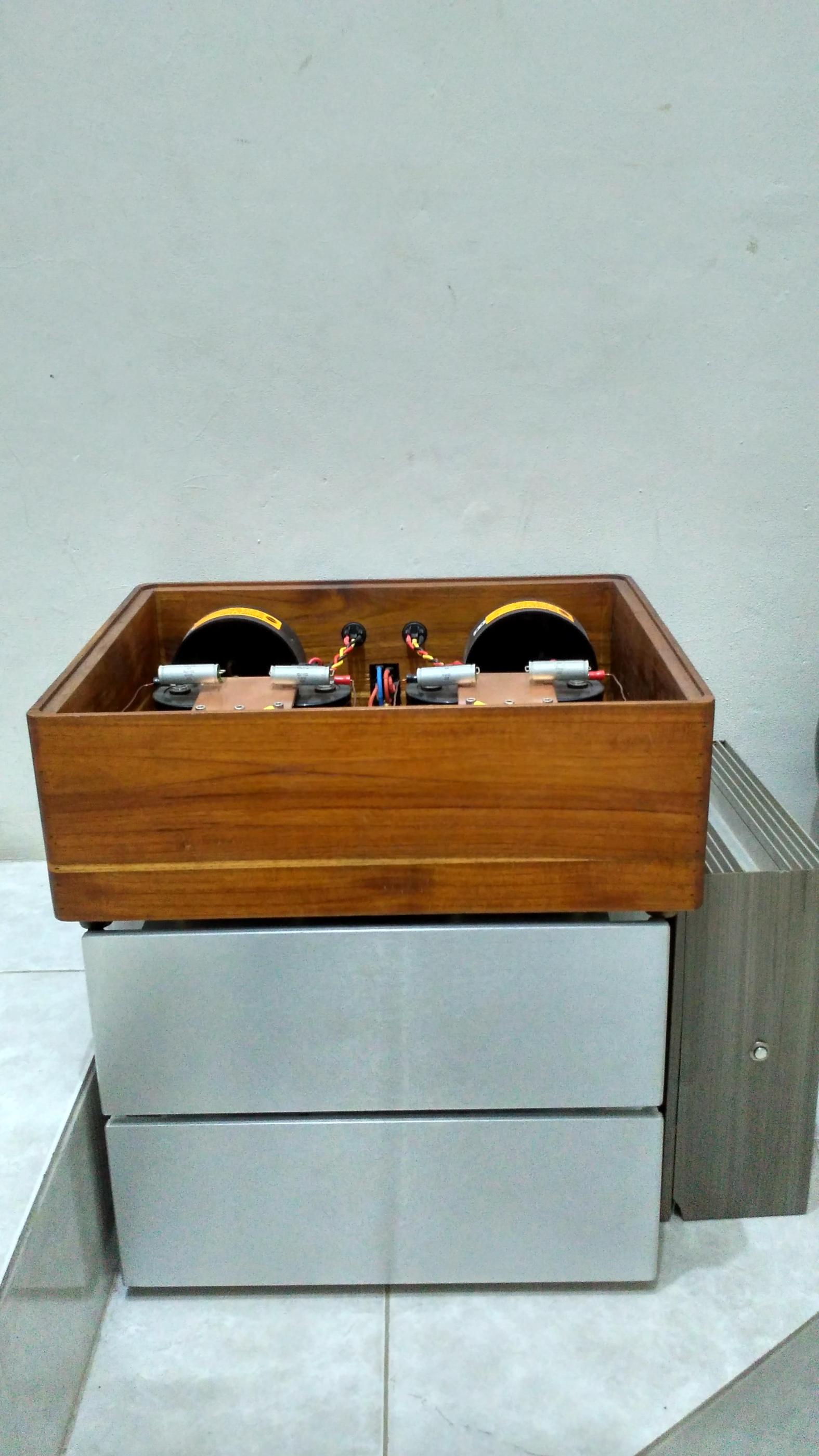

My Precious is back to live again after almost 1year dormancy, I only just wanted to separate those transformer with input rca because there was a strong hum but delayed due to OB project. testing with small speaker, no hum and no caps exploded like previous 1st turn on 😀
it's time to tidy up my living room, I'll have my friends visit this morning. We'll have to do some testing among SIT L'Amp vs J2 vs M2 for open baffle.
also check my drawer and found 2pair of 2SK82 and 1pair 2SJ28, if this amplifier survive another decade then my twin boys might still have a spare for replacement 😉

Well done L'Amp and you get generous heat sinks
so probably with that spare vfet's twins of your twin boys can amplify music again in all next century 😀
Best regards
It takes around 30minutes until heatsink temperature steady around 45°C, when its hot the vocal and treble is better 😀

After more than 3hr listening session (no wine for sure), me and my friends agreed that SIT is the top rank amplifier and it's back on my audio rack. sadly J2 & and M2 with FW psu have to go to the corner, waiting for another purpose one day.
I also got a new 8" fullrange produced by our local expert and this is more fun to listen than alpair 10p. another speaker rolling for OB experiment will follow

Few mods too this week

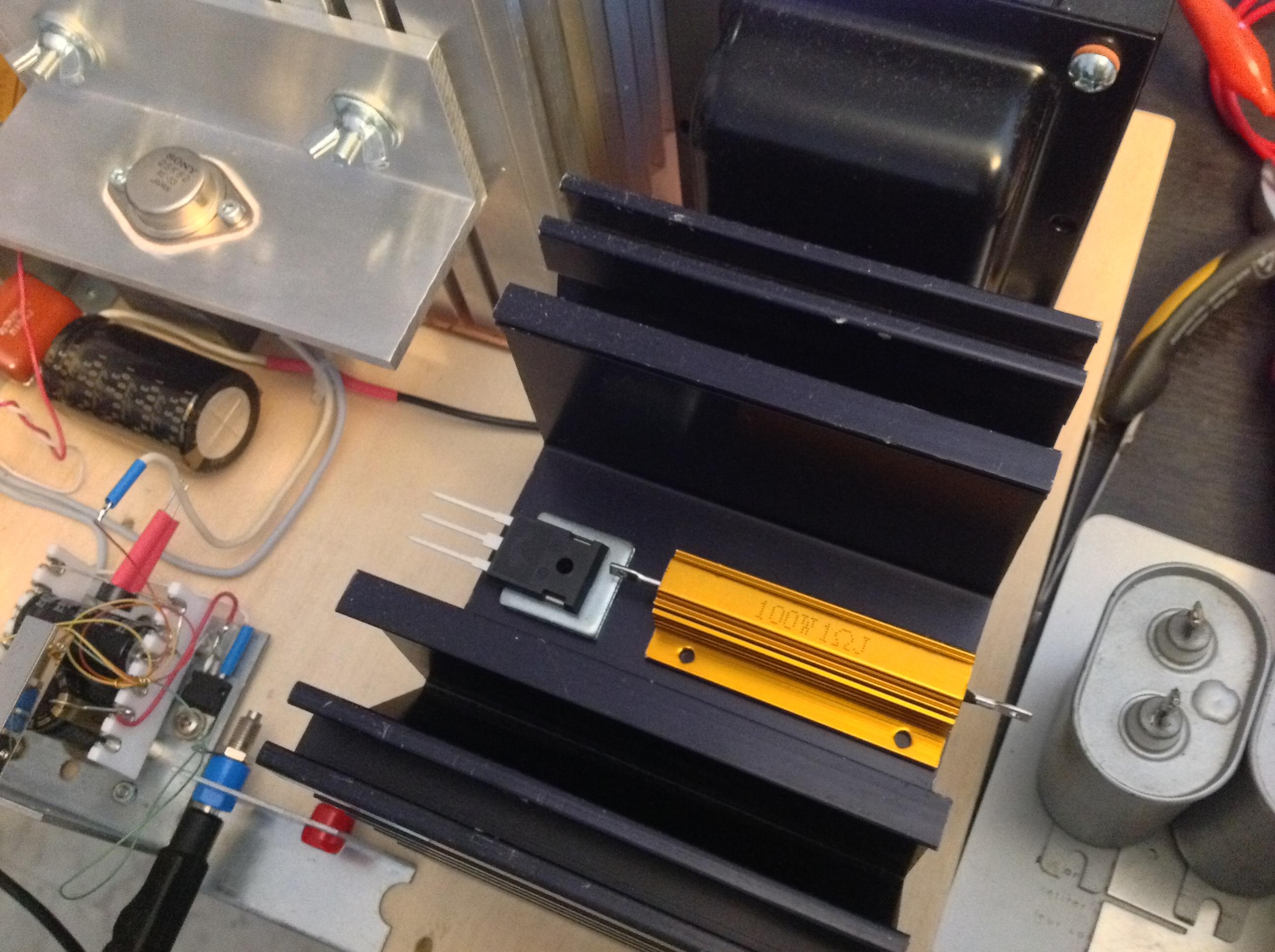

It was a bit hard to compare the resistor and choke versions directly, because the level and speaker interaction are different. I did digital EQ compensation to match their response. My choke version is more sensitive to the woofer impedance peak, resistor version is flatter. Tested at 18.5VDS, 2.0A.
Even after frequency compensation, there is a difference between them. Choke version has classic SET lush, resistor version has higher resolution. Both good, and it’s hard to choose one over the other. I tried choke and resistors at the same time. PSU - 10 ohm - choke - SIT. It has SET lush but higher resolution. I know it sounds somewhat silly, but I like it a lot. Please try this and let me know what you think. 😉
BTW, the bias circuit that I posted on 2704 is WRONG. I had to do something like post #2442. I'm not still sure if the way I’m doing is correct, but at least, the high frequency response is flat now. I wish someone would post the recommended transformer input circuit.

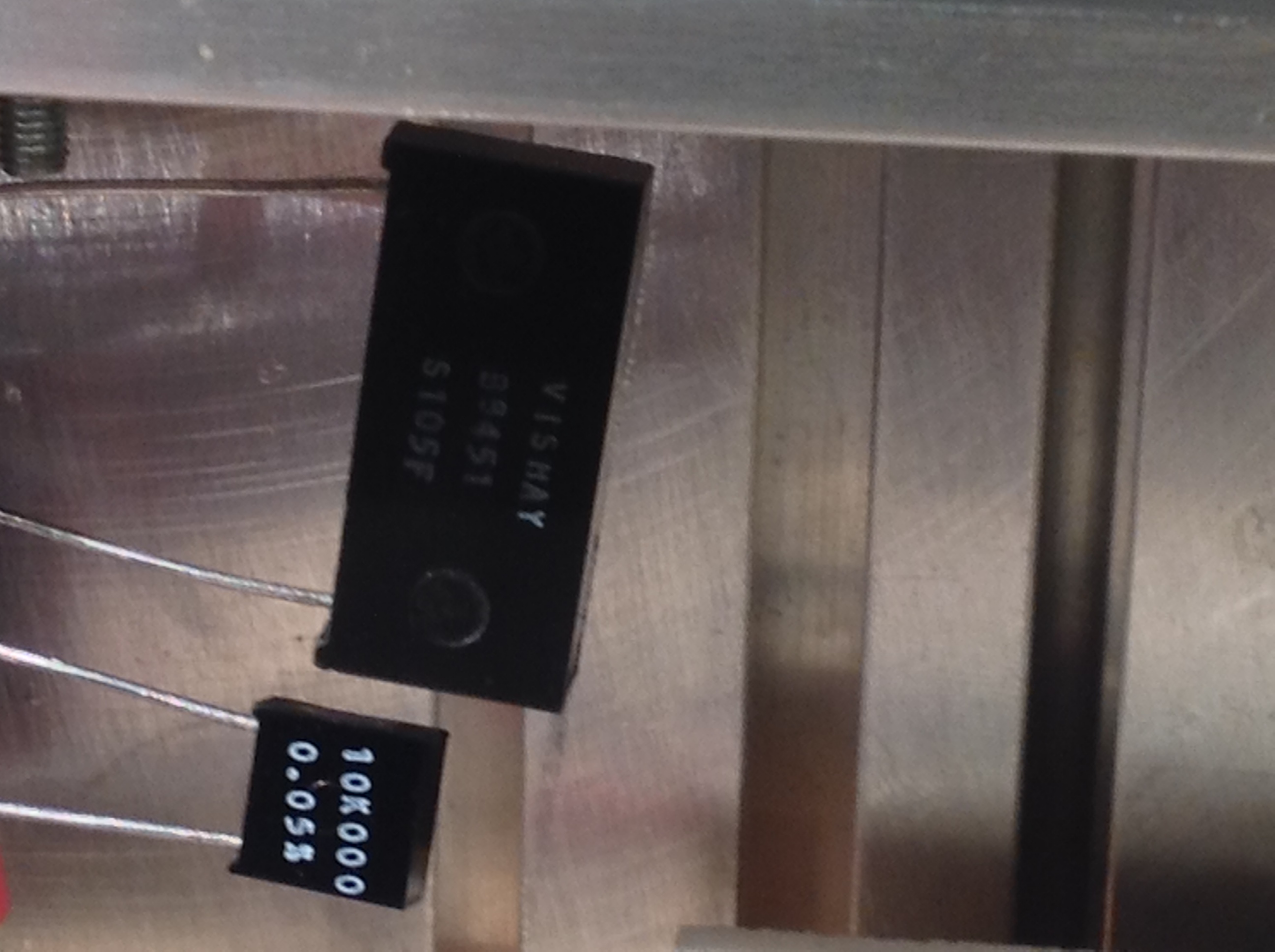

Conclusion : Mix with bulk foils resistor Vishay 10k and Mills 47R wire woud and input transformer in signal path. My TOP1:superman: :note:
Impresed by how single 47 resistor bring changes to the sound perception
in minimalistic system with full ranges : carbons, metal film et mox.
I know is crazy to repeat few the same records and soldering desoldering resistors and try to know what is the best choice.
Spend few long evening ´s of free time and was busy in testing of my new " little " horns as well.
Haha Plasnu now you bring me into L'Amp resistor load version, CCS wait too.
Have a good time 🙂

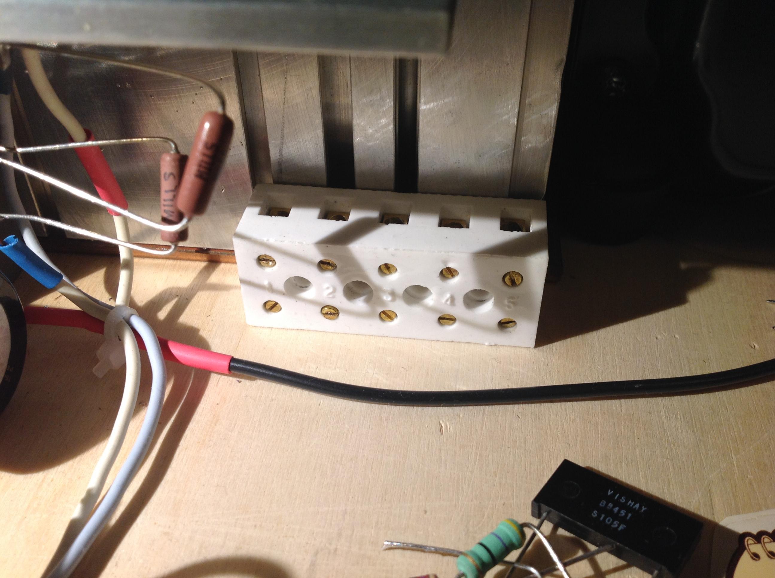

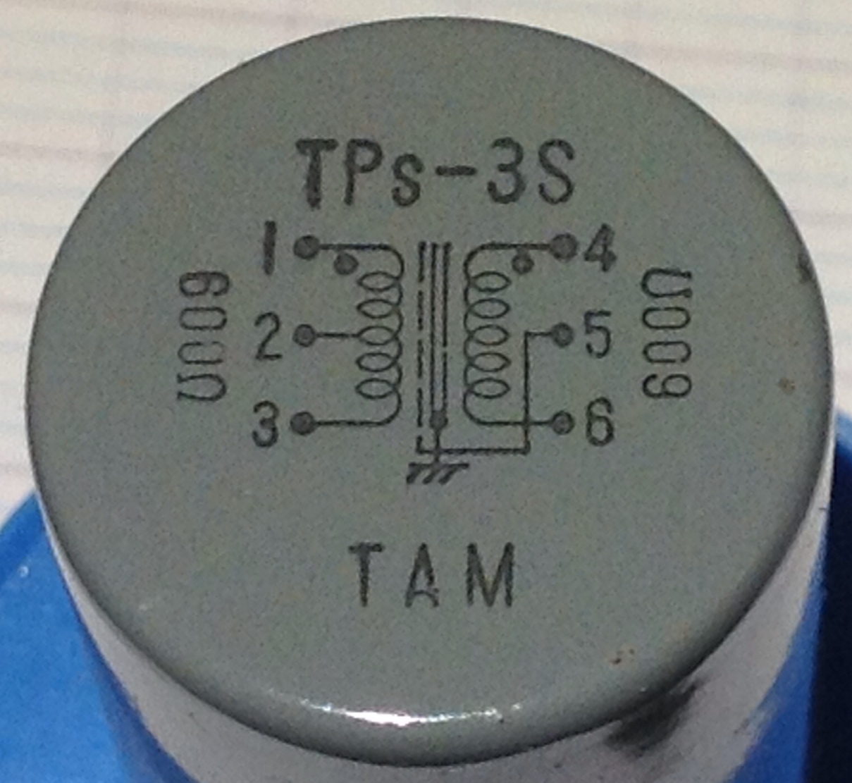

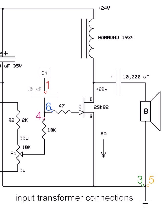

Do you connect the 47r and 10k to the transformer like this?
bias supply---10k---transformer---47R---2sk82
Yes 1,3 is my primary and 4,6 secondary. 5 is ground connection pin.
hahaha, I'm cheating with alligator clips. 😀
Yeah i was think make with the clips too
but if some disconnection happen that possible danger for the vfet.
I have confidence in solid soldered connection only 🙂

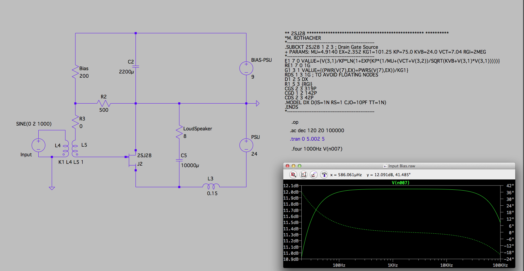

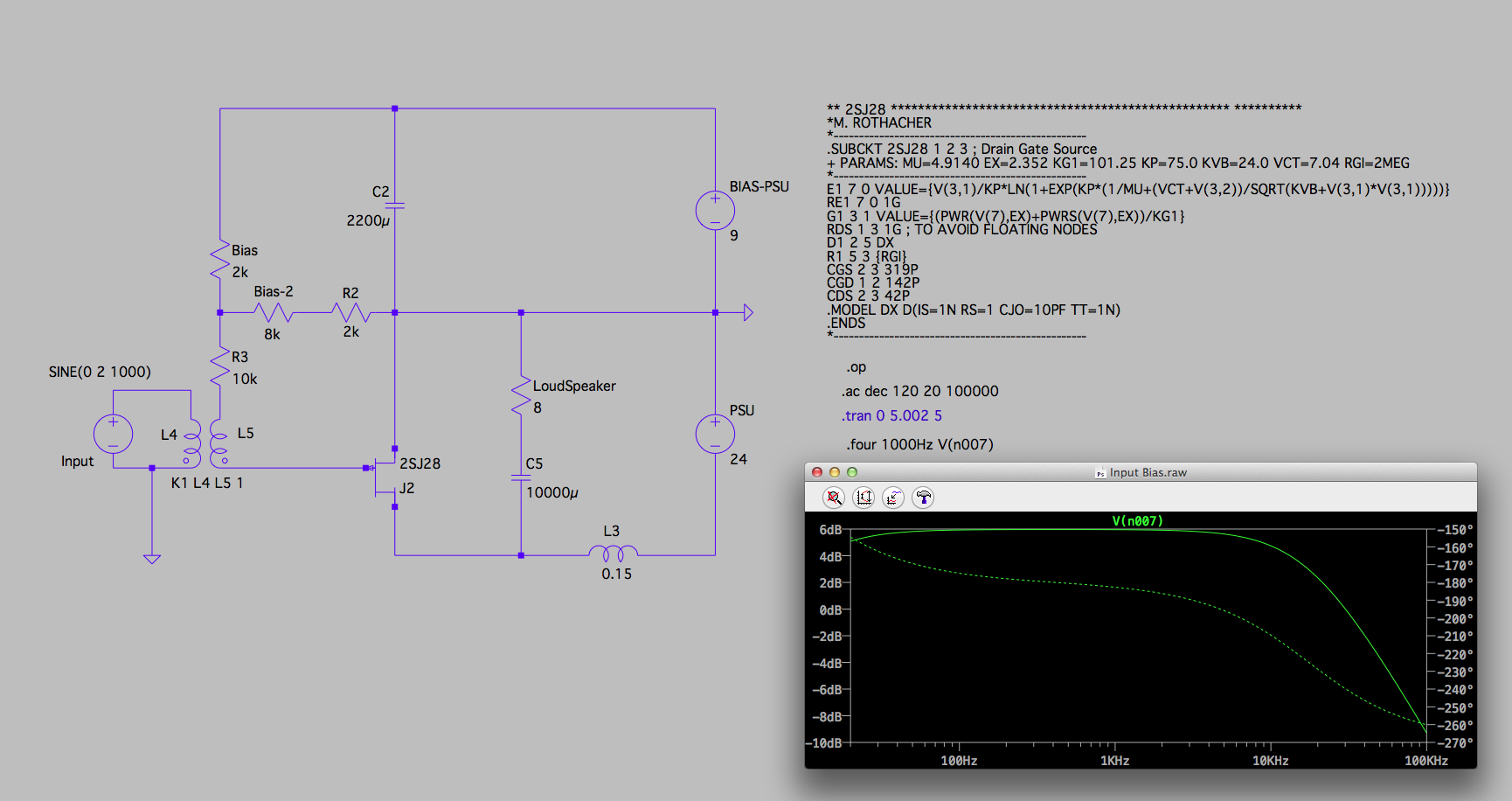

The first schematics is the simplified version of the bias scheme with 10K. It shows high frequency roll off, and I confirmed this symptom with actual amp. I changed the scheme to the second one, and the frequency plot is flatter, and I also confirmed this with actual amp.
My concern is, in the second scheme, C2 should affect the sound quality. One possible solution would be much higher bias supply voltage with 10K bias pot.
Please also check the LTSpice file attached. I may misunderstand something...
