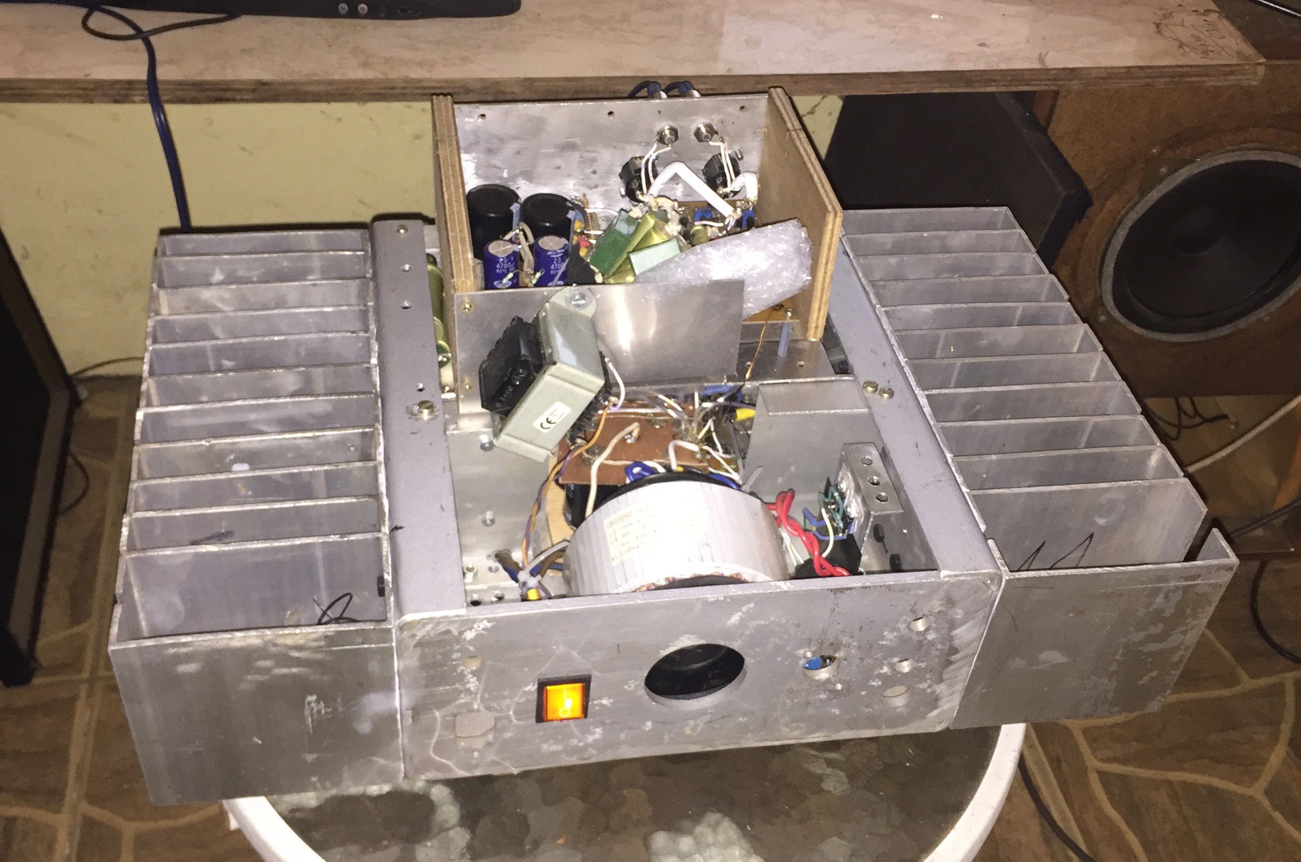

I unpacked the big ol' coil-o-wire amps today for one last listen.
I'm pretty shocked how well they move the JBL's. 🙂

I was going to cannibalize them, but they sound so good I'm having reservations.
DIYers dilemma. 🙂

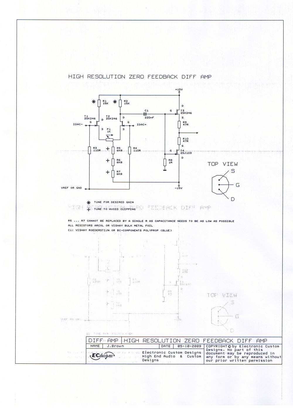

Weeks ago I made a very worthwhile upgrade to my "L'Amp without lamp" SK180: I installed a differential amplifier from -ECdesigns- (quick and dirty) with the needed mods, and the improvement is very significant, though you may say it is a different amp now.
It increased gain, which suits better my TVC, and has bal and unbal entries. Both sections have their own independent and regulated supply. Expect increases in dynamics, textures and detail in a way that it doesn't get congested with complex orchestral passages anymore. 😎
Sorry, I didn't find the complete and modded schematic.

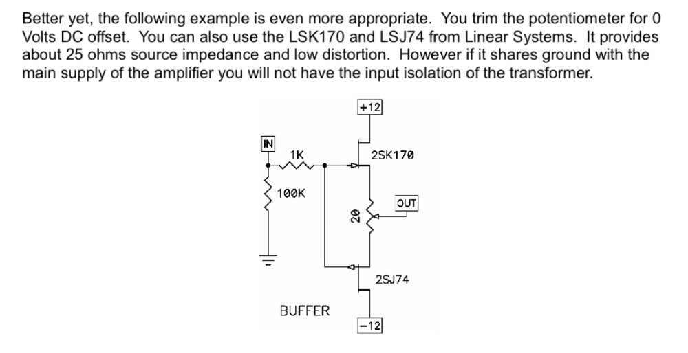

I remember Papa 25R jfet impedance buffer being simple to build.
You get more gain from 2SK180 that great feature.

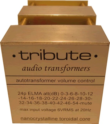

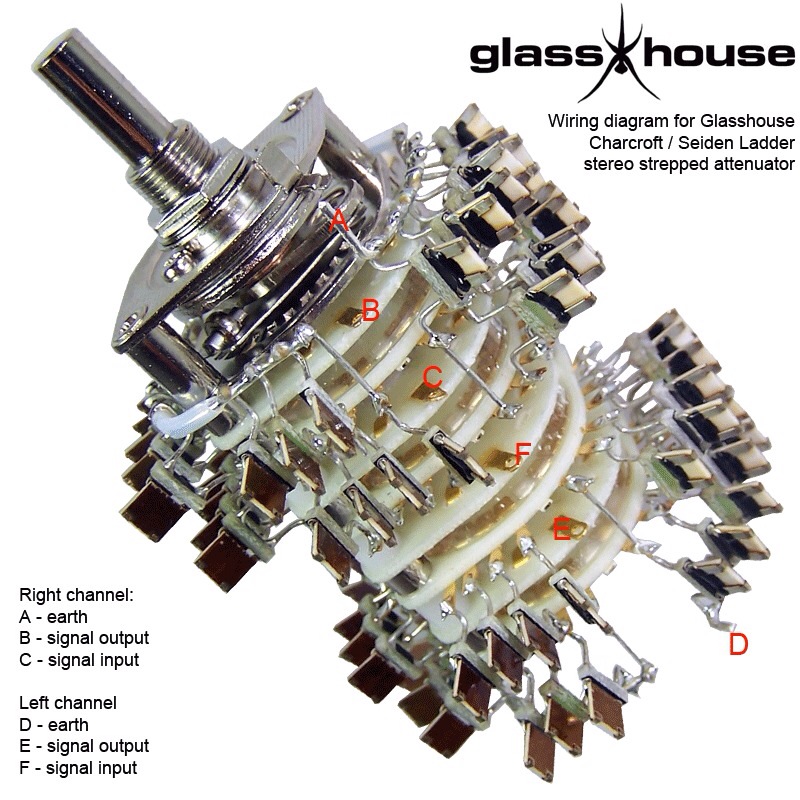

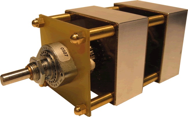

That gives you the possibility to use passive line stage:
potentiometer, stepped attenuator, autoformer volume control, light dependent resistor etc.

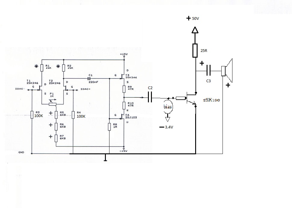

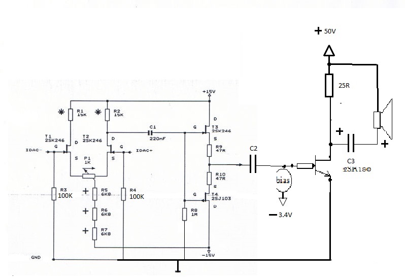

I found the schematics for those interested. I may bypass C1 when time allows.
Cheers.
M.
still better to connect common side of speaker to +50V

If I might offer an improvement- a constant current source instead of the resistors for the input section will improve the performance of the input section.Yes. It sound's like a 400W amp to me now 😀

I recommend a two-stage CCS- a single stage will leave performance on the table.

polarity of speaker is your choice
