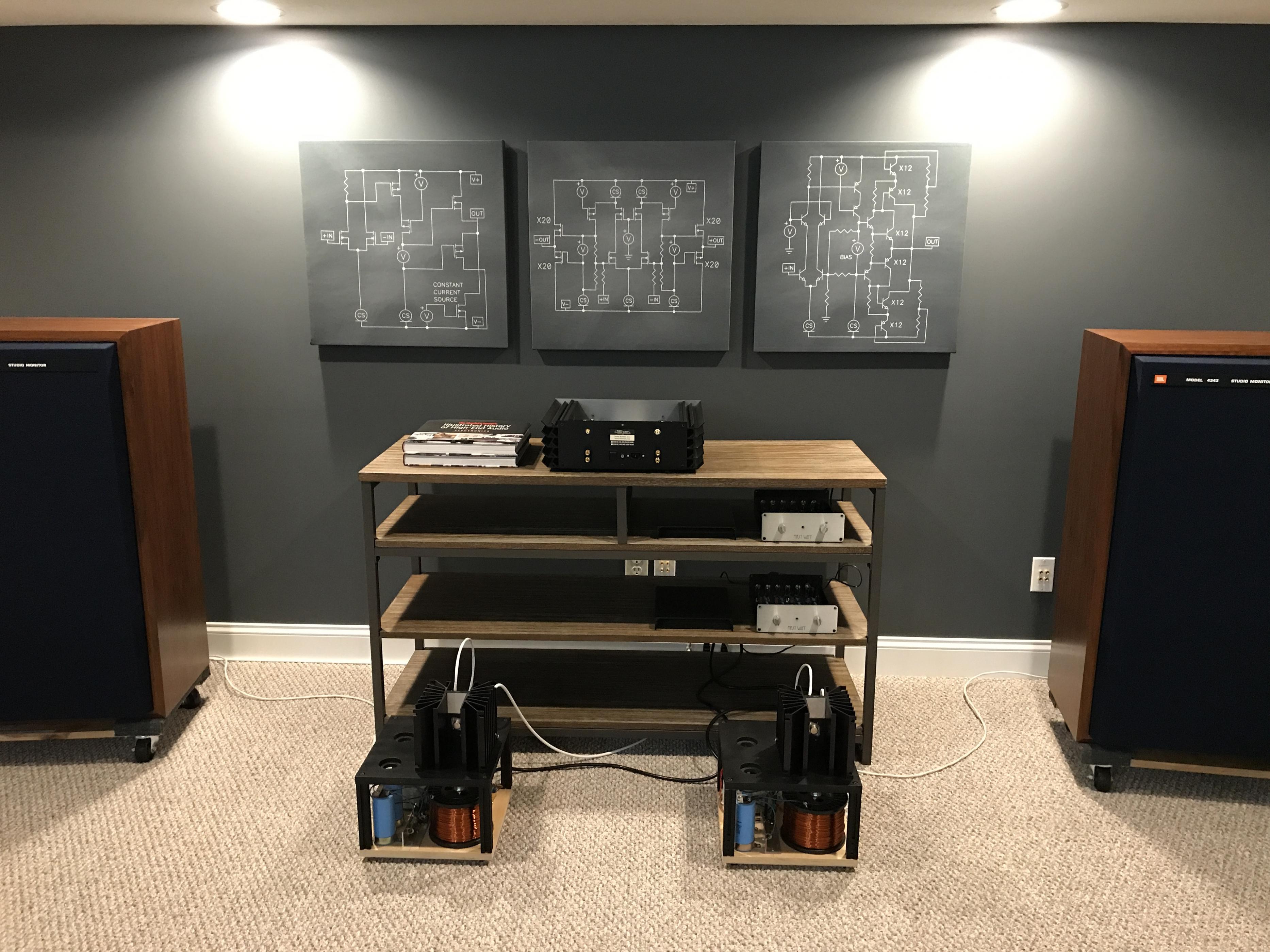

Can you please give specs on that coil of wire inductor? What is mH rating and DCR? Gauge and length of copper and dimensions of final spool windings. Very cool.
If memory serves, that's a 10 or 11 lb. spool of Essex 16ga, which works out to be 5 or 6 ohms and 100-120mH. 🙂

Like Micheal said a 10lb spool of # 16 wire will be about 100 to 120 mh and 5 to 6 ohms. I believe the 2 I have measure 5.3 ohms. But while that spool of wire does make a nice 100-120 mh inductor as it is the form factor is not all that good. In playing around with this program I calculated using a 2" coil form 1" long you may get almost 190mh from that 10 lb of wire and even that may not be the optium form. But I am too lazy to rewind my coils so will use them as is. Air Core Inductor Designer / Calculator
Might be tough to fit 10lbs (or even 5lbs) onto 2in dia x 1in long cylinder. I agree optimizations possible. Also, laminated and air gapped steel core can significantly enhance L value and keep linear within a certain range.
But there's something cool and over-the-top with a spool of wire as an inductor... 🙂
