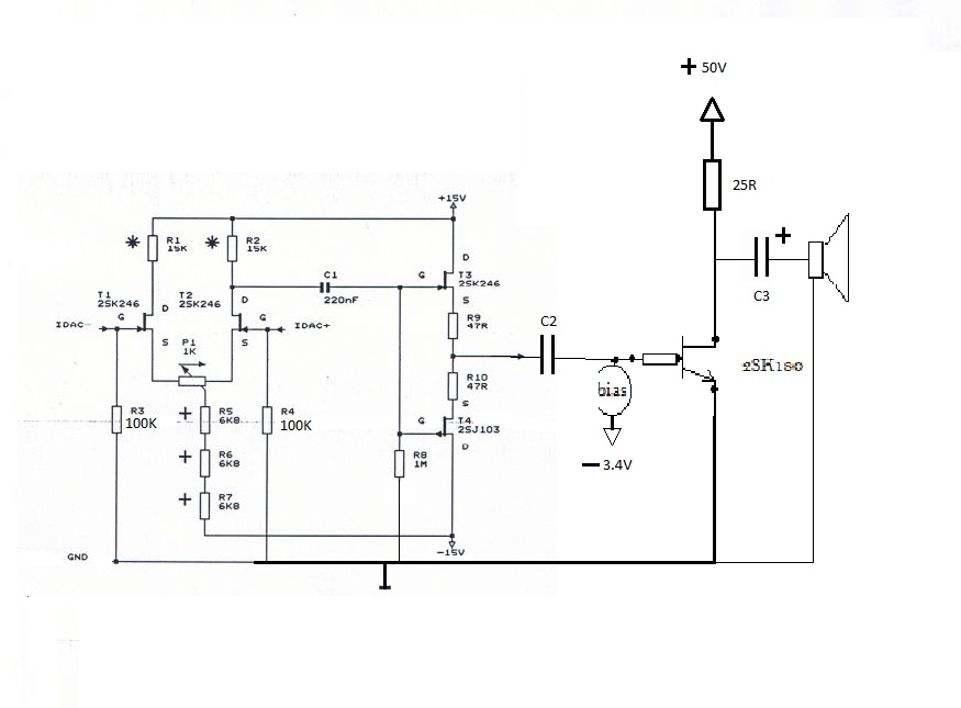

L' Amp style amps, while being wonderful, may be seen (at least I see) as starting points in the learning experience and I cannot avoid wondering about many experiments to be done, like CCS, cascoded CCS, cascoded VFET, which are some of the steps to add to my already modded amp.
I have been using my Tokin amp with a differential amplifier for the input and it really improved a lot.

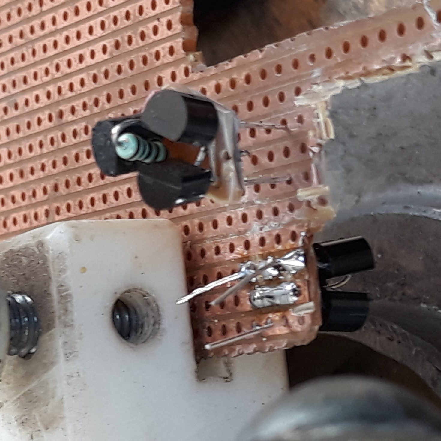

As some may know, I am experimenting with Peufeu's recommendations for diminishing (putative) thermal memory distortion effects, like the cascoded-CFP input pair. Well, yesterday I replaced the input pair differential with a "cascoded-compound CFP" pair of units, using Toshiba's SK170 as both, the cascodying element and as the "driver" of the CFP pair and a BC560 PNP as the "emitter follower" of the pair, with a 1K resistance on its emitter. I confess I studied some academic articles about this compound Szicklai but they were too much for me, so I took the plunge as the good Lord seemed to advice me...and it worked! :D
First listening tests are very encouraging. :cool:
I attach picture of the cascode-compound CFP units and a diagram of the target amp...
I hope you like it.
M.

Good work!
If you put a 2 stage constant current source where R5-R7 are, the performance will be even better. That will probably also allow you to get rid of the balancing pot (which degrades the differential effect) as well.
Thanks!
The amp is sounding glorious. It does not collapse with complex music. Lots of microdetail and great textures and timbral accuracy.
The resistor tail was chosen by the designer for better sonics.
If I were to remove it, I would experiment with cascoded CCS. Is that what you refer to with "2 stage"?
The balancing pot equilibrates the currents. I don't understand what you meant... :confused:
This cascoded-CFP mod is a great discovery. I am modifying all my circuits with them.
