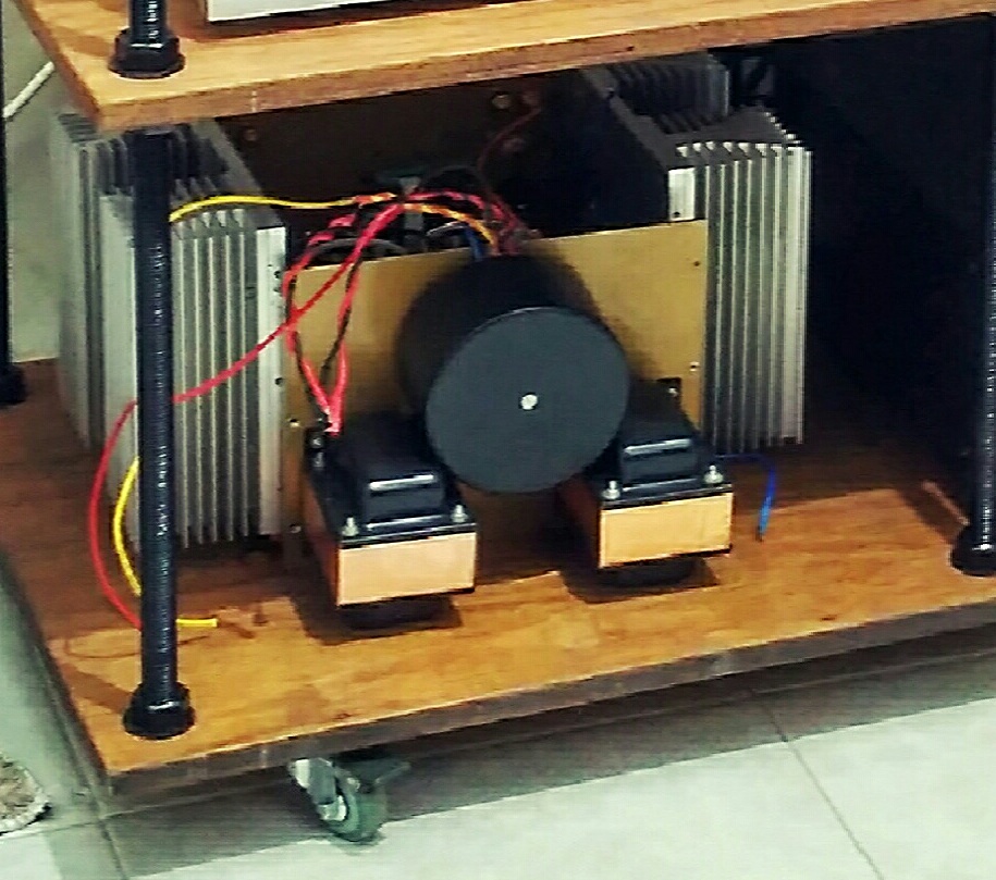

you just reminded me on my abandoned SIT L'amp, changing layout toroid and choke which is side by side with rca and speaker connector. it should be moved from back plate to front plate in order to reduce hum, but still not finished yet.
only need to finished recabling and final touch 🙄

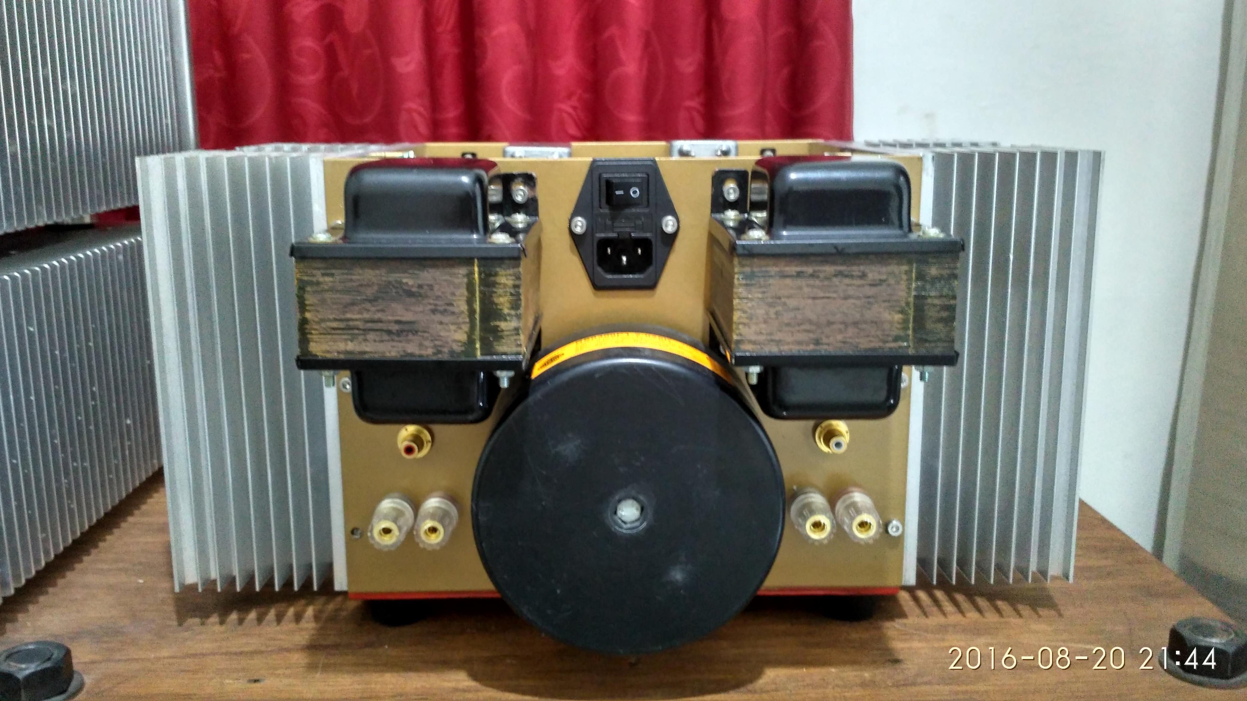

Back to Inductor L'Amp :
distance with psu toroid and audio signal wires with shield is probably necessairy.
Your toroid have shield can but with magnetic sensible circuit parts
we must use all protection to keep them quiet for best pleasure with music art.

my toroid is not shield, it's just encapsulated in resin within plastic case, my previous layout created a little hum when no music played.

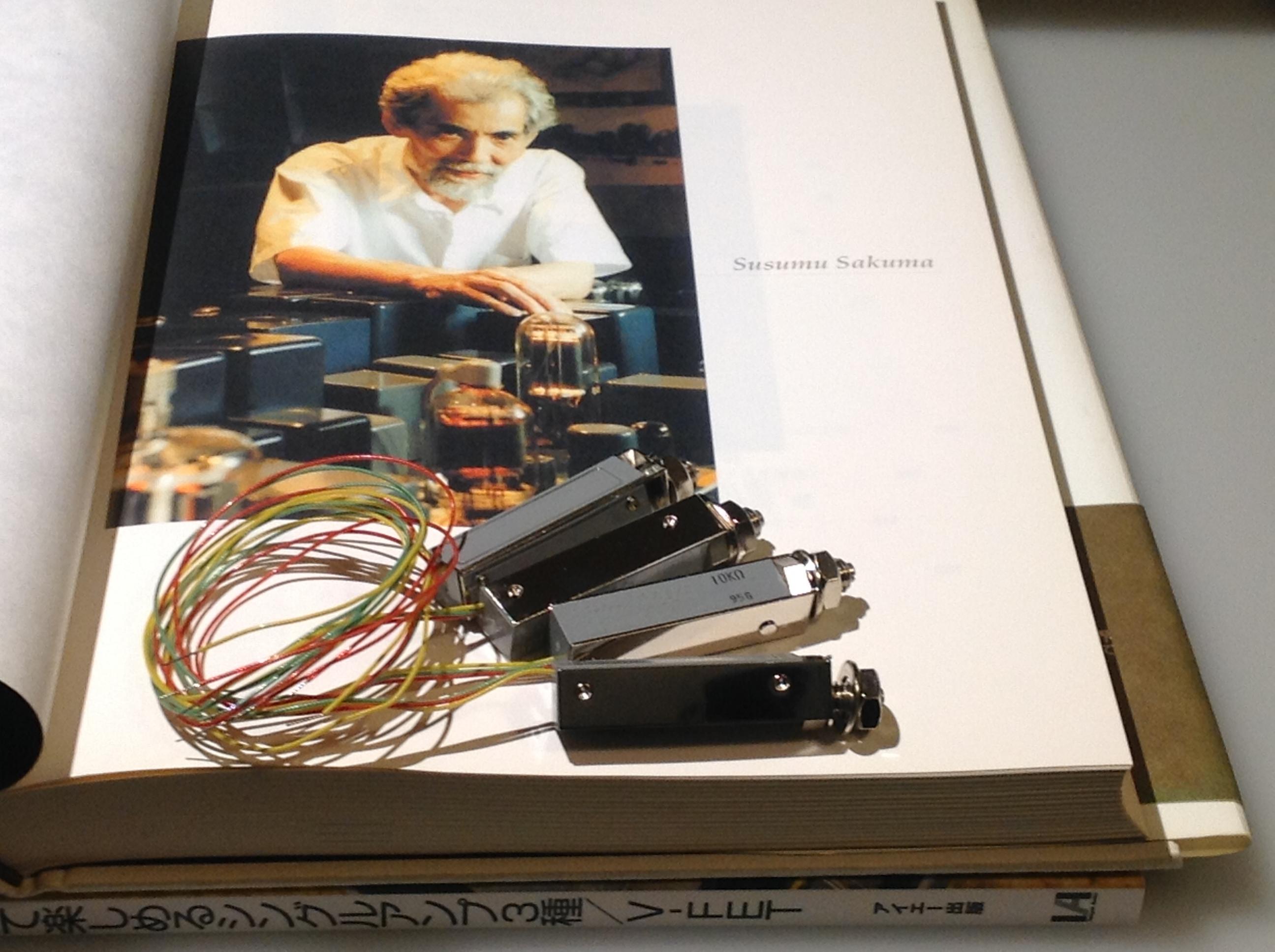

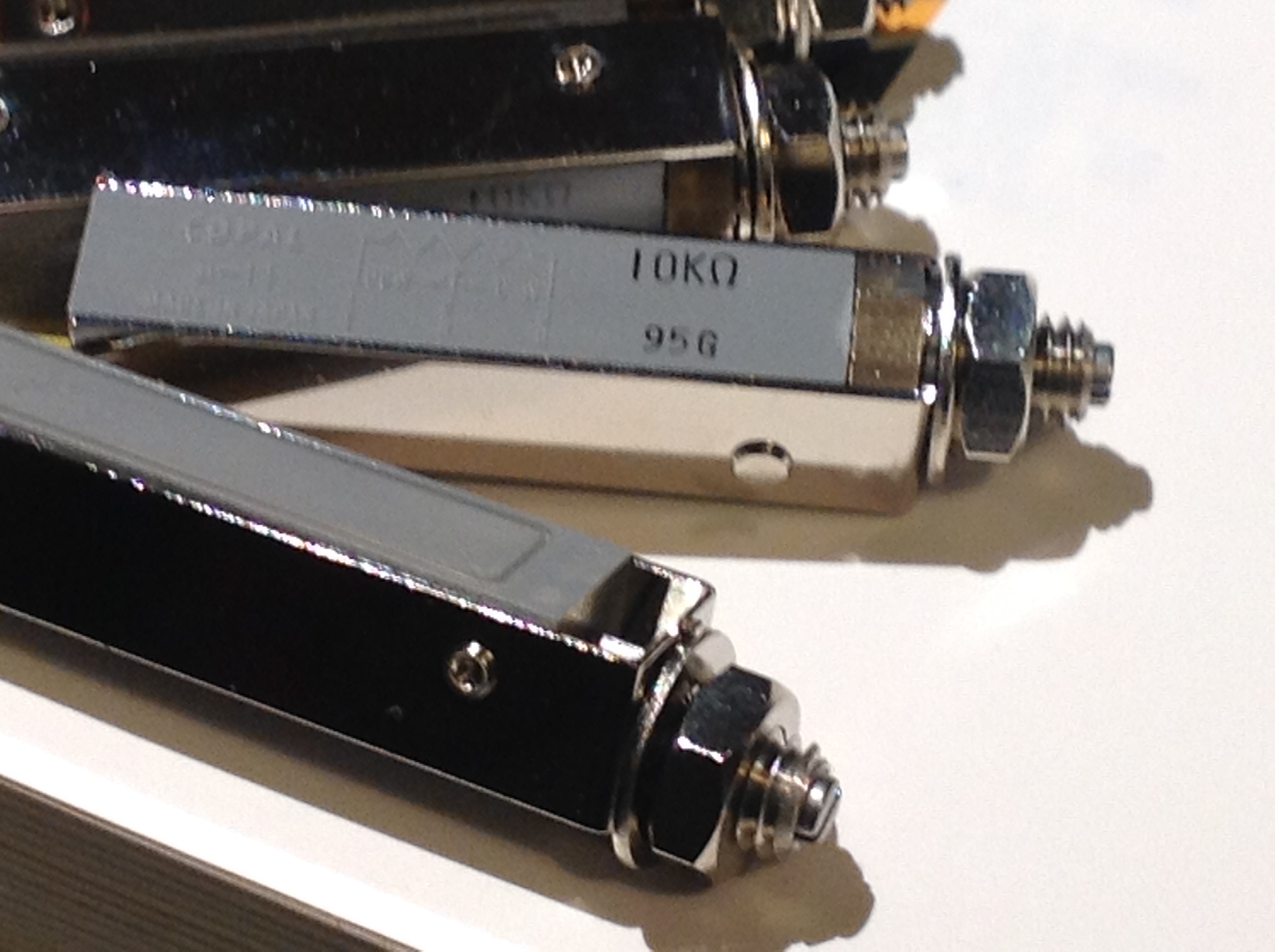

Received today fews 10 K Copal wire wound trimmers for prototype point to point Inductor L'Amp.
I do start this week-end , first with bipolar 10 uF Nichicon Muse input cap , after that polypro MKP or paper in oil.
Experiments to find sing Rickie Lee Jones with magic sensual voice 🙂
