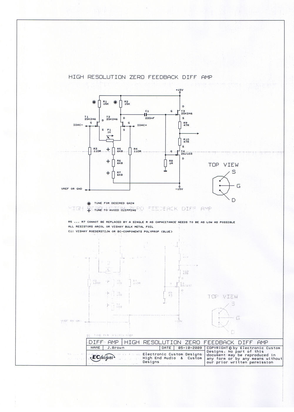

I finished one channel of my new 2SK180 single ended amp (conventional R load) using linear supply instead of SMPS with one trafo that was lying there unused. After power regulation, B+ is lower than planned initially (80VDC) at +58VDC. Once the other regulator is finished, I will play with the currents. I may add a front end to it to be able to get the full power. Since I use a TVC as "preamp" I can adapt a discrete differential amplifier (from -ECdesigns-) from another project (B1 based crossover) and play with the gain for optimal function. I bet that will teach me a lot... 🙂 Please see the attachment and tell me what you think.
Thank you very much.

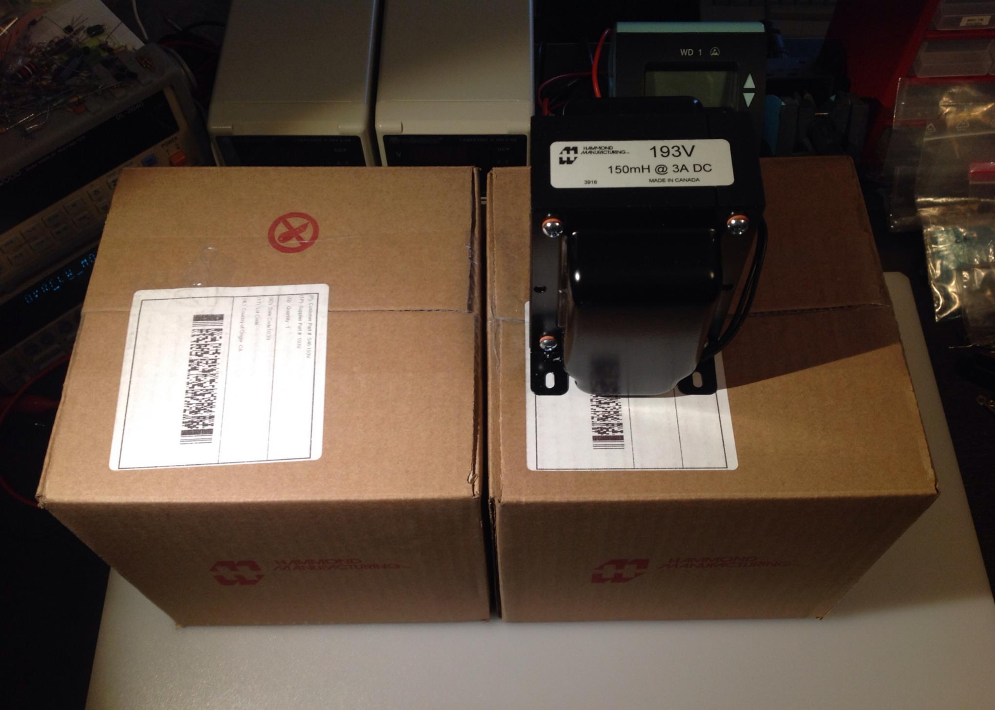

Inductance test's match all spec.
Two chokes weight alone ~ 9kg ~ 19.8 lb.
Perfect for cute mono block's ,
stereo amp can be to much
