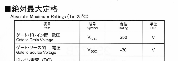

I might be doing a poor job of wording on this puzzler, so here's what I was after:
Max VGS for the 2SK77B is -30V. The zener here is a voltage clamp.
Do we know the Max VGS for the 2SK82?

Perhaps Uncle Mike can comment on this. With a CCS, the current is limited
by design so things should be ok.
With inductor loading, I suspect there's not enough resistance for current limiting so one would
want to ensure the bias voltage to be up before and stays up after the main rail.
Would this be correct?
