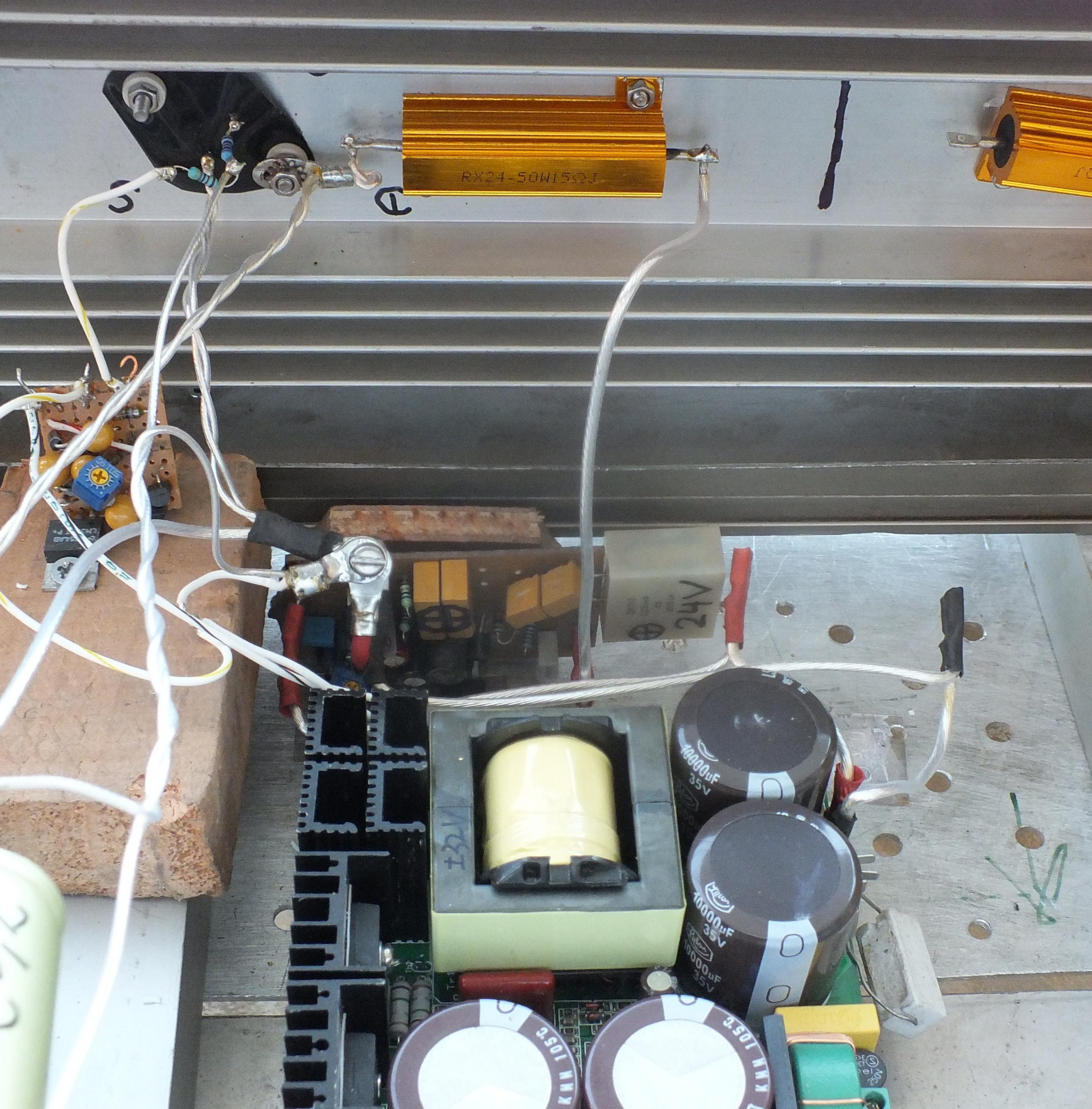

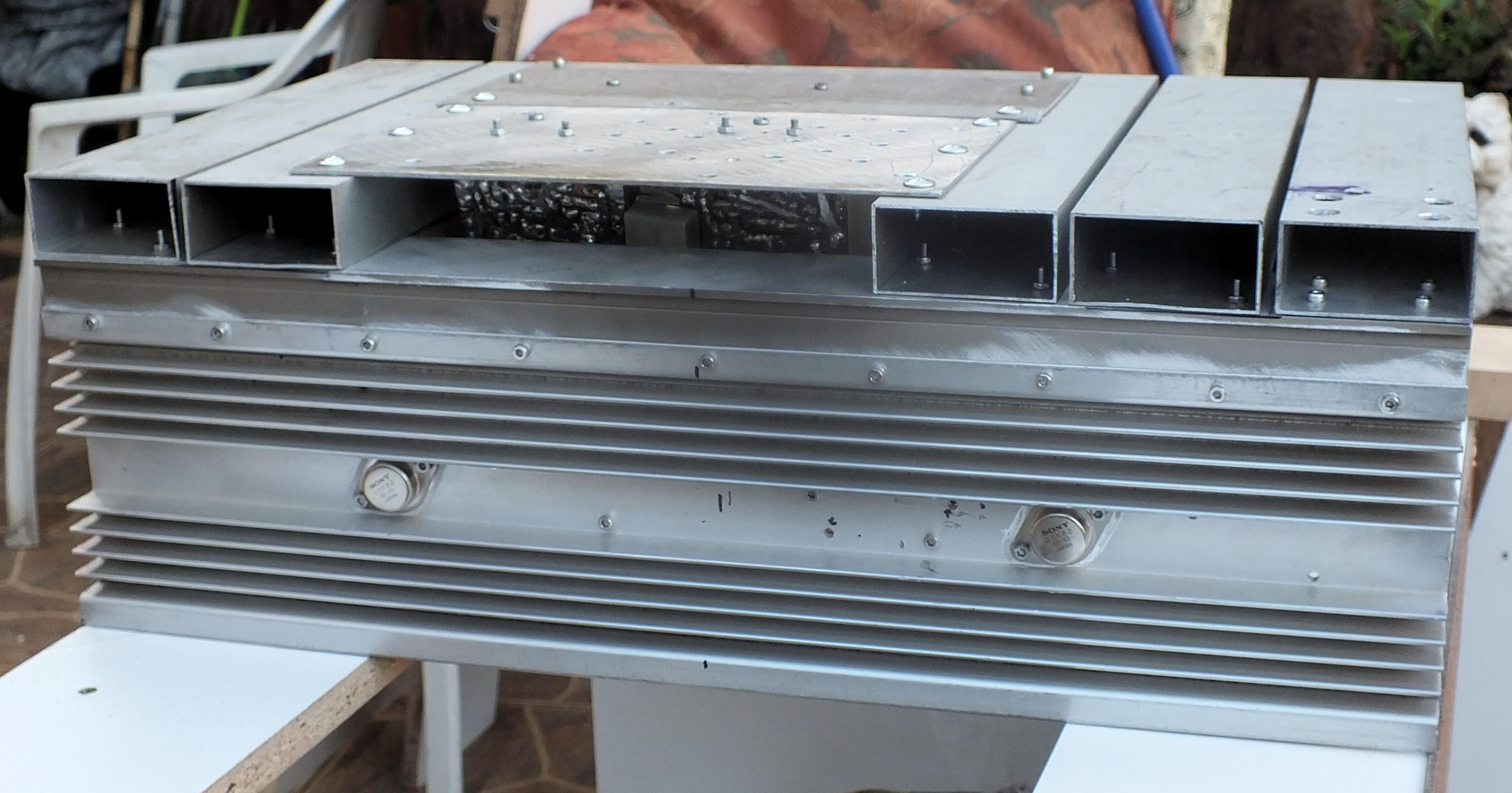

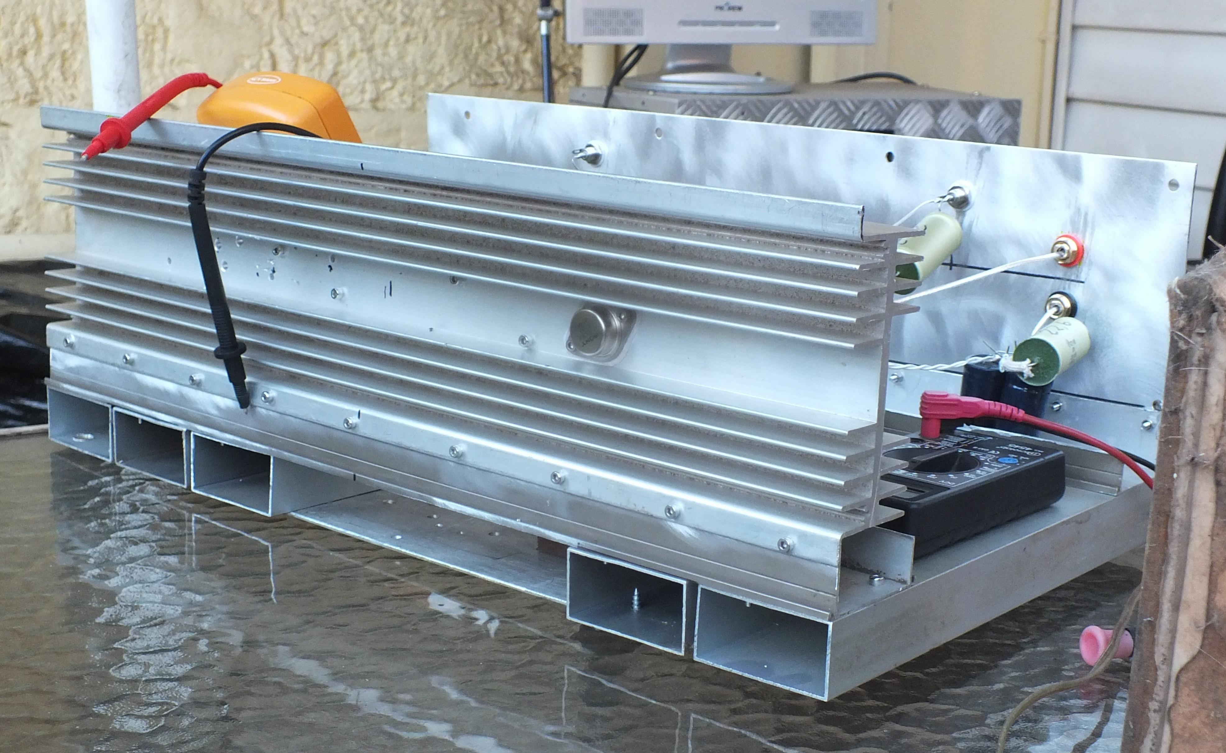

Finally, I had the time to build a SIT amp, a single ended 2SK82 but with Rload (15Ohm) instead of bulb. No Rsource. One channel for now. I am making a box with left overs, as you can see on the picture. It can go upside down (w/r to the picture) or upright for a strong chimney effect..
I decided on an inexpensive SMPS from Connex further regulated with PowerReg from Teddy Pardo, for various reasons, including cost, weight, efficiency, nice security traits, added auxiliary supply (+/- 12VDC, for bias control--> variable TeddyReg), and because it was lying there...
No noises, pops or hum whatsoever; just nice Music. The Regs do a delayed, gradual startup (fortunately the (-)bias Reg seems a little faster) and the final Voltages I chose are: V(+)= 26.7V; VDS= 12V; Vbias= (-)4.1V. so around only 1 amp at iddle, I guess.
Fortunately it rides well my Audio Nirvana super10 on downsized 2:3 Autograph corner speakers.
Anyway, I perhaps will try to increase bias current to the recommended around 2amps. What to do? Reduce Rload or increase V supply? Add CCS or a big choke? No, better not a big choke.

I'd increase the supply voltage next.
Thank you Michael.
I can't afford to loose gain, so increasing VDD seams the right way. More heat though. What would be reasonable VDD and VDS for the SK82?
Of course the answer depends on what the constraints (what we're not allowed to change) are, and there are many acceptable load lines to pursue, but looking at figure 10 in the original article, let's guess we want 13-14V across the SIT, with Iq in the area of 2.3-2.6A. Your resistor is 15 Ohms, so supply range will be 47-53V and your SIT will be dissipating between 30 and 37 watts.

Thank you very much. That's what I thought and for that I will need another SMPS and to parallel Rload resistors to cope with heat...in that scenario, if I increase total Rload I could have more gain, sacrificing distortion figures a little, right? I will take another look at the article.

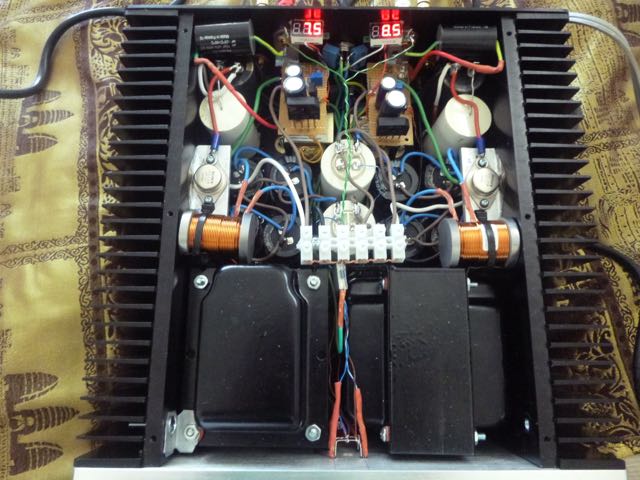

Final build. Reduced the buzz/hum I had by rotating one of the chokes and re-configuring my star earth setup. Inductors on the powersupply rails instead of the 1W resistors also seemed to clear up general noise and made the sound a bit quieter overall. Very happy with this.....

Yesterday I added the second channel successfully
Even with a chip volume control it sounds great. Bass instruments get great articulation and harmonic content.

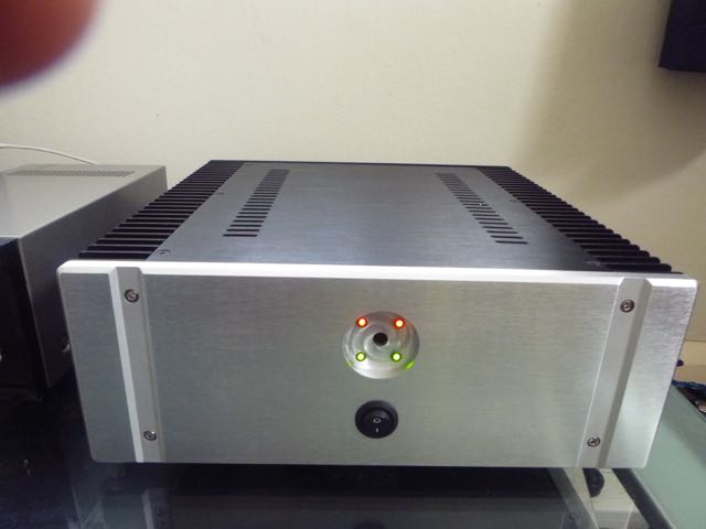

Here's my lightweigth amp.
I recorded a couple of videos. See my signature. Unfortunately, mic's camera is not good.
They demonstrate that SMPS plus power regulator based single ended amp is feasible.
