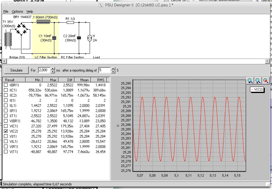

do you know PSUD2 ? it´s a very smart little piece of software, i play
with much too much.
i´ve done a quick simulation for a LCRC-Filter with the Hammond 159ZC
that should work for you.

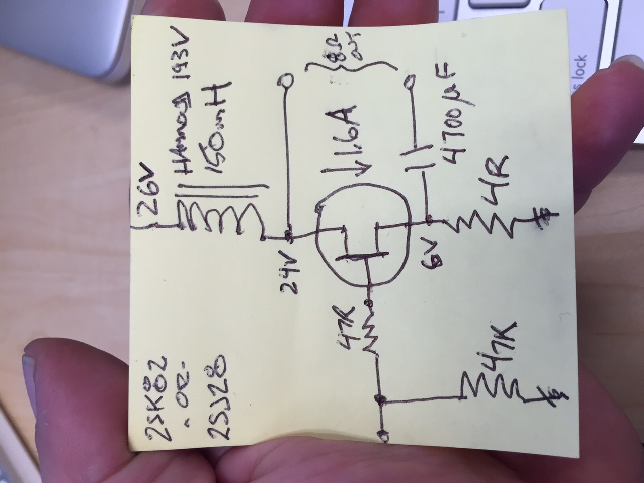

In experimenting with complementary topologies I managed to kill a 2SK82/2SJ28 pair. If anyone has a spare pair or even just a single 2SK82 to spare please PM me.

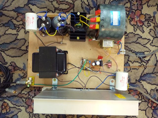

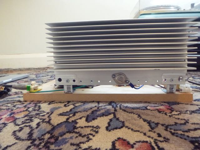

Thanks for your help guys and sorry for the dumb questions. My 2SJ28 prototype is up and running and I dont seem to be running out of grunt! It is louder than I expected. Running at 2 amps and so far the temperature after about 30mins hasnt exceeded 50 deg C. Sounds FAB! Pics of the Frankenfurter build are attached.
Amazing res. Its only powering one Fe206 Fostex in OB configuration - (I am using an Eminence Delta to run the bottom end, powered by an Accuphase P300) however I am getting more bottom end from the Fostex alone than I ever have before. This amp even sounds better than my restored Pioneer M22 - my previous fave! What a great machine.
I'm about to order a case from China to house 2 channels of the glorious 2SJ28 amplifier. Cant wait...

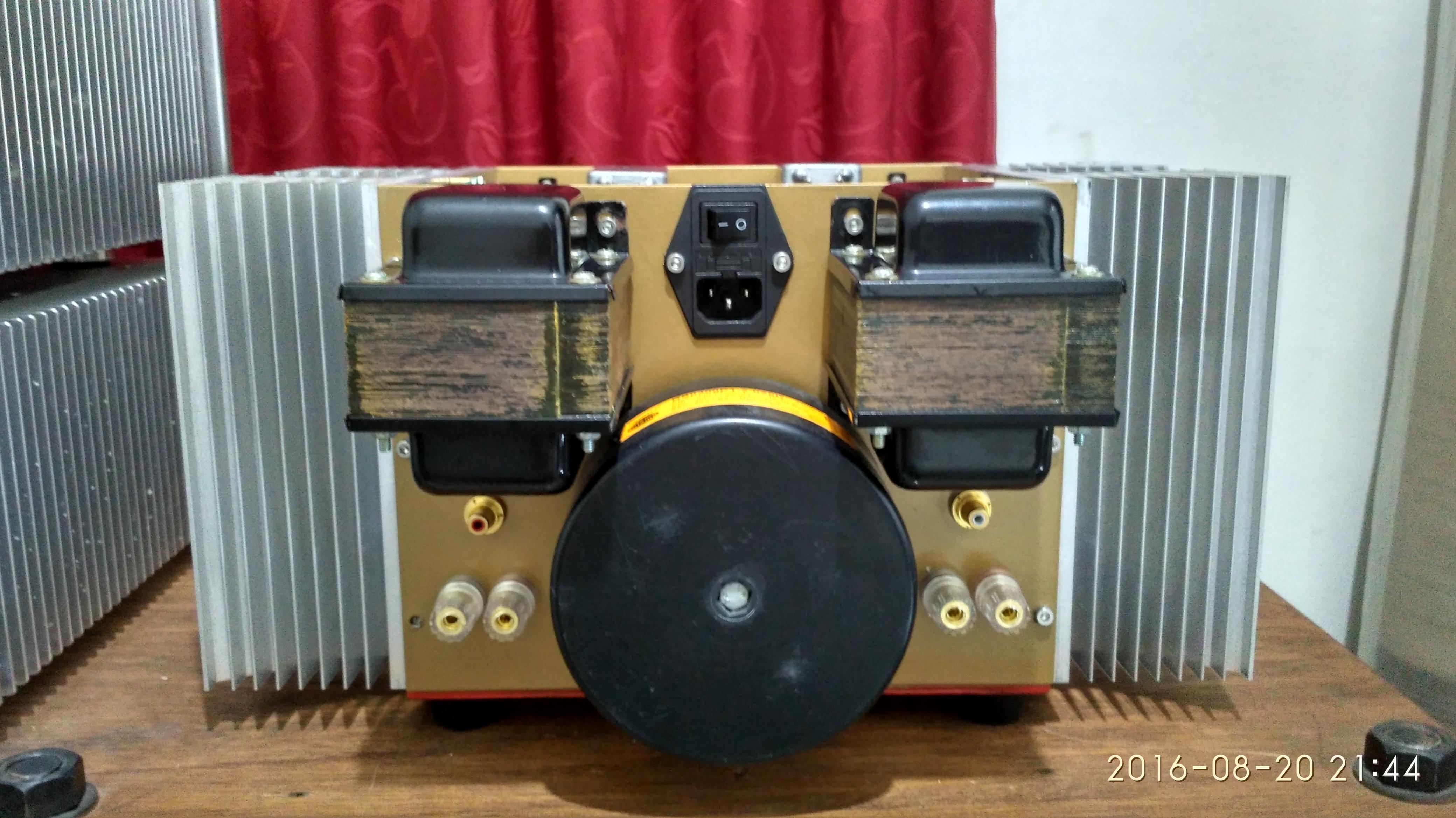

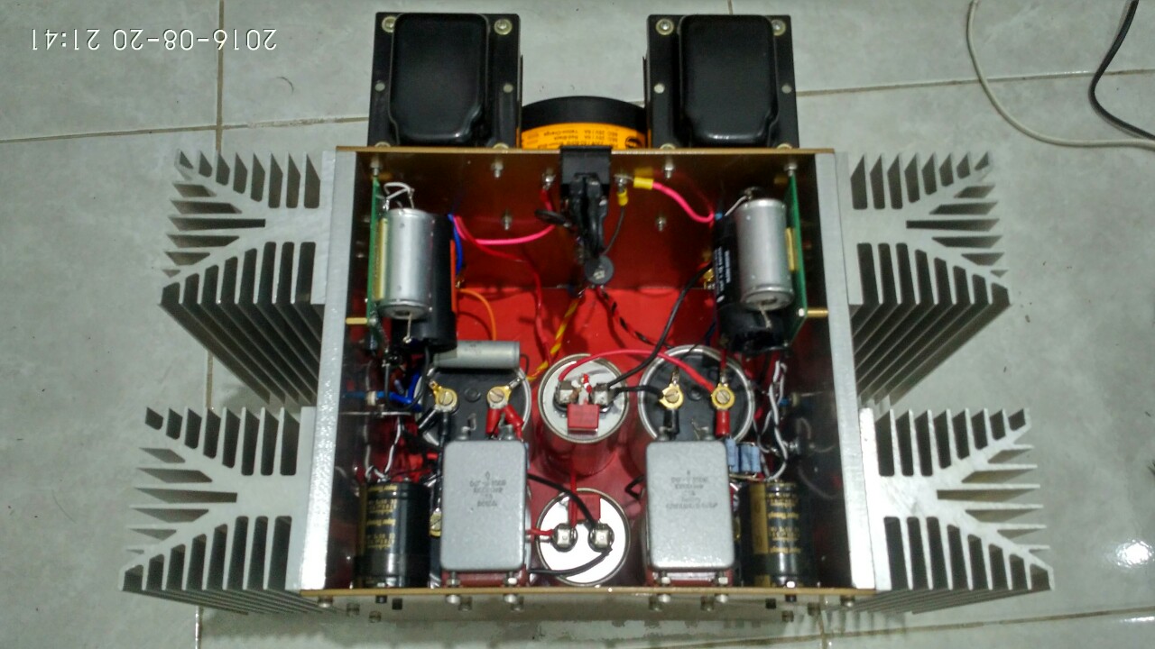

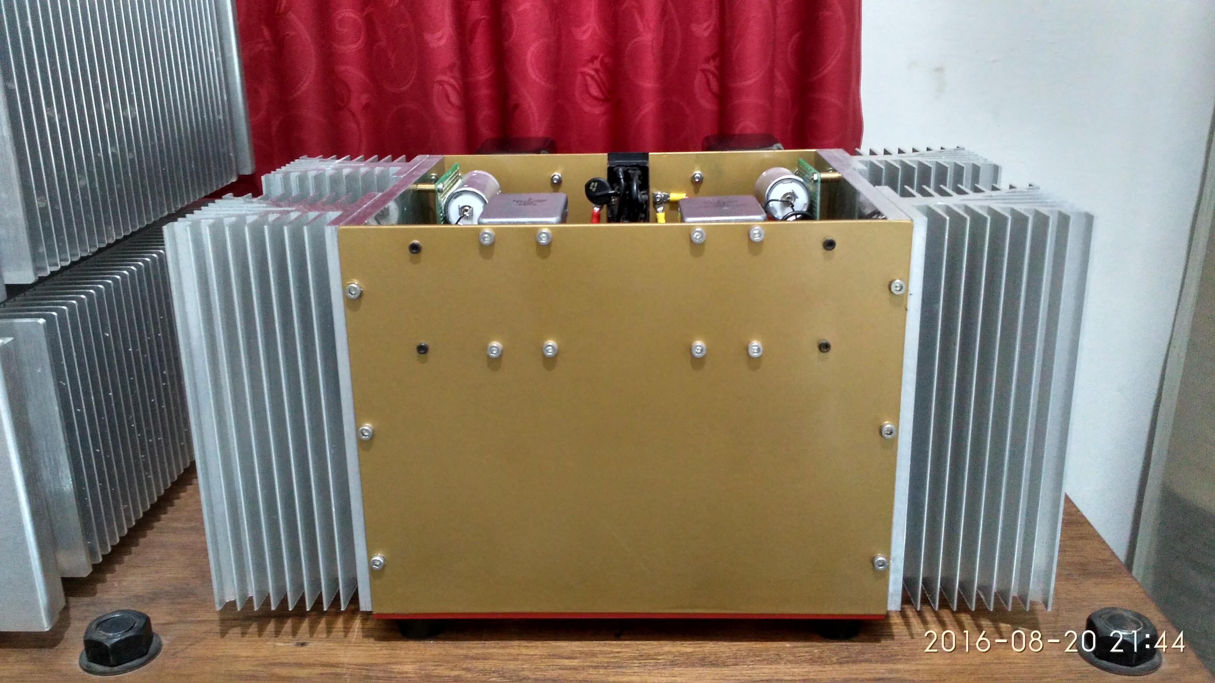

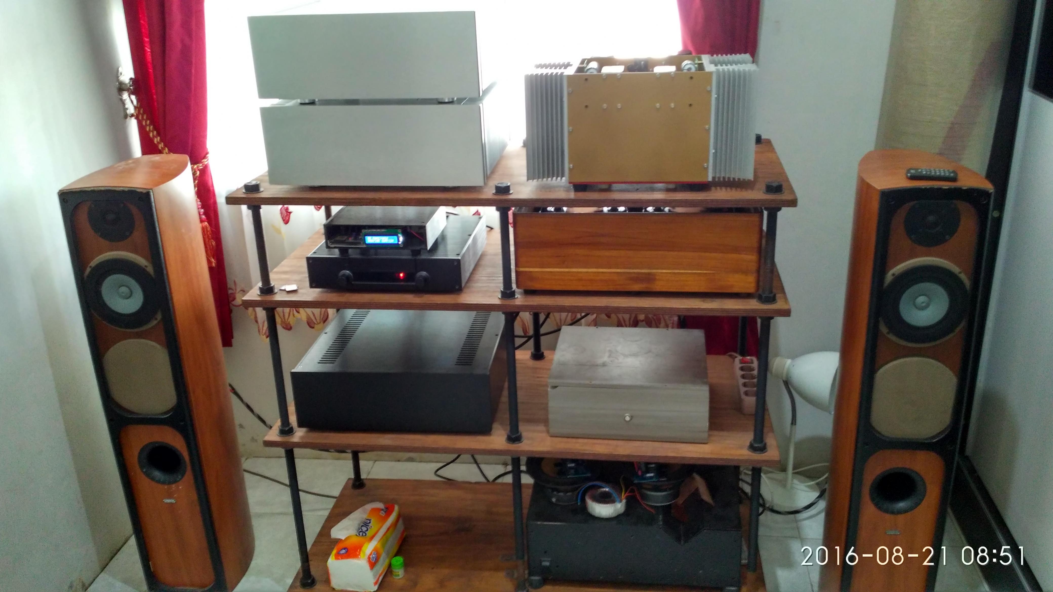

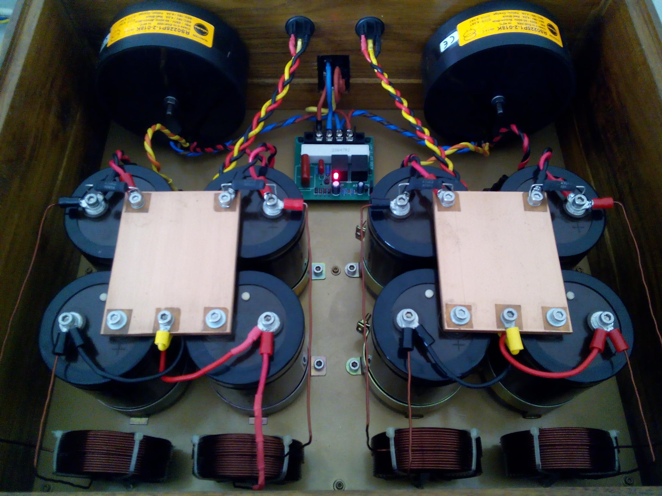

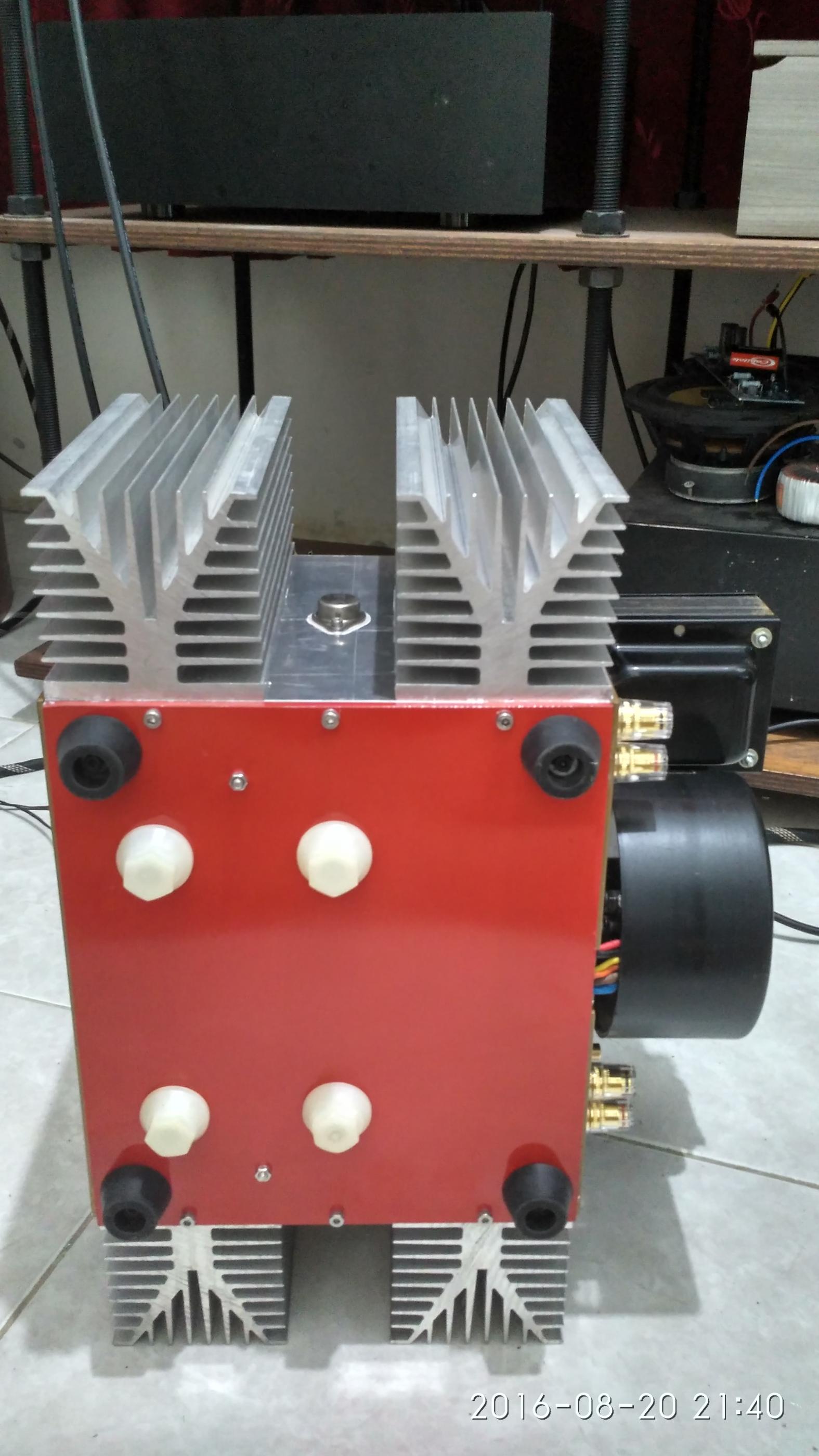

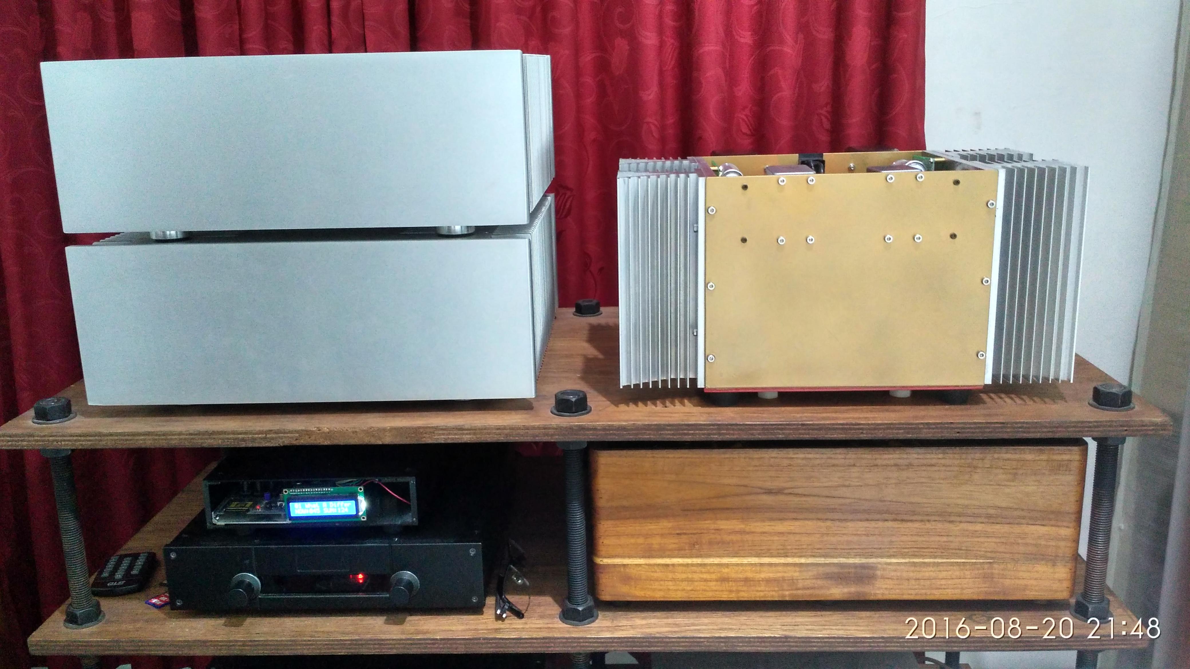

just completed my stereo SIT L'amp self bias, it's the most ambitious of my project since i build the chassis on my own. I'm really satisfied with it's sound, the best part of it is it's huge soundstage compared to my other Papa clone. I keep on smiling for listening to this amplifier, only run it for 1hr. Thanks to MR for the great SIT adventure and OP who give this self bias design (cant remember who posted it)
I'm using 2x25V 300VA toroid, with Rk 2x8R paralel caddock resistor resulting 7V bias and 25Vds
one is never enough, but 3 class a should be enough for me 🙂 this will be my last amplifier journey, Luminaria parts is waiting to be completed, will be 2nd preamp after dcb1. next journey will be speaker building

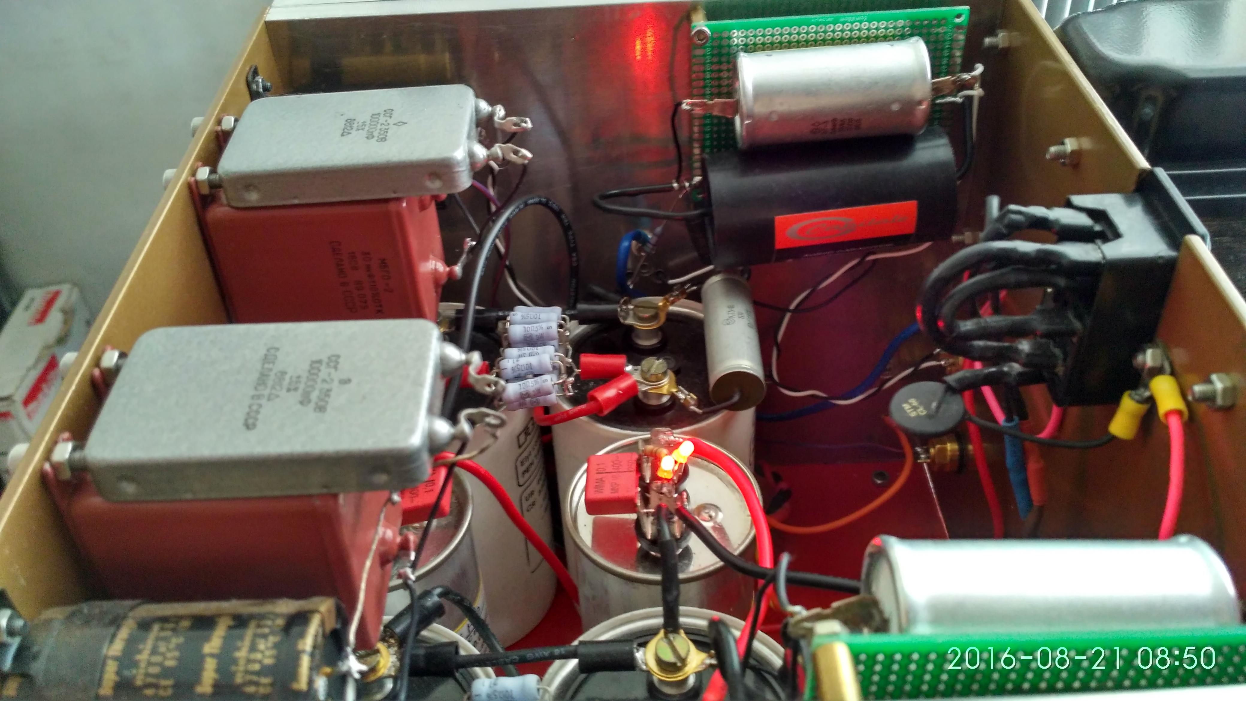

Looks good - Are you doing the "pseudo-parafeed" trick of returning the speaker through cap to the source/resistor junction? If so, what value cap are you using? Driving what speakers?

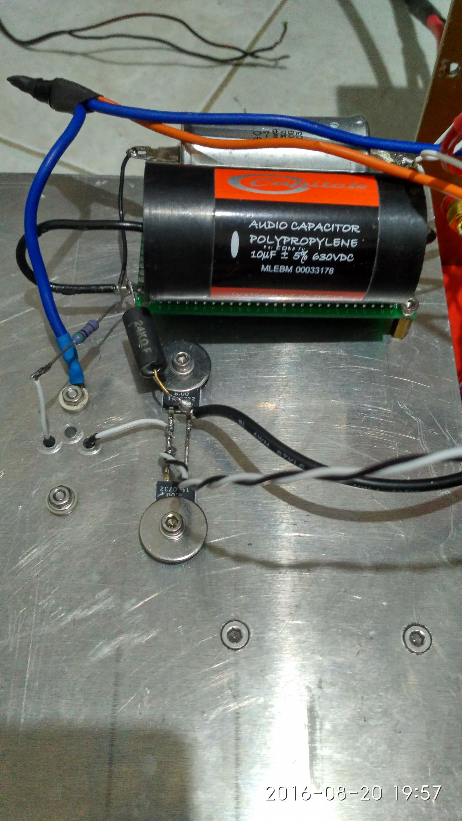

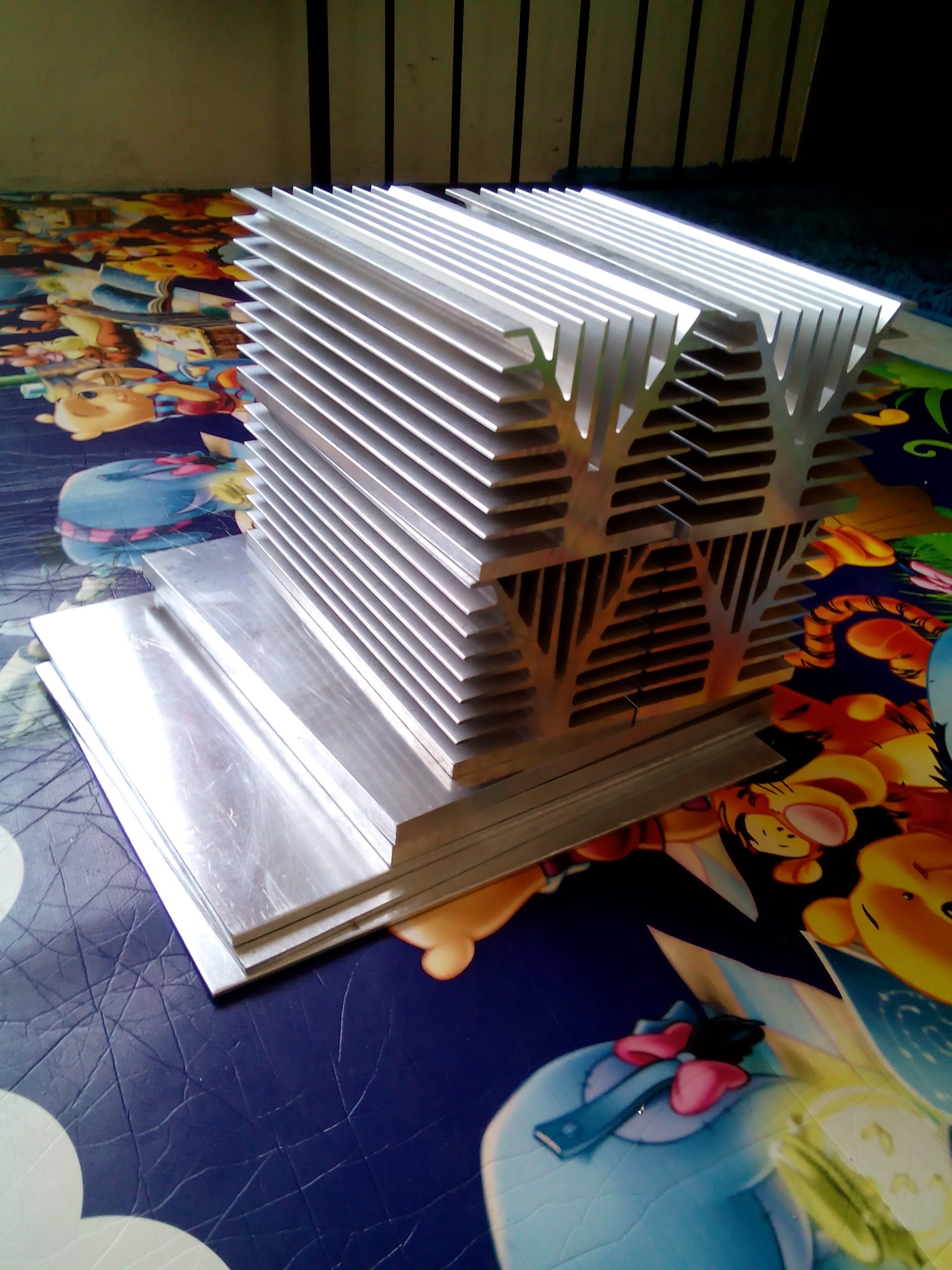

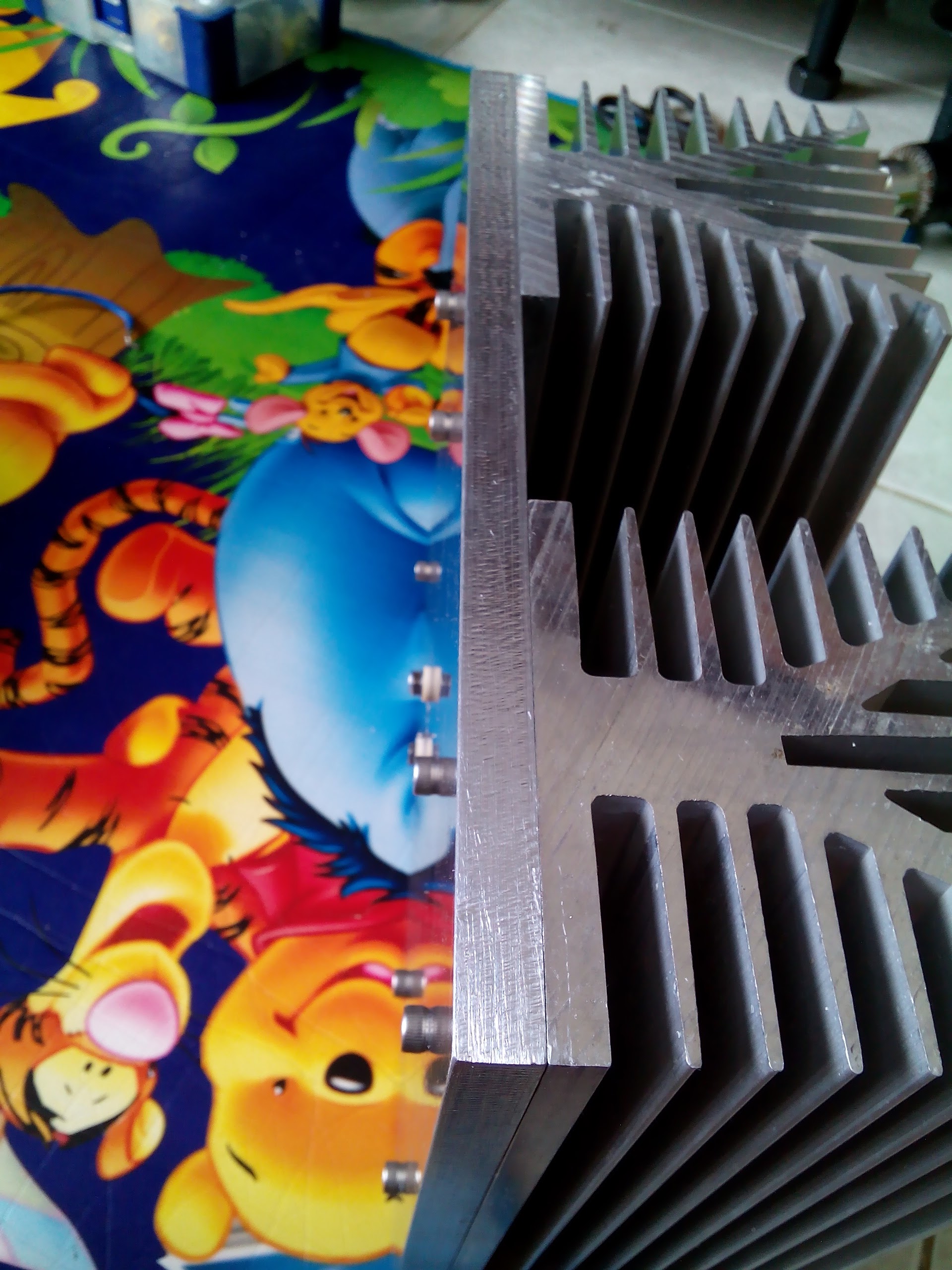

base plate is 5mm, front and rear 3mm, HS is attached on 10mm plate. When I buy the plate, i give extra 5cm from my desired layout. to get a precise cut, I find nearby workshop with giant machine which can cut metal plat up to 6mm, its like a huge 3m scissor. What I need to do is to make a perfect rectangular line to be cut. for 10mm plate, I also find milling workshop which cut nicely. I find cutting tolerance is less than 0.5mm.gadut how work this creative heatsink ?

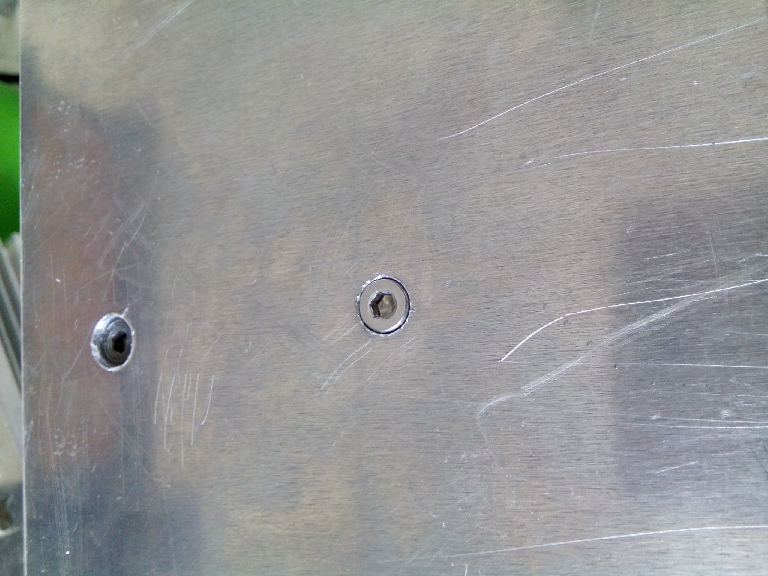

The hardest part is to make a precise drill on the plate and tap each of them, I only have hand drill and hand tap. with alot of practice, all plate can be aligned. if you have drill press will be alot better
yes I use your schematic, CRC psu with C rifa 33mF - 10x paralel 1R 3W, last C is bypassed by 60uF motor run cap. choke is 300mH 3A 1.8Rdc.Looks good - Are you doing the "pseudo-parafeed" trick of returning the speaker through cap to the source/resistor junction? If so, what value cap are you using? Driving what speakers?
Cout is nichicon super 4.700uf // 30uF mbgo2 // 0.1uF rusia silver mica, which drive Alpair 10p
Beautifull morning, SIT had been running more than 1hr and warm up steady. I set dcb1 to full volume, close the door and 'What a difference a day makes' plays nicely 😀

Surprise i never see psu transformer close to speakers outputs...
normaly they are in opposite direction corner far distance from audio signal wirings
...anyway shield steel cover probably work so why not ?
Some builders put big transformer(s) in separate little box connected by shielded power cord to amplifier audio circuits
so all mechanical vibration and magnetic field are gone finaly : two boxes amp with less heavy weight.
I like very much Your build congratulations Gadut

laser temp meter shows hottest part is caddock resistor 49°C, while HS parts not more than 45°Cthanks a lot , working temperature?

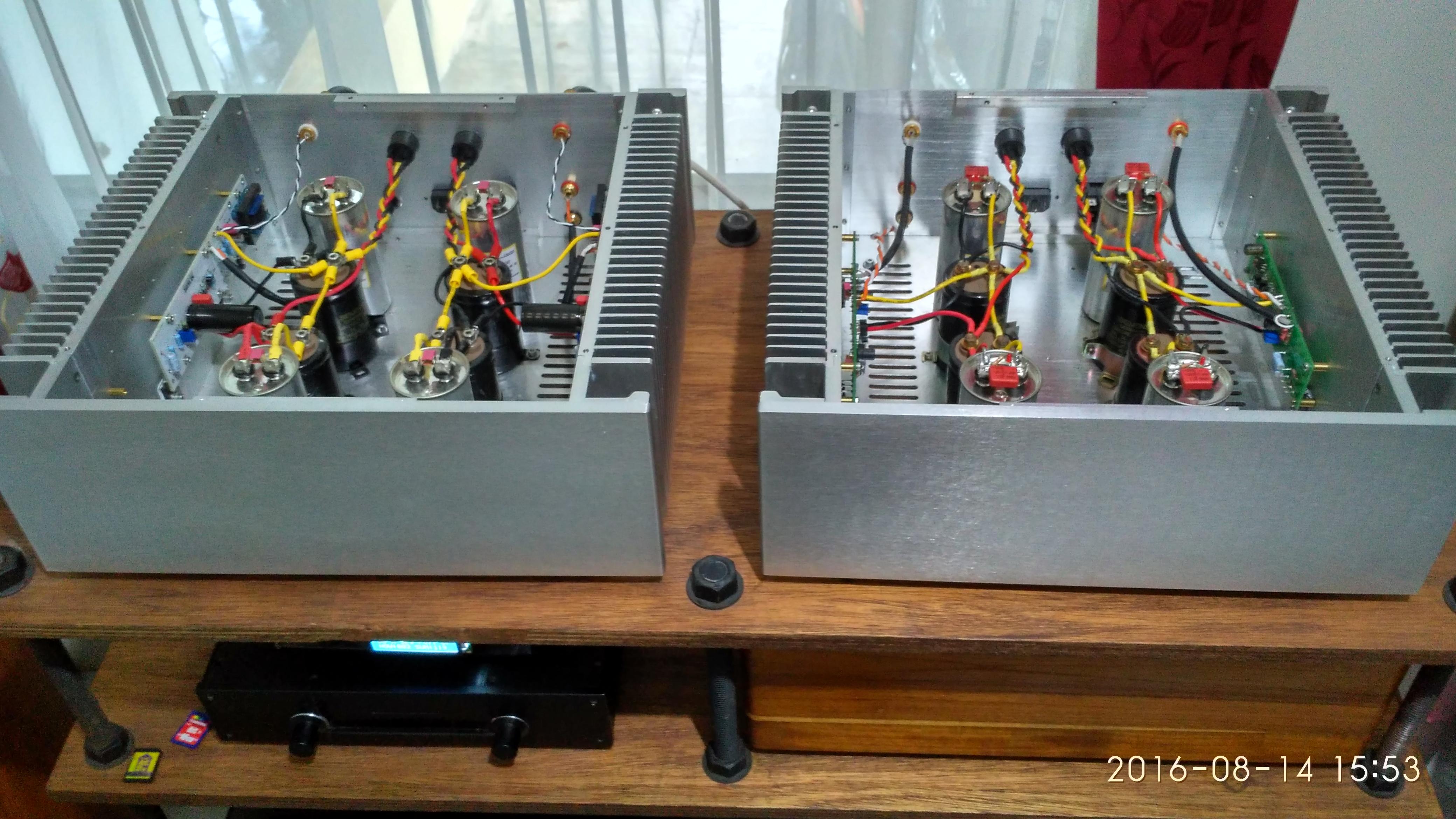

well my layout seems break all rules for parts placement and cable routing. When I build the chassis, I did not have any final parts layout yet, just put them slowly once I have all parts. When the plates had been cut, rifa/motor run/rusia caps were not bought yet. My original plan was to use MR original schematic and use my FW general psu connected with PowerCon, just like J2/M2. but then this pseudo parafeed came out. So i took out mauro penasa myref toroid.@ Gadut

that talema toroid is not shielded, input and ouput are close to it, signal and power cables cross each other, like a spider web 😀 but when dcb1 is set to full volume or when dac out connected directly to SIT, I can only hear a very little hum on A10p when my ear touch it, 10cm away I cant hear any hum. That is when no music playing, so I think that I'm blessed with my work, no issue so far on my build
