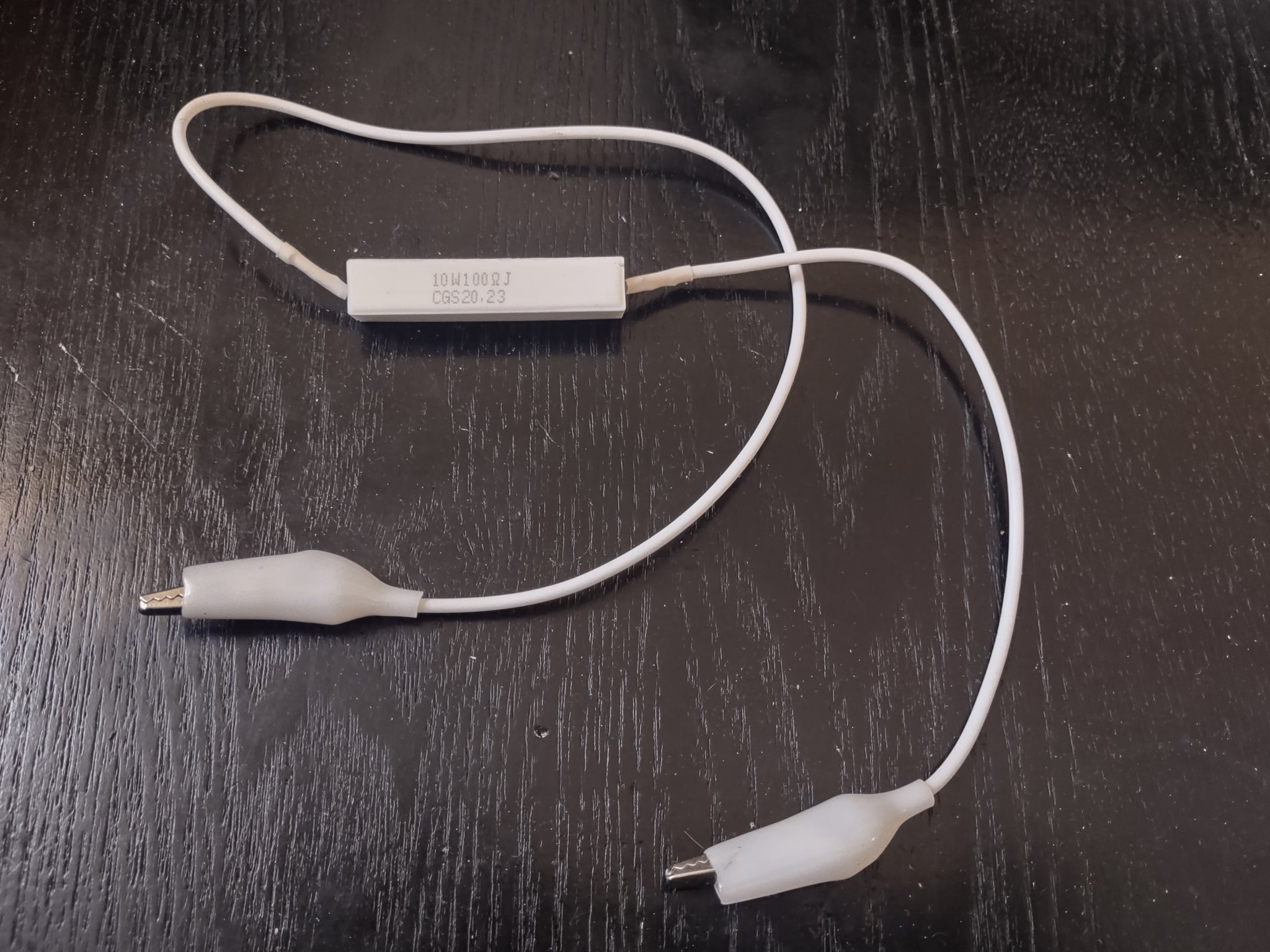

Safety First. You need a bleeder resistor in your power supply that will bring the b+ down to a safe level quickly. Since your circuit is failing to conduct the b+ it is staying in the caps, you mentioned it takes a long time to come down. Should be under 30v 10 seconds after you turn off the amp. So you need a ~470K 1w from one of the nodes in your power supply direct to ground. Yes, it eats a few mA from your circuit. it will also save your life if you keep having to go back in there.
a 10 ohm 10w resistor soldered to a couple alligator clips so you can manually drain the caps is a must, as well. Please don't put any of this above your safety.

The power has no where to go. You need one of these:
I got a bunch of those alligator clips cables already made up on Amazon, I think. Cut one in half and put a nice beefy resistor in there, under 100ohms and over 5w. Then you clip one end to a ground point (GROUND FIRST!) and then clip the other end to a node on the power supply.
Then install a 470k resistor across those same points so you'll be safe. That's a bleeder resistor. Gives that HV a path to ground when there's something wrong with the amp. Protects you.

The 100R 10w resistor with clips in the picture is a tool you should have to safely discharge caps.
Your amp should have a bleeder resistor to drain the caps in the power supply. Any resistor between 470k and 1M is fine, and it only consumes a few mA so 1 watt is fine.
