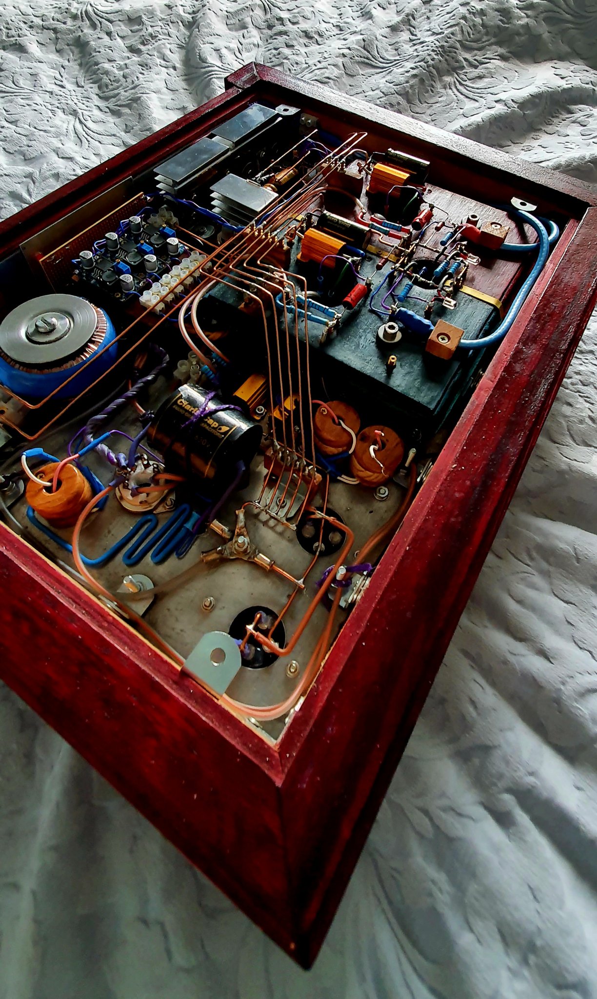

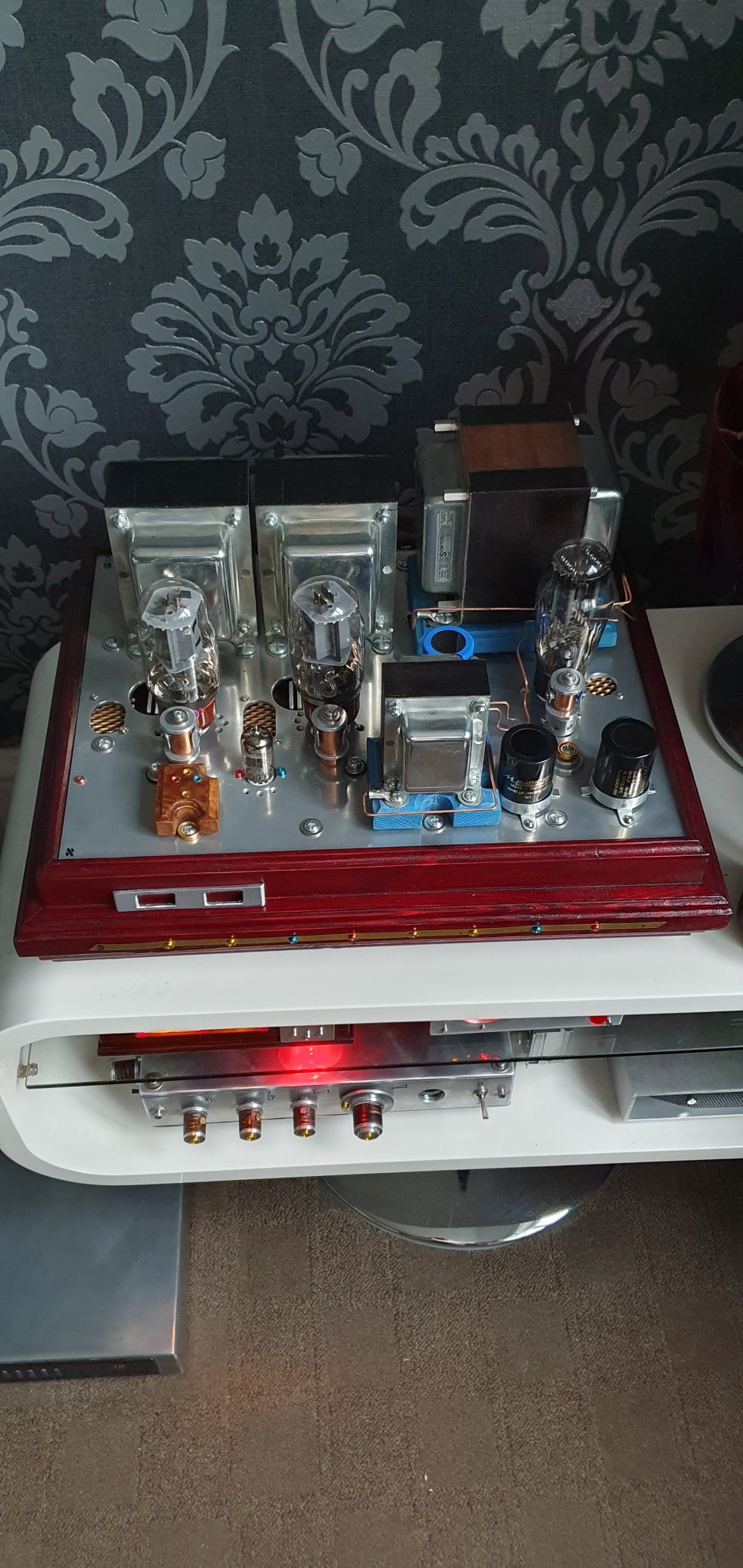

I've had the amp running great for 2 years and after one of the KT88's 'ran-away' causing the cathode resistor to burn out, I changed to KT66. Just this gremlin to try to get to the bottom off.

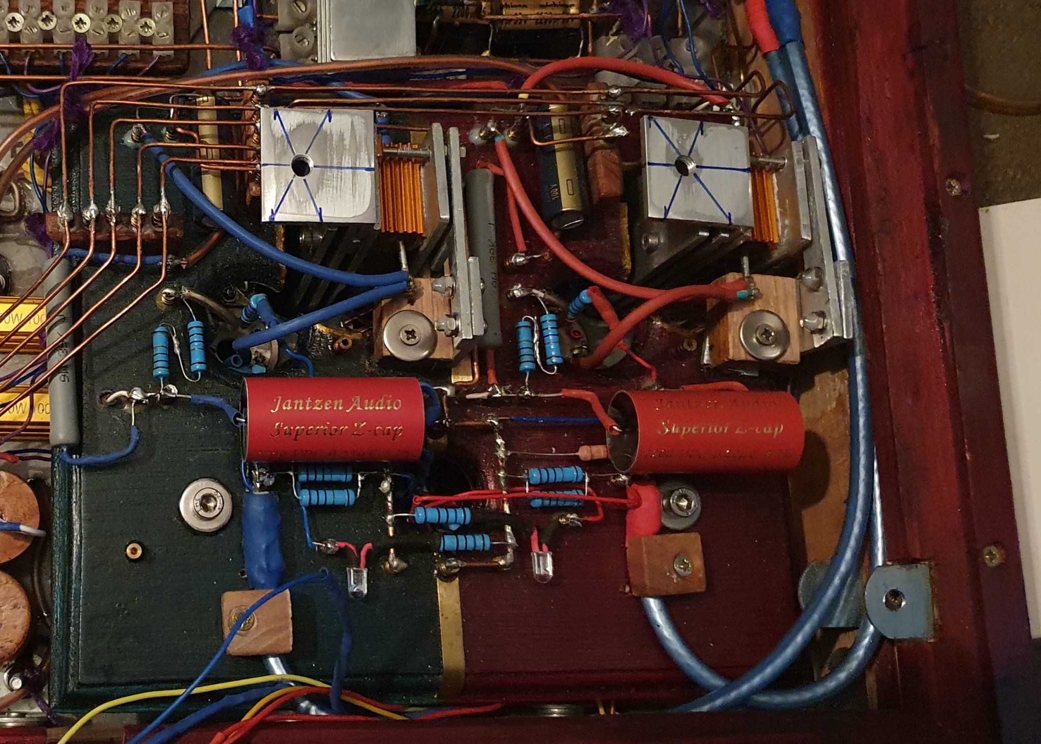

No voltage drop in an element of your power supply (4k7 resistor) means current is not flowing in that leg of the circuit. Maybe the 33uF cap is bad, maybe the tube is bad, maybe the LED is dead, or backwards, maybe that resistor is blown. Something is blocking the flow of current.
This is my thinking too, it must be the cap or LED.

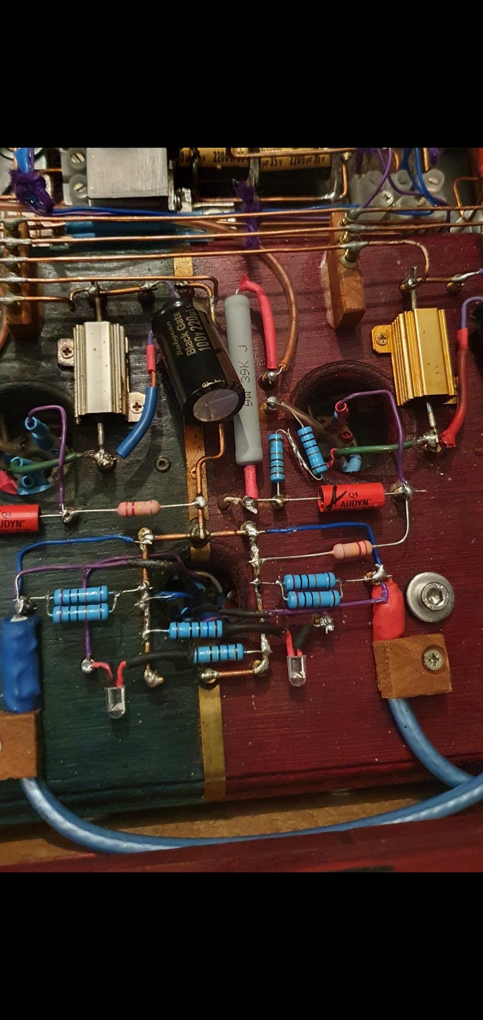

The reason I changed from KT88 to KT66 is that for two years everything was running OK with the KT88's. Then, one of tubes went into voltage 'runaway' and burnt out the cathode resistor (picture attached, one on the left, silver not gold). In my, lack of wisdom, I mounted them on plywood and not the chassis (!).
So, maybe damage occured elsewhere?
I am going to start with replacing the LED and resistor, then the cap, we'll see what happens.

Ya I'd replace any parts that were involved in a catastrophic failure. Think how much voltage the PT made when the tube stopped conducting, a big spike could have damaged the caps.
You should also think about a dropping resistor in the power supply, maybe a 200-350 ohm 5-10w wirewound resistor between the rectifier and the choke. Bring down that b+ a bit. And KT66 might prefer the 560-ohm cathode resistor.
