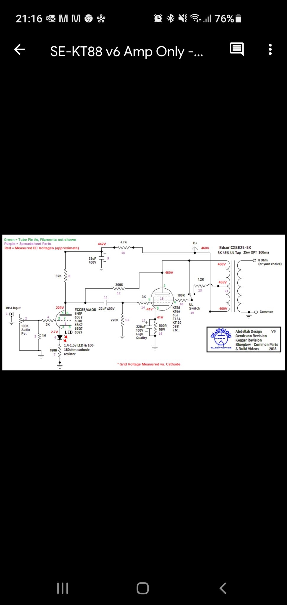

Hi Jan,
Thank you for the reply. Schematic attached from the excellent blueglow website, the circuit is common but I'm posting Blueglows artwork so I hope that is OK with everyone.
B+ is 436v and 425v on pin 3.
Only difference with mine is the cathode bypass cap which is 570R.
570 ohm bypass? Are you referring to Rk or to the bypass cap?
Anyway, 41V across 500R is 82mA which with 450V B+ is 409 * 82 = 33.5W Pa.
If that is not what ypou want, I recommend to look at the tube Ia curves and look up the Vgk for your desired Ia with the B+ you have and size Rk accordingly.
Or just increase Rk until you have the Ia you want (which of course can be calculated from the voltage drop across Rk).
Edit: if Rk is 570R then of course Ia is about 72mA which gives 29W Pa.

41v across 500R amd 450v B+ is for that schematic using KT88 Jan.
Mine differs in that it has a B+ of 436v (425v on pin 3) and uses a KT66. Cathode resistor is 570R with 220uf bypass cap.

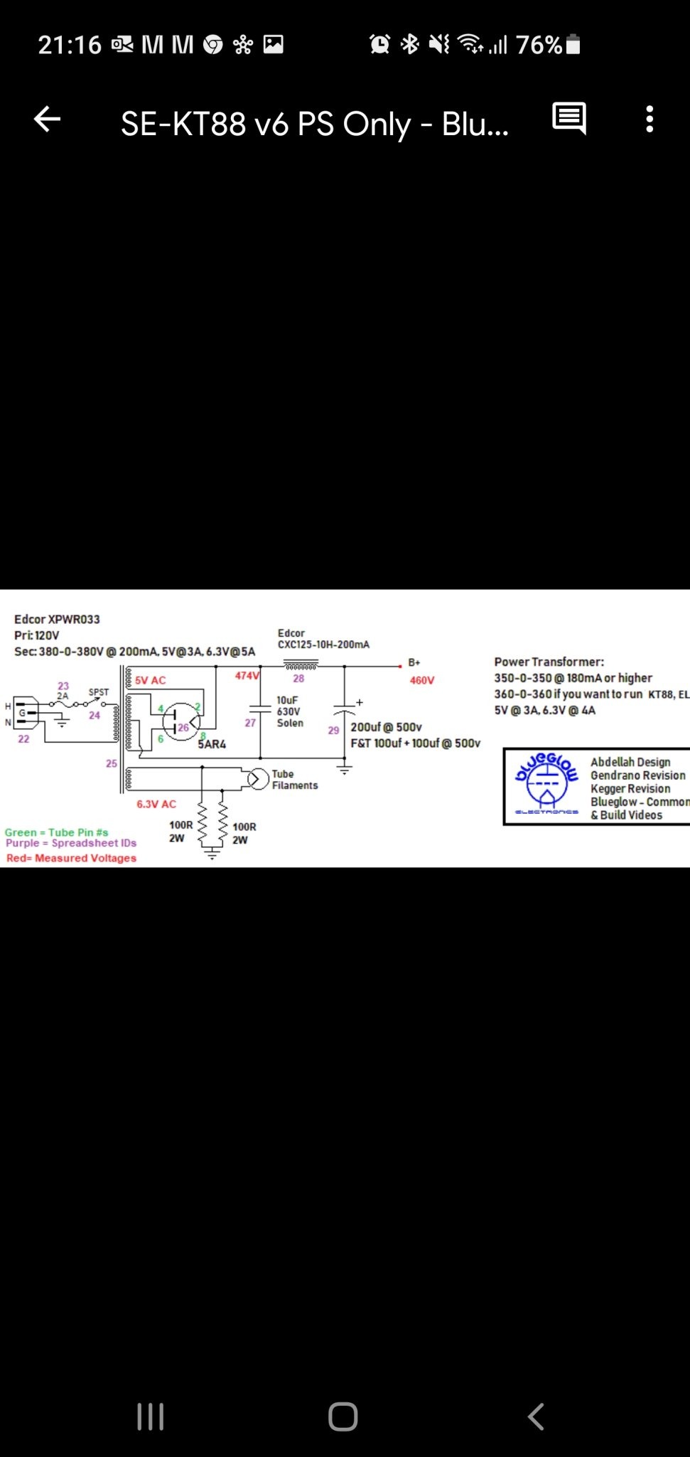

Just testing B+ and that went quickly over 510v (!)
Also, there is no difference in voltage between B+ (460v on schematic) and + of the 33uf cap (442v on schematic).
Mine has the same measurement at B+ and at the cap (no drop at all)
If you have no voltage drop across the 4.7K ('10') that means no current draw by the input stage. Check that Rk voltage drop.

Don't forget that as you change the value of those big cathode resistors, your overall b+ will change as more or less current flows from the transformer. so, smaller Kr = lower b+
Yes, I can do those basic calcs myself, but I'm worried about B+ which seams to continuously increasing, over 510v before switching off (my caps are all 500v)If you have no voltage drop across the 4.7K ('10') that means no current draw by the input stage. Check that Rk voltage drop.
425V on A and 41V at K is 384 Vak. With 41V across 570 that's 41/570=72mA. with the 384Vak thats 384*72=27.6W Pak.

As I'm not getting any voltage drop across the 4.7k resistor, as Jan mentioned, it doesn't appear that I am getting any current draw in the input stage. Could I ask how to check the drop here too please? On the schematic, there should be a voltage of around 2.7v on the input valve pin 3 (or 8), would this be the same test point?

Always check Vgk, that is what determines the tube current. Check that in the input stage.
The voltage across Rk divided by the value of Rk = Ia.
