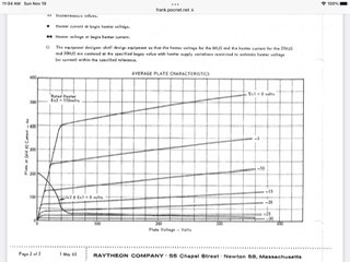

For pentode operation, especially if you’re going to beat on it, high perveance sweep tubes seem to make more sense that typical ‘audio’ tubes. You can often get enough plate current with only 100-150v on the screen, and the ratio of plate to screen current it often higher than in typical audio tubes. Here if you needed the same 400 mA afforded by a KT88 or EL34 only 110 on the screen is needed. Even operating below the knee, you’d only draw 100 mA screen at full square wave clip - and the resulting 5.5 watts g2 dissipation would be within rating. Even with NO LOAD you’d be within the 12 watt intermittent rating, (assuming you’ve clamped the overvoltage somehow, separate issue). If you’re having to run the screen up at 300,400 volts just to get enough plate current that ain’t gonna happen. And you melt screens.
