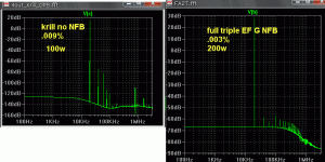

I did what I said in a earlier post and performed the Krill Vs.
EF in a more fair manner. Using a known low distortion
input source (my APT/holman FA2 .001%) and not a
simulated source , I put the 2 "neck to neck".
In the test I had to run the krill with NFB taken from the VAS
(like Steve's original) and I ran the triple at twice the power
with full GNFB.
Gk was right on , the triple , even at twice the power , beats
the krill . The difference in the krill , by its biasing scheme,
seem to be what type of distortion it produces (mainly H2)
and the EF (H3/5). This seems to fit in nicely with what
DX and I have heard.(smoother tubelike sound) Both amps , at least in my simulations,
can easily be made to have very low distortion.
I feel bad , because If I took the NFB off the output, the krill
might match the EF or even beat it.. 😎

I was looking closely at the two curves you posted... the difference between the 100w Krill and the 200w EF is 3dB, but the scales on the left side of the graphs show a different story. The Krill seems to show a noise floor at -120db while the EF is up at -68, and even taking that into account and drawing a line at the same point in the Krill graph, the peak of the 2nd harmonic is then at what appears to be -16db or so lower??
Am I being confused by something?
These are simulations, not the real thing, or??
_-_-bear
PS. again I may be misinterpreting something, but it looks like the first harmonic that appears is at 30khz? Isn't that not the second harmonic of 10khz?

By bear - The Krill seems to show a noise floor at -120db while the EF is up at -68, and even taking that into account and drawing a line at the same point in the Krill graph, the peak of the 2nd harmonic is then at what appears to be -16db or so lower??
V (c) on the krill 15Db to -75db H2= -93db
V (b) +28 and -58db= -86db ,not 16 but a 7 db difference
LT just sums the h2 - h9 , gives a error report showing percent
(.009 -.003%) difference. The point most relevant was not
whether the EF beat the krill , but how bias generator
affects the ratio of distortion components. BTW, something about
GNFB vs. NO nfb affected the noise floor. totally different amps.

By far the most and best of the amps (Leach , symasym
blameless, etc.) started out on the simulator backed
up by theory and numbers, the devices we use were not
guessed at !! , but were the result of long nights of
numbers and calculation.
What is the point to reduce distortion from 0.1% to 0.0001% when the speaker will be distorting 4 percent?.
What means bother with 20 Kilohertz.
How a amp behaves at 20 Khz and at what distortion it
can do that at , has a definite affect on how it will perform
in the audio range.
Now was made this way.... i tried, more than once to explain Mr. Steve that possibility, to select "builders"....not theorists...not to stay in that position to answer questions...better to say.... build and listen!
Now that is udder BS... When I started at the forum I just
wanted a simple amp to replace the Walmart garbage I
had. I saw DX amps and quasi amps but chose the quasi
and built them because he (quasi) would answer questions
so we , the builders,would learn why as well as build them.
Is that not the purpose of the forum , to make designers,
not just sheeplike builders ??(to learn). The ESP site is
a prime example of this , rod elliot give both plans to build
and all the theory that goes along with them.
Because of this , I personally don't need someone elses
plans or diagrams anymore. I can just see any idea ,topology,
theory.. simulate it , prototype it , If i like it , make PCB's
and live with it.
