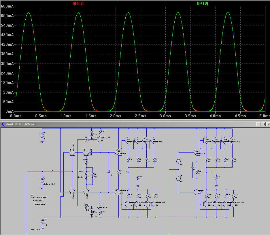

I just downloaded and ran mfc's LTspice sim (see attachment).
It is actually only 20V into 8 ohm (25W) with four pairs of output devices 🙄
I ran two versions in parallel - mfc's Krill OPS and one without the Krill bias generator (with ideal voltage sources for biasing instead).
The bias of this version ( call it a standard double EF) was adjusted so that Iq is exactly the same as in the Krill version.
Note the superimposed green and red current plots. These are the emitter currents for the first NPN transistor of each output stage - they are identical and note that the krill bias generator does absolutely nothing different to the cross over region Iq.
At 1kHz, 2kHz and 5kHz the THD of the double emitter follower version is much better than the krill version (about half).
At 20kHz though there is an interesting harmonic cancellation effect happening (with resistive load) and in this instance the krill version is returning a lower THD than the double EF.
Glen

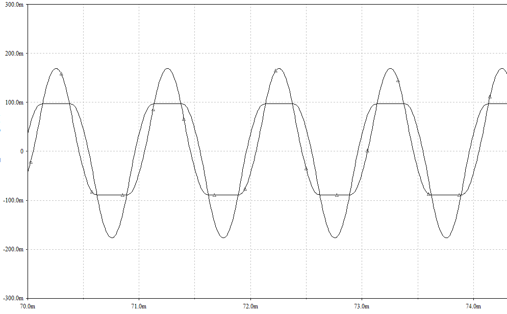

That is interesting Glen. Here is a larger power version with
40v peak into 8ohm (200w) at 20Khz and under .005%. Try it.
Nope, not built - just poking around.
Mike

Running out of time ATM unfortunately, however my main point is that with enough output devices in parallel these low THD figures can be easilly had in simulation just the same with just a bog standard double or triple EF.
None of these simulations prove one way or the other that the krill circuit is doing anything remarkable, IMHO.
Glen
Glen

I just ran GK's sim (EF vs. krill ) and found something interesting.
To be fair I used Andy C's signal source , Known good models
(andy's 2sa4793/2sa1837,FJP5200/1943 , Ksa1381/3503).
there is one factor here that "stacks the cards' in favor
of the EF .. the simulated voltage sources.
In the A/B comparison I noticed the EF "acted" much different
then when simulated by a real VAS. I suspect the ideal V
sources , with their infinitely low impedances, "optimized'
the EF giving it a unfair advantage.
would it not be a more objective exercise to compare
the krill current amp to the EF using a known low distortion
input/vas instead of the "ideal sources" ??

I wasn't really trying to draw a comparison against the krill OPS and a double EF, just showing that there is nothing remarkable about getting <0.005% THD in the simulator. I deliberately ran a sim with and without the krill bias generator simply to see what effect the krill bias generator has on the circuit.
Glen
