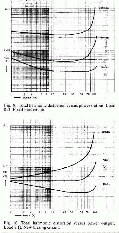

Discussing about graphs, I also found something interesting about "non-turnoff" topology (not restricted to Krill system).
If we look at the page that Ostripper pointed, http://71.203.210.93/upload/
and read paper "Tanaka_AES.pdf", we can see that beside eliminating distortion sharp peak at 20khz (scope shoot), this "non turn-off" is getting better and better at higher frequencies (20khz, 50khz, 100khz)
I found this interesting, because this non-turnoff scheme works better and better in area where negative feedback cannot do much (due to lost of OL in higher frequencies).

Steve wrote earlier that there is a distortion null at some output stage bias current. If bias current is increased beyond this, distortion will rise again which can be explained this way (at low bias both transistors will always be saturated).

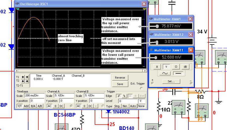

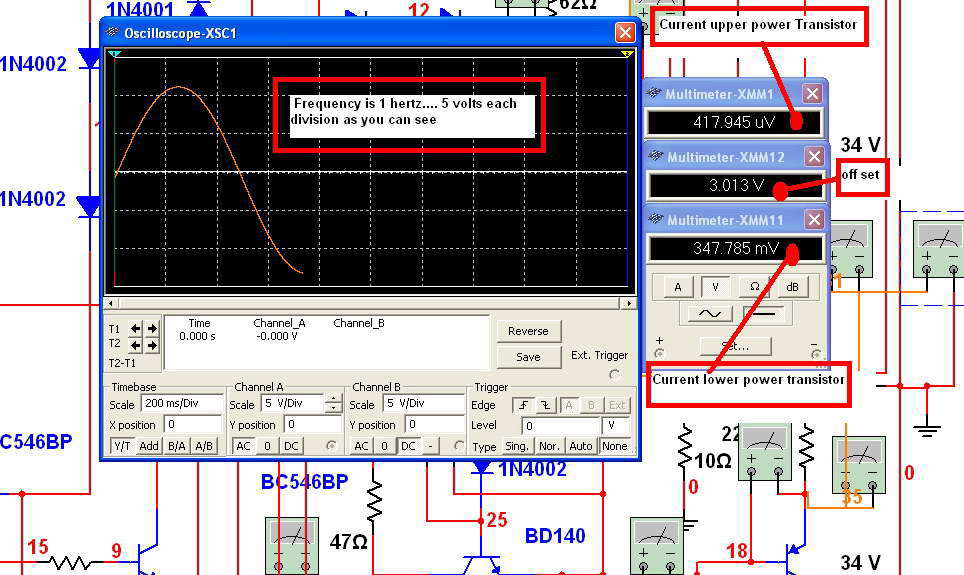

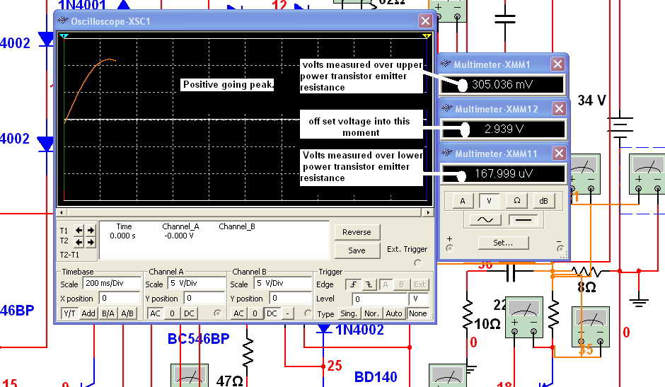

Yes folks..of course the off set was adjusted to less than 1 milivolt without signal
into the input.... this have appeared dinamically.
This hell off set is "the ghost in my life... fantasma"..... always bothering me....but do not disturb sonics.... sound is awsome!

Re: Yes folks..of course the off set was adjusted to less than 1 milivolt without signal
Hi Carlos,
I am not sure what the offset shown in your simulations is. A real version of the amp will have less than 1/10th that offset before adjustment.
regards,
Carlos
When the offset is adjusted, you should make the adjustment with your regular source (such as your preamp) plugged into the amp input, but with no signal.
Yes... i really think so Dunlap...must be something from the simulator that has delay
to reduce the offset to zero (reading) when passing into the zero volt reference line.... i think so.... when the "inside calculator" finishes to calculate the zero the wave form is already in another advanced positive or negative point.
Well...it is a simulator..not the real thing...the real amplifier sounds delicious.... i do not trust simulators...they are nice tools only...the judgement is made by human ears.
Thank you very much, once again and again, because you have shared with us.
I am deeply honored with your attention.
Carlos
Carlos
