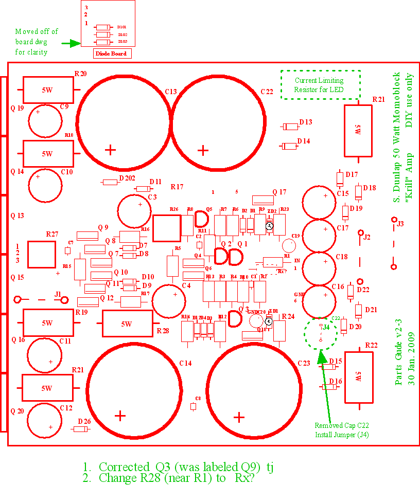

Updated drawing.
Whew - took awhile to get the upload file to size correctly. If you "click" on the file and "save" it you can view it as a gif file and zoom in pretty close for details.
Hope this helps. I'm still finding problems between the 50 Watt and 100 Watt schematics vs. the old pre-existing PWB and it's artwork. It's a work in progress - but - sigh - it's a labor of luv :clown:

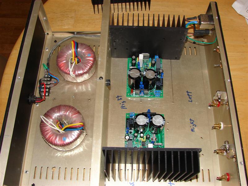

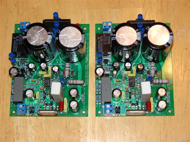

I personally am finishing up my shop / storage and will soon be starting my Krill so Thomas' drawing is coming at the perfect time.
I just finished "prototyping" the Mauro my Ref Rev_C on the kitchen table and don't want to do that again. That is what my shop / bench is for..

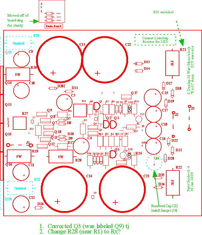

Updated parts location drawing. 🙄
Hey - I'm starting to get good at this stuff! :violin:
To bad no one passed the sanity check earlier where I spelled it S. Dunlap Momoblock Amp! I think Billy Idol used those!! :headshot:

I spent a little time over the weekend redesigning the 50W amp to make it more affordable. Switching to the Fairchild transistors and cutting back on the power supply filter caps cut a fair amount of money from the BOM. If you use this to build a stereo amp and use only one transformer and case you can save even more. For surround sound, you can put even more channels in one case with one transformer.
Much of the reason for giving you this option is the use of multi channel surround sound. You really don't need over 50W and building an all out amp can be expensive. Another reason is some of you would prefer to spend less money.
If there is sufficient interest, I will put together full kits with transformers as an option. There are no circuit boards for this amp at this time. That would need to be laid out and priced. The boards I still have will work but I would need to renumber parts on the schematic and BOM to match. Also, I can not guarantee the lead spacing for the caps will be correct. At this time I would not offer cases or heat sinks.
All parts are available from DigiKey and Mouser. I have made a BOM in Excel that lists all part numbers used as well as their schematic designations. If you can't order from these suppliers for any reason, you can still check the data sheets for the parts on their web sites. This will give you the lead spacing and sizes of all the components if you make your own boards.
I have attached the new schematic.
