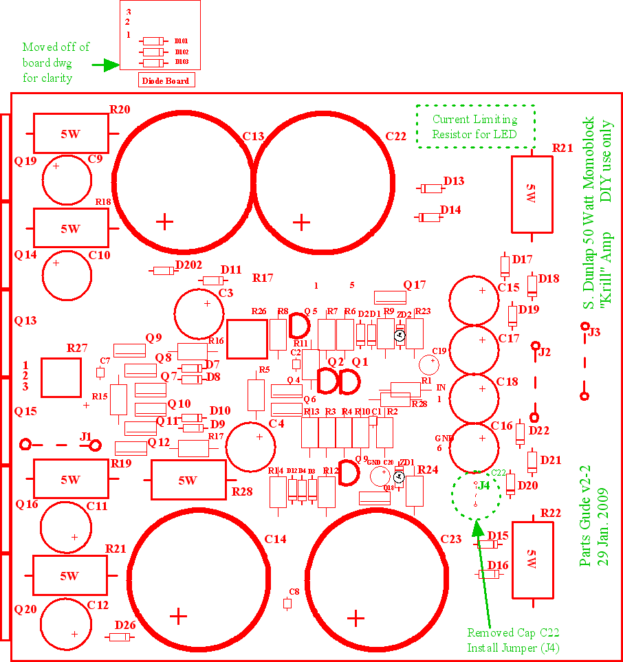

Hi Kids, ('cause I'm older than just about anyone hanging around here - including Steve)
I took the liberty of doing a redraw of the component placement guide for the 50 watt monoblock Krill. Steve has looked it over before and is ok with the layout as is. Questions, comments, small unmarked bills, appreciated. I will go to work on the 100 watt version next and am currently working on a Bill of Materials (BOM) (parts list) in MS Excel that I should have ready to go in a day or two.
:cheers:
BTW - this was uploaded in .gif format. If you click on the image and then select to save it do so in .gif format and you can zoom in for details.

50w stuffing guide
Hello c2cthomas,
Thanks for your new stuffing guide for the 50w amp it will be a great help to those using Steve's layout.
I notice that there are 2 resisitors labeled R28, one large 5W above C14 and another smaller one overlapping R1 near the input. I assume this is an error?
Best wishes
Dave
Re: 50w stuffing guide
DavidK said:
Hello c2cthomas,
Best wishes
Dave
Thanks for the feedback Dave - good catch. I shall need to consult with the master and make necessary corrections. This problem started out by correcting for 2 resistors labeled R20. Steve will put me right - no doubt. :whip:
DavidK said:
Hello c2cthomas,
Best wishes
Dave
The small R28 near the input is not on the schematic and is not used for these amps. R28 and the row of holes, 1 through 8, were placed there to allow the use of a discrete op amp for crossover use or phase inversion.
