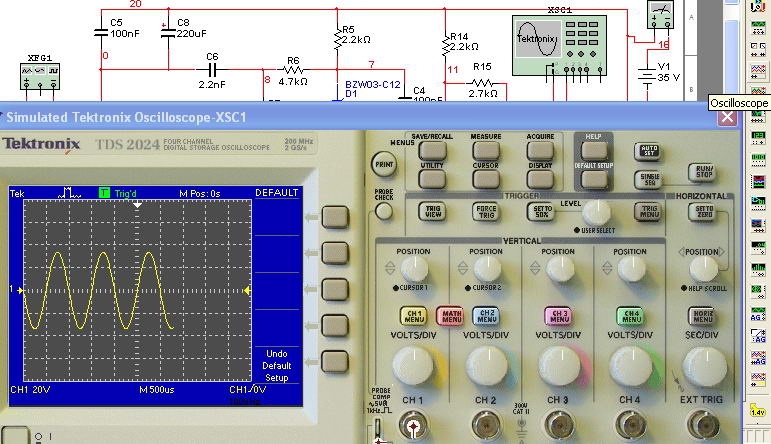

It (the krill) simulated perfectly.. first time!! what a blindingly fast amp with a strange topology.
It seems to "self bias" at 50-60ma OP wise and its offset
is determined by LTP current.
With no passive compensation (Cdom), it is only comp'ed
by device Cob.. next post
I ran it with modern devices and it will do a perfect 100k
squarewave with a little overshoot (the faster fairchild
devices)..

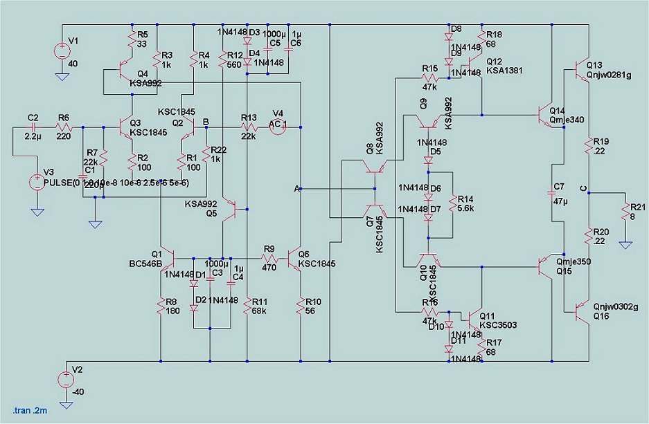

Here is that little overshoot I noticed (no doubt the KSA devices)
The 2 problems with doing a proper test on this amp is its
lack of global NFB (how to loop my AC analysis) and how
would I comp. for faster devices?? Still i would estimate
80-120 V/uS for this amp..

ostripper,
Thanks for the input and confirmation of my amp. In the schematic you posted you have C7 between the bases of the output pair (you probably looked at one of my posts where I had it wrong). C7 goes between the bases of the driver pair, C14 and C15 in your schematic. The value in your schematic also looks to be 47uF. It should be from 1uF up to 4.7uF.
Once again, thank you for your time and input.
