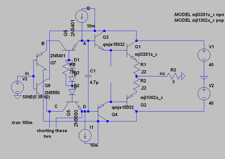

Steve Dunlap said:
It was suggested that the C to E could be shorted together on one of the bias transistors or replaced with a diode. I didn't try the diode, but when you simulate the circuit with the C E short it works fine in the simulation. If you do this to a real amp you will remove the base currents to the bias pair. The shorted one won't care (because it is now out of the circuit) but the opposite in the pair will turn off. This allows 10mA of current from the current source to place nearly the full rail voltage on the corresponding driver base. As a result, the output turns fully on. Not good.
Steve
Why would shorting C-E on one of the transistors remove its base current? Think of how a transistor is built. Zero collector current doesn't cause zero base current. Zero base current usually causes zero collector current though (if there is collector-emitter voltage available). Actually, removing collector current will increase base current for the same B-E voltage!
Taking an NPN and shorting its collector and emitter together essentially creates a diode but with only ~7V reverse breakdown due to the way the E-B junction is done. The base will become anode and collector/emitter cathode. You can also do it with one of the collector or emitter pins floating or conneted to the base. (like in a current mirror, the transistor is used as a diode there). Polarities are opposite for PNP:s of course!
Taking an NPN and shorting its collector and emitter together essentially creates a diode but with only ~7V reverse breakdown due to the way the E-B junction is done. The base will become anode and collector/emitter cathode. You can also do it with one of the collector or emitter pins floating or connected to the base. (like in a current mirror, the transistor is used as a diode there). Polarities are opposite for PNP:s of course!
Second paragraph first. Shorting the collector to the emitter takes the transistor out of the circuit. Shorting the collector to the base makes a diode. If there is no current flowing in the emitter then there is no current flowing in the base. When you short C to E no current will flow in any pin. Emitter current = collector current + base current. C = E (because they are shorted together) therefore B = 0.
No way 😀 Try taking an NPN transistor, collector conneted to nothing. Put red lead of multimeter in diode test mode on base pin, black lead on emitter. Current will flow, and the voltage drop will be 400-700mV depending on transistor size, current and temperature. Same will happen with black lead on collector. But if you were right no current would be able to flow in this case. Look at this simplified picture of internal structure for an explanation:
http://fourier.eng.hmc.edu/e84/lectures/figures/transistorBJT1.gif
Connecting CE together to black lead and red lead on base will of course also give a reading of around 400-700mV!
An NPN BJT is like two diodes connected with anodes to the base with the peculiar property that forward biasing one of the diodes makes it possible for current to flow from collector to emitter or vice versa. Reverse all polarities for a PNP.
Yup, and a very useful one too when matching to another transistor is needed!
Only true if no current is flowing in the collector.
Not if you forward bias the BE and BC junctions by making the base positive in regards to C and E for an NPN.
But now you defined the emitter current in the other direction compared to base and collector current. (emitter current coming out while base and collector are going in or vice versa). This is Kirchoffs Current Law: Ie + Ib + Ic = 0 if all currents are defined in the same direction.
Would be true if collector and emitter junctions were identical, but doesn't matter.
therefore B = 0.
No, base current going in equals the sum of current coming out of collector and emitter. If IC = IE then this means (-Ib) = Ie+Ic = 2Ic = 2Ie.
You are right. I am an idiot. I just assumed we were talking about transistors in a circuit. This one specifically. If you simply take the transistors OUT of the circuit, it works just as you say. Almost.
But the transistors will not magically start to work another way when put into the circuit so it won't blow up like you say. But maybe you misunderstood what I meant by shorting them together (those two wires coming out at the bottom are the ones I mean in my diagram). This makes Q5 a diode just like the others in the string and it will work just fine. Q8 will drive Q4 directly and Q6 will provide bias voltage for the output stage, without undefined or very nonlinear behaviour. But that doesn't really matter for the problem and in the following text, is not done.
The problem I'm talking about is something that will be pretty unusal as I've already said, maybe affecting only a few percent of the amplifiers made - but in my book that's one of the worst problems - not apparent in the prototype or even a small production run maybe. I'd be happy if someone pointed out a nonobvious bug like that in one of my circuits.
If you say it's not a problem then here's a hint:
(the convention i use is Uab = "red lead" on node A and black on B)
1) Ubc is about 2Vd, set by Q7,Q8
2) Uad is about 4Vd set by Q5,Q6 and the diodes for biasing output stage.
Kirchoffs voltage law gives: Uab + Ubc + Ucd + Uda = 0
Insertion of 1 & 2 gives [because Uda = -Uad]:
Uab + 2Vd + Ucd - 4Vd = 0 <=> Uab + Ucd = 2Vd
That is, the sum of the voltage drops over CE of Q5 and Q6 is 2 diode drops. But how does it divide?
Hint #2 = There's nothing in the circuit that will make it divide 50-50...

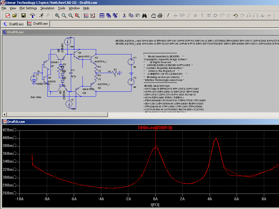

That's true!
In the real case, one transistor will get much more Vce than the other.

roender said:
That's true!
Yes, and because the base currents and collector currents are the same it will be the one with lowest current gain... *at idle*
When there is output from the amplifier the collector currents are modulated though in such a way that at some amplifier output current (depends on the beta of all transistors except the ones furthest to the left) the voltage drop will flip over pretty abruptly and nonlinearly to the other transistor, because base currents are still the same.
The amplifier output current when this happens may or *may not* be outside the current range the amplifier needs to deliver.
Here is a graph of the voltage drop from input node to output node plotted as a resistance can look like - the output stage can be modelled as the voltage source in series with this resistance, not taking into account the DC offset created.
