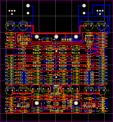

I have made the first "rough" layout.
Size app. 7.5x10,75 cm or 3"x4.2"
Please let me know your suggestions for any improvements, before I go further.....😉

and please clearly explain your reasons for your suggested improvements, so all can participate and so I don't have to make a mill. minor changes with no effect 🙄

Let me know your suggestions within 24 hours, otherwise I just start refining the layout and publish it at it turns out 😉

First of all i am not good at layout and i have never done any myself so thake this more as questions than any kind of critique.
1: The feedbacksensing shares the copper on the PCB with some other parts on its way t R130 and R145 is that ok. Couldn't you have the sensing wire taken directly from before the Zobel to directly connecting to R130 and R145?
2: As i see it an emitter follower is less suceptible to powersupply noise than a common emitter so woud there be any benefit of not sharing the supply for q107 q108 emitterresistors with the rest of the early amp stages, like a star ground for the power rails.

hjelm
Thanks for your input 😉
I fully understand your questions and suggestions.......
But frankly speaking, I don't think this simple amp would benefit of any of those suggested refinements.
However your suggestions would very much fit more complex amp circuits 😉
