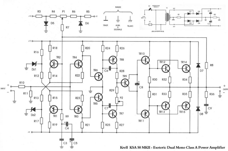

30V supply is too low, - 50W into 8 ohms is 28,2V peak. 35 V is minimum in my opinion, but then of course idle dissipation increases as supply goes up.
K-amps... your calcs are OK, but the combined 1.8-2 A idle will flow through both halves... theoretical minimum idle will be 2,5A for 50W into 8 ohms in true class A, which makes my toroids just about good for a 50W amp, as the trafo is spec'ed at full load. Obviously, a larger trafo would make for a stiffer supply voltage, but at a cost,- price....
Maybe the frontand should be ragulated ?? any thoughts ??
ACD, - which design voltage was used for the driver section ??? Are the component values true to the original, except for the transistors ??

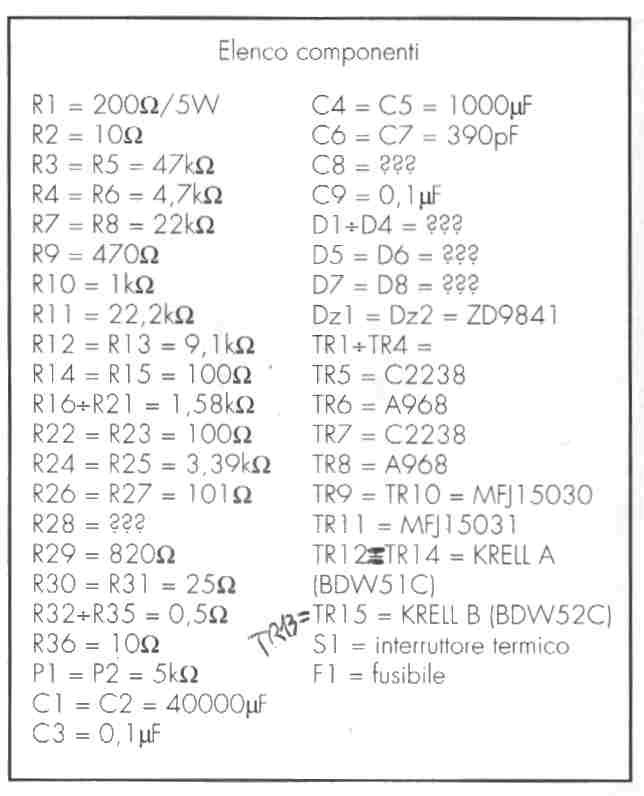

By the way, there are a couple of inconsistencies in the schematic/layout:
-on the layout Q108 is labelled Q106
-notes on schematic state that Q107 and 108 must be fitted with suitable heatsink. This should read 'Q109 and Q110'. What thermal rating is required?
Ok, Bremen......see your point, but just lowering the supply will influnce the behaviour of the front end/driver section...depending in its design voltage.
Thats the reason for my last question.

As I said, I'm not expecting 50W from 30V, just something smaller but similar sound. Call it a KSA-25 if you like. I also mentioned that I realised that the driver might have to stay at 45V, that I was prepared to try just reducing the volts to the output stage.
AuroraB implied that even in the original KSA-50 the drivers and output might not be the same rails - can anyone confirm what the driver stages require?
