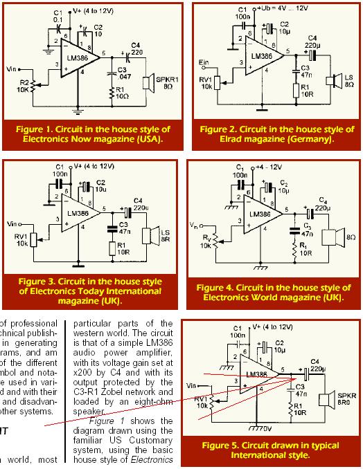

Caps are not upside down 😉
Small line are + , box line are -
However I hace forgot a connection between the output and the protection circuit (between R201-R202 and R301-R302) 🙄

Hi Jan,
It's not so important as long as everyone understands what is meant or when the polarity in the circuit diagram is clear, but it is the first time that I see the open box side used as the -.
In the IEC symbol overview the + is indicated as an open box, the - as a black box.

For the 25 years I have "fooling around" with electronics in Denmark, electrolytic caps has always been drawn like this (sometimes the square bow is filled out), and the CAD software we use here also draw the caps this way 😉

Well, I'm surprised, that's all. It's a non-issue. Let's leave it like that.

This drawing technique is non-standard, non-IEC and confusing for most. Usage of it is probably so because of a local CAD program that used a wrong symbol. Never seen it before, even schematics of very old radios use the symbol with the + pole drawn as a hollow box and the negative pole as a filled box. I suggest to draw schematics according international standards to avoid exploding caps/safety issues as this is an international forum read by international members.
