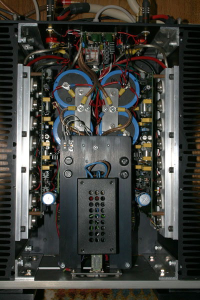

The quality of transformers in Krell amps I've seen (heard) varied quite a bit. Some were dead quiet, some had quite a buzz.
All were generously specified (more than enough VA to run at rated power even at low impedances). As far as regulation and flux density I woudln't have a clue, I only had one specimen to look up closely(ish), and at 3KW it was reasonably good as far as sagging (<2% I think), but then most big trafos are.
I don't think they were special devices, despite impressive logos on them 🙂

... what makes Krell a Krell.
Physical limits or specification of devices are the same for every manufacturers. In this type of amp, which have probably +/- 50 V rails, two output devices with 15 A colector current each and standard SOAR you cannot " go " with load impedance too low, I mean only to cca 2 Ohms. Apogee boxes, which have impedance ( as I know ) around 1 - 2 Ohms, are for this type of amp dangerous, independent on claims of amp's manufacturer.
Re: ... what makes Krell a Krell.
Well, even going by theory, 400W peak only requires 20A (10A per device). Pushing it into dangerous waters, definitely, with 20A devices, but real life music only requires these kind of peaks less than 10% of the time. At those power levels the speakers, rooms and owner's eardrums will be giving up probably lot quicker than output transistors.
But more importantly these are not claims, Krells actually WORKED with Apogees - that is how legend was born.
Besides, other Krells used lot more ouput devices than two pairs.
My version of KSA100 for example has 16 20A devices per channel. I don't really think I'd need any V-I limiters even with 1 ohm loads !
(my version == the version I've made as DIY, of course!)
Upupa Epops said:Physical limits or specification of devices are the same for every manufacturers. In this type of amp, which have probably +/- 50 V rails, two output devices with 15 A colector current each and standard SOAR you cannot " go " with load impedance too low, I mean only to cca 2 Ohms. Apogee boxes, which have impedance ( as I know ) around 1 - 2 Ohms, are for this type of amp dangerous, independent on claims of amp's manufacturer.
