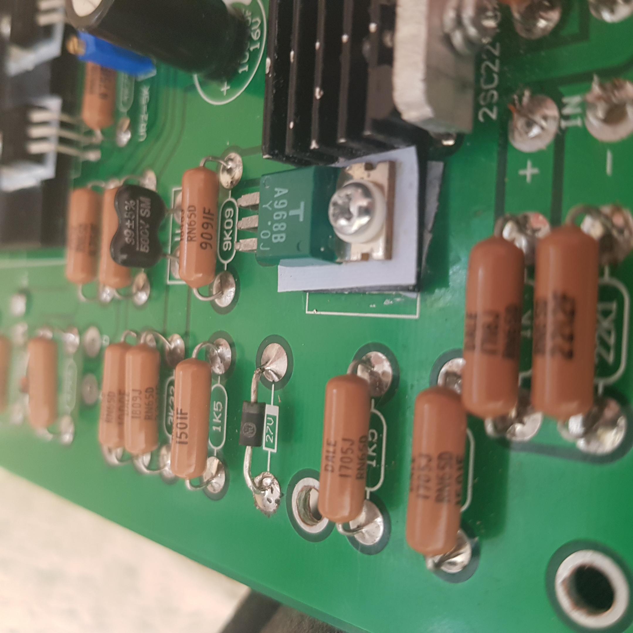

Hi itsmee thanks for your help but I am still confused D1 is 4144 diode on +48v line I get +.55v one side of this diode and +0.0v other side.
D2 27v z diode I get +26.7v one side of diode 0v other side.
D3 diode is 4144 diode -48v line I get -46.7v one side of diode and -9.3v other side of diode.
D4 is 27v z diode I get 26.7v one side of diode and ov other side of diode.
Is it my diodes which are wrong 4k7 resistors / 9k1 resistors or ksa1845 /2sa992.
Resistors are correct by the diagram though or should I try some 2SA1312BL/2SC3324BL smd transistors.

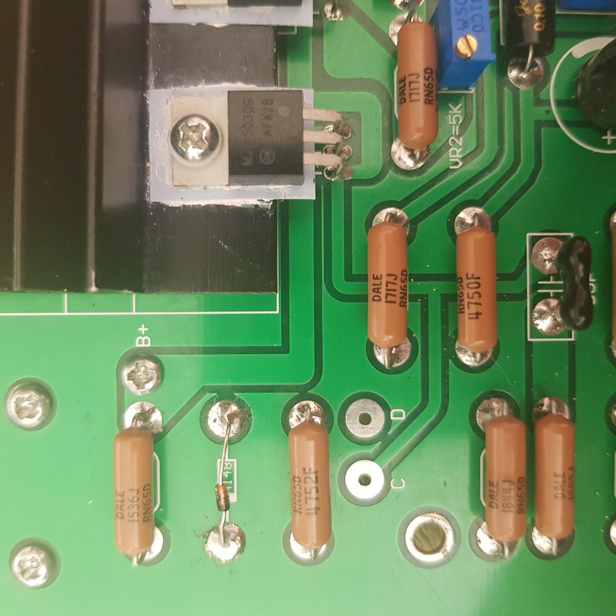

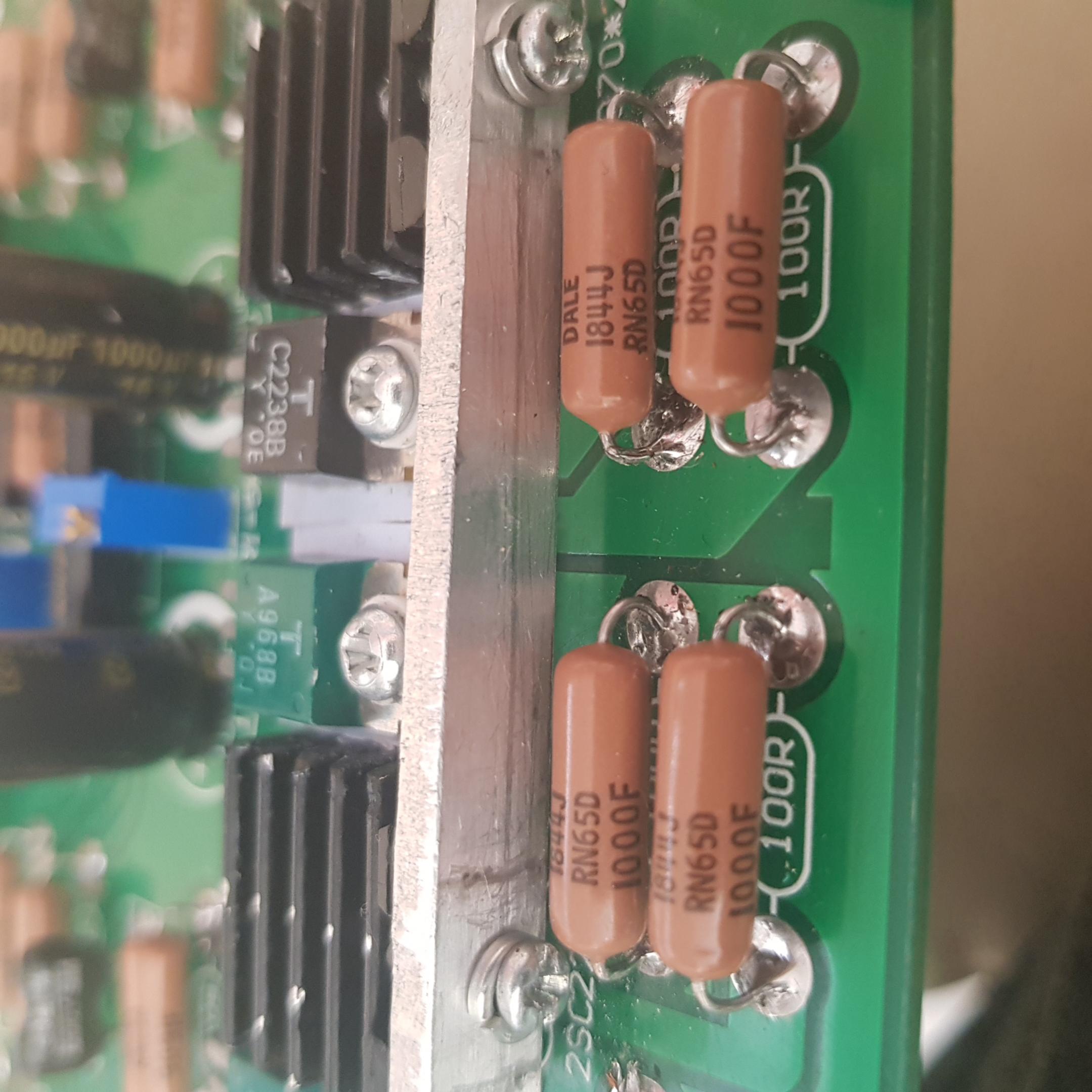

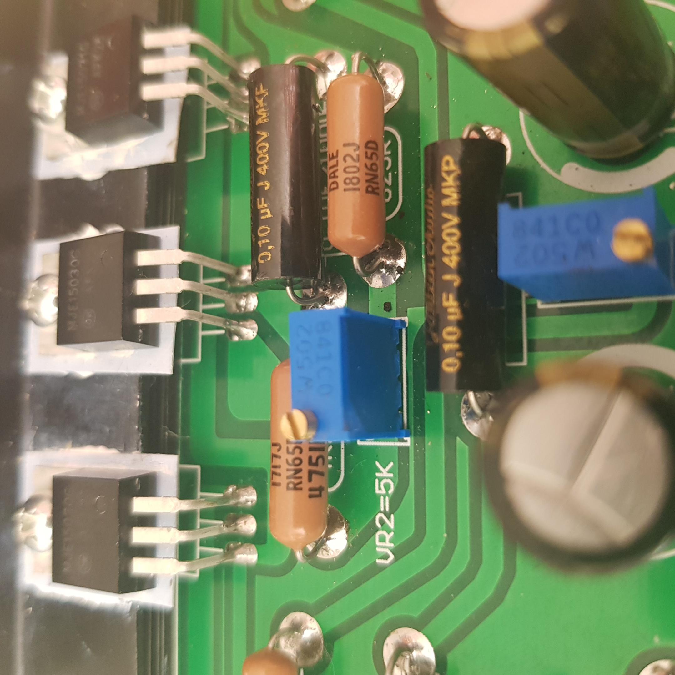

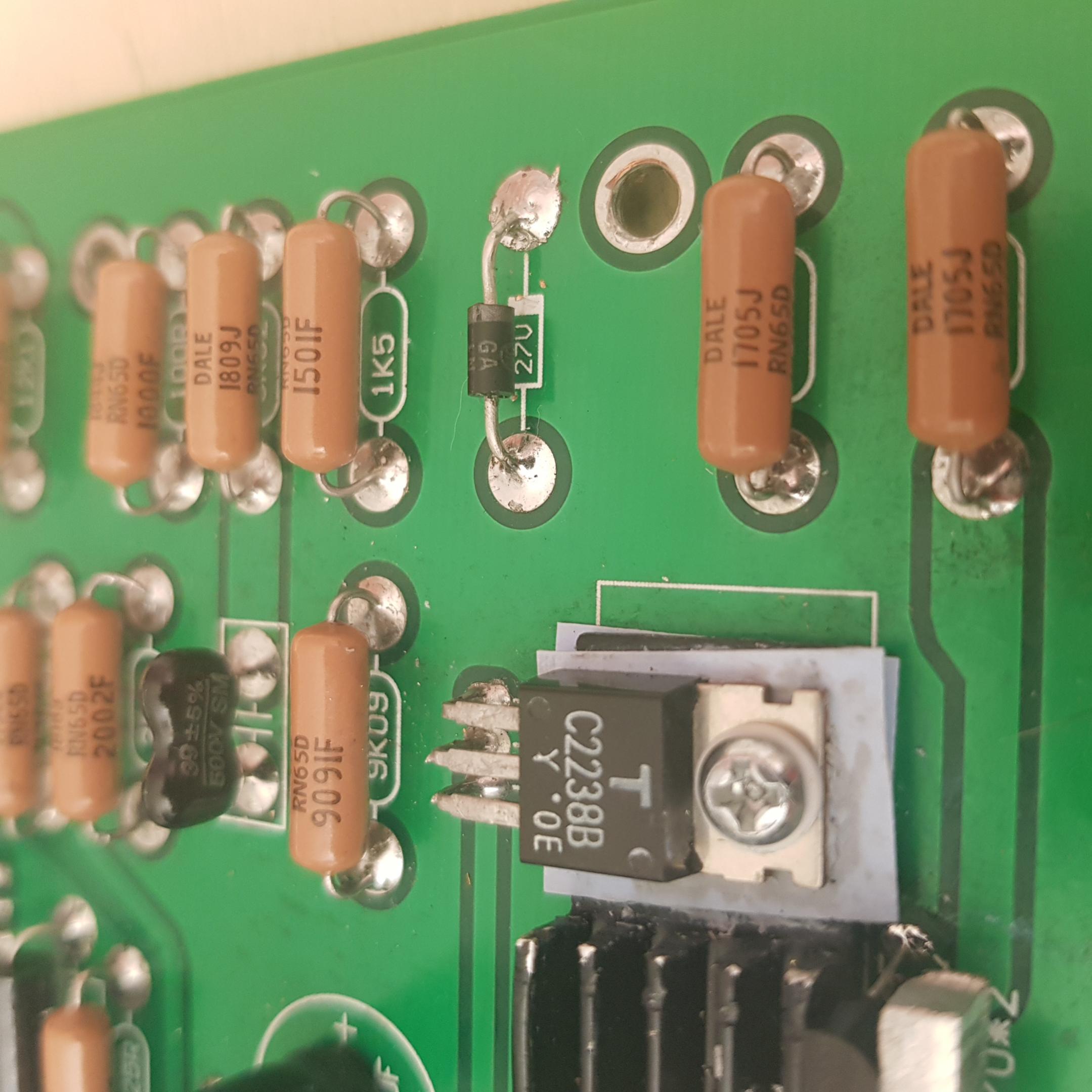

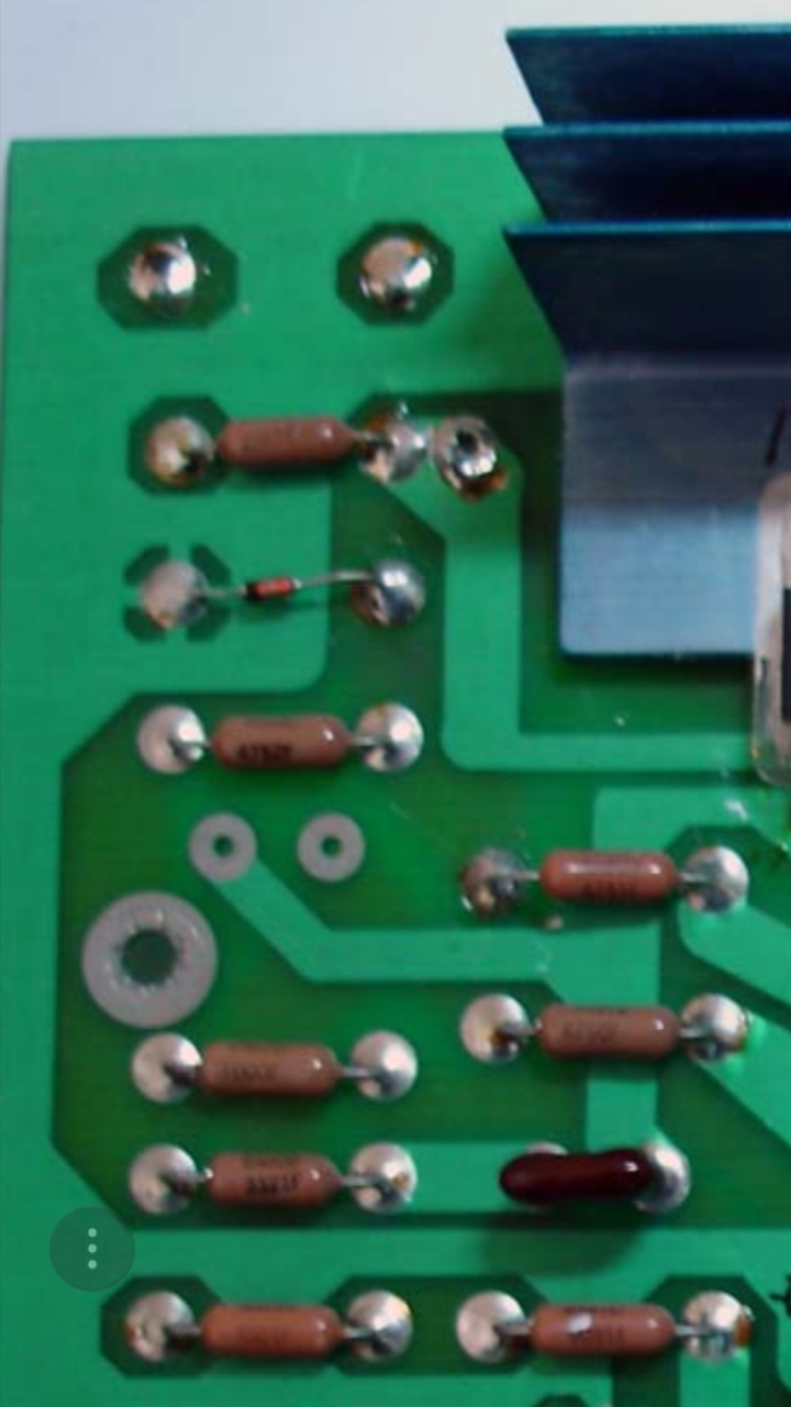

Pictures Dave, pictures ;)
Pictures where we can see the values of installed components.
Thanks neychi I did check every resistor with a meter as well and all seem to be ok.

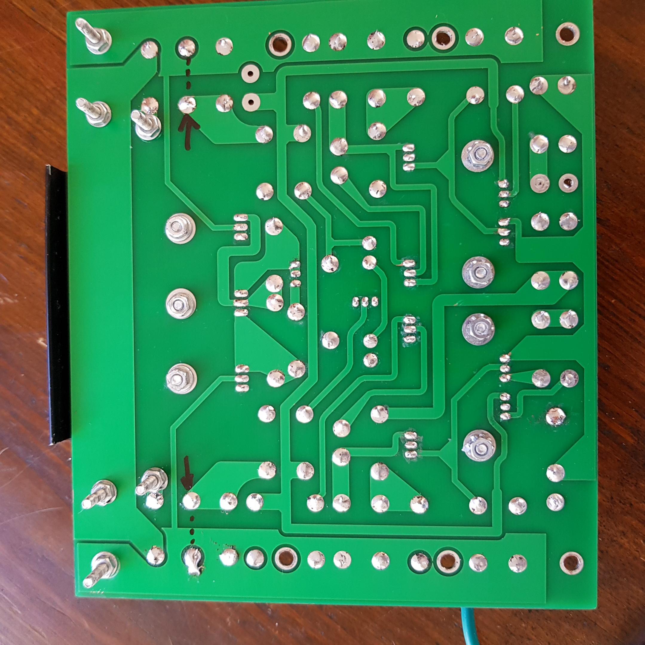

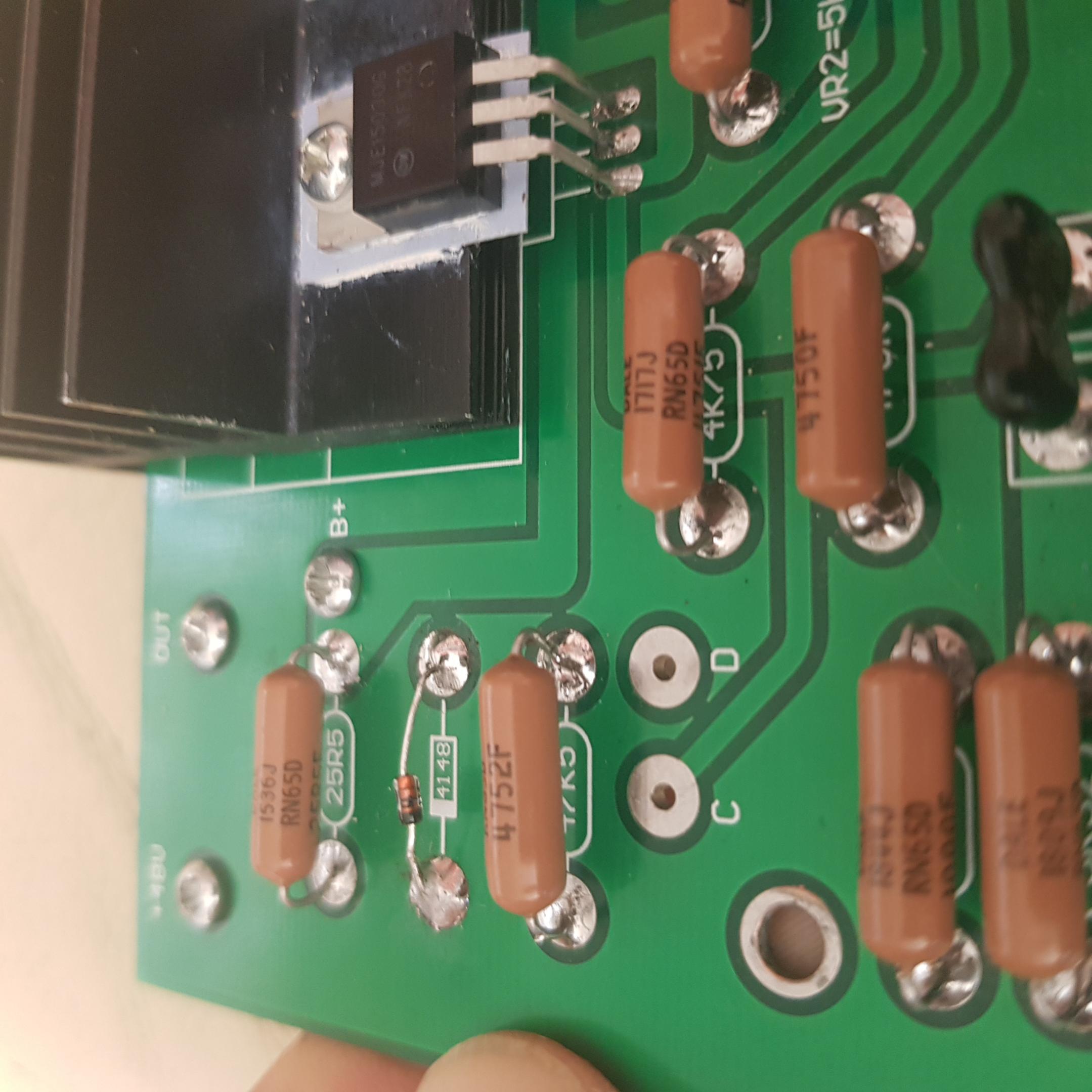

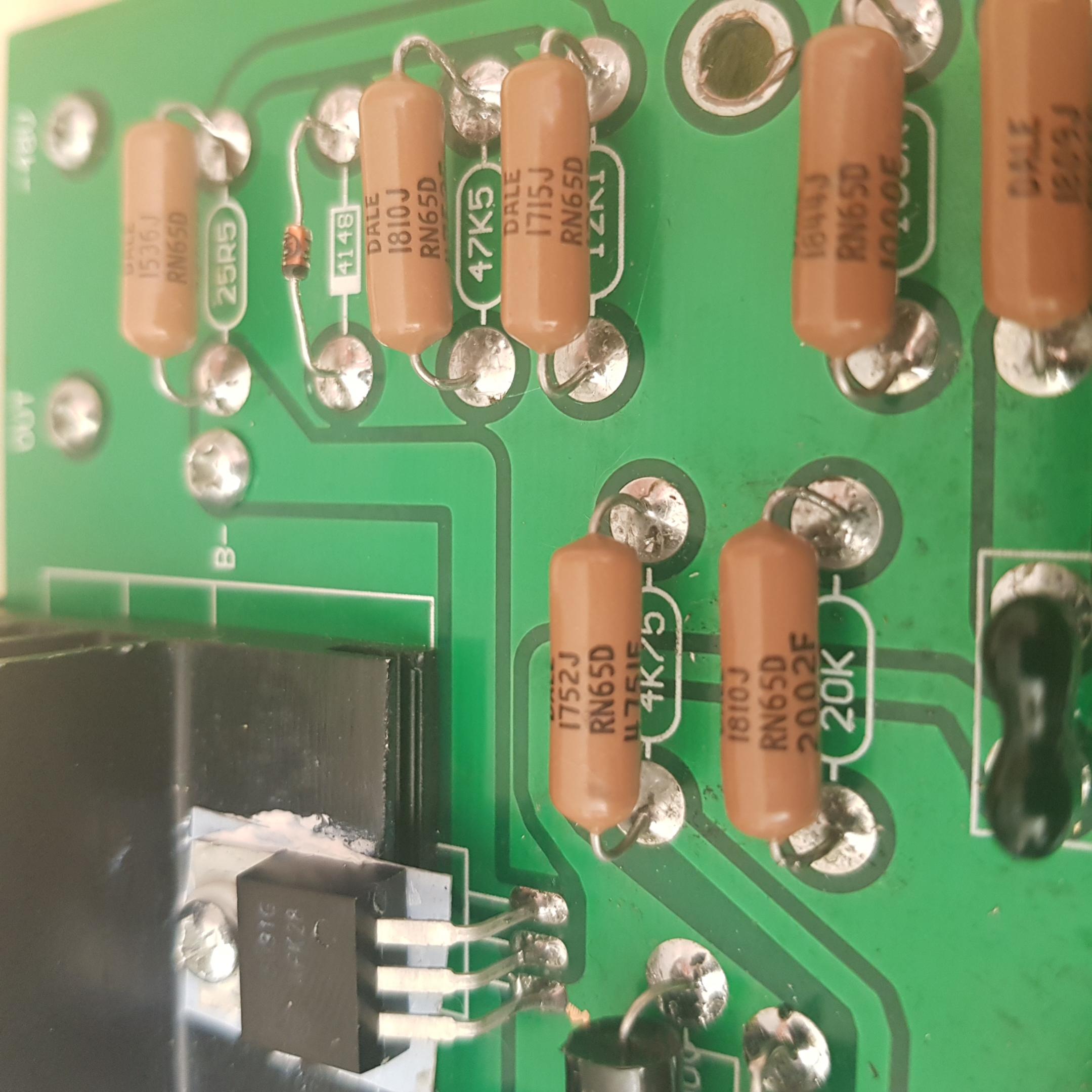

The -9.3V end of the diode should be 0V, check the continuity of D3 anode (top end in schematic) to 0V.
Thankyou again itsmee you are correct my D1 D3 have not got 0v to them.
I have checked all solder joints but nothing is faulty.
Should I run a wire to these diodes from 0v ground in.
As you can see both boards have a make do joint from diode to -48v I did not do this they come like that.
Dotted line is the diodes
