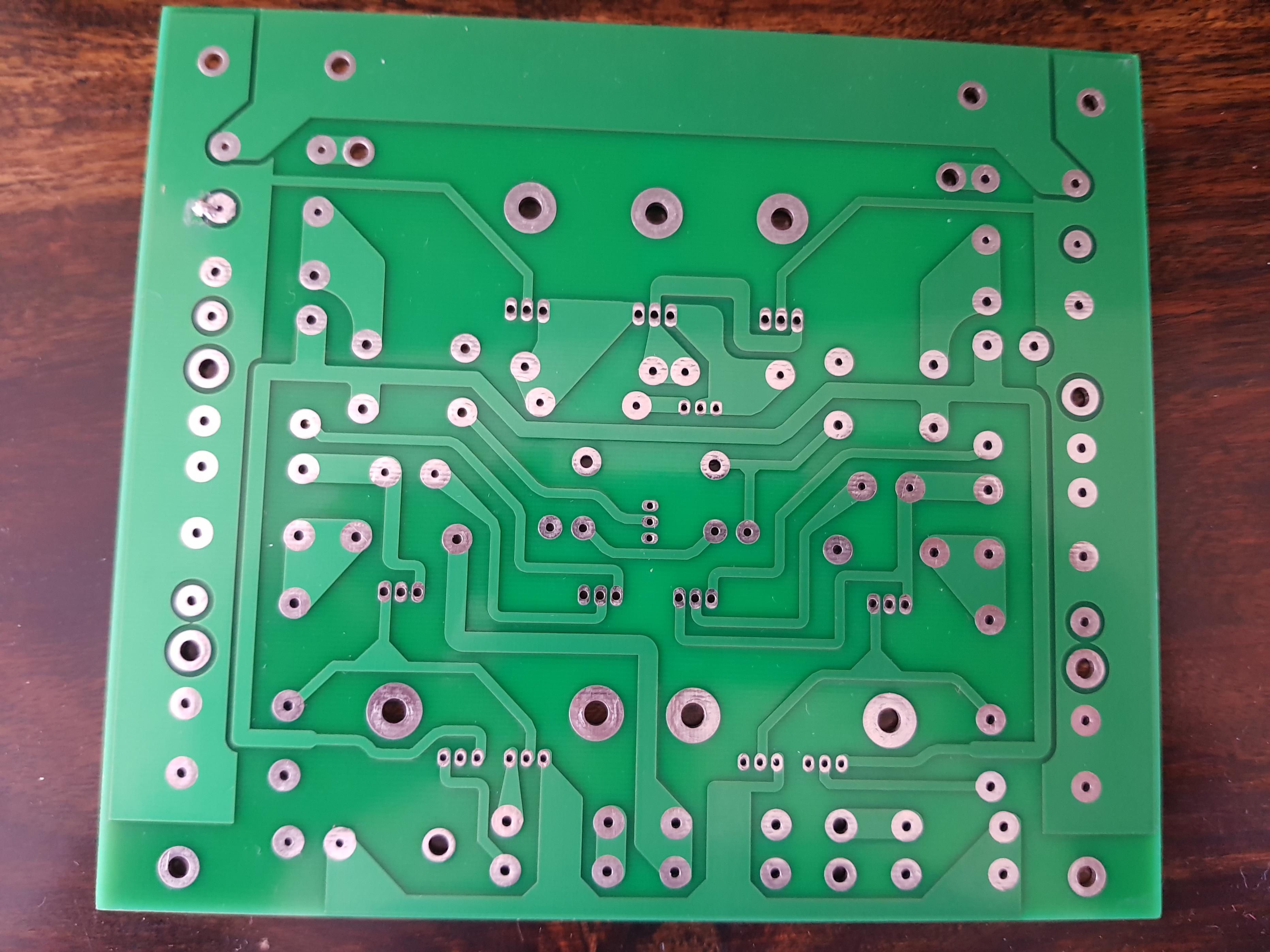

Is D3 upsidedown?
I have mounted the diodes how it shows on pcb but did notice that my +48v side resistors output - voltage and my -48v side output + voltage when im setting up bias.
This may be correct but I am not sure.
My boards didnt come with any circuit diagram or schematics all components are marked on boards.
They are meant to be exact coppies of krell ksa 50mk2 and they do look the same.
The only thing studying pictures of a real krell amp the dc pot was mounted the other way up so I tried turning mine but this made no difference I just had to wind the screw in to get the dc down to 1.6v.
The pot does work just I get the range of 3v dc to 1.6v dc.
Now we are getting somewhere, the wiper of the pot should measure between ~-1V & +1V wrt 0V.
Any idea what component would cause this
What voltage do you have at the anode of D1 and cathode of D3?

Sorry I feel so stupid but did say it was my first amp build.
Where I substituted parts got my part numbers muddled up so had my pnp and npn in each others places.

This is a little confusing, D1 & D3 are 1N4148, D2 & D4 are 27v zenners.
Can you measure the voltage at D1 anode, pot wiper and D3 cathode as shown,
and could you also measure the D4 zenner voltage, (all measurements wrt 0V).
PS, sorry about the crappy schematic, it's the only copy I have.

Thank you I will measure them when I get back home I am out at moment
Cant find ksa 50 mk2 but this is simular.
Dave, this is your schematic, trust me 😉
Thank you does this picture help.
- Krell KSA 50 PCB
