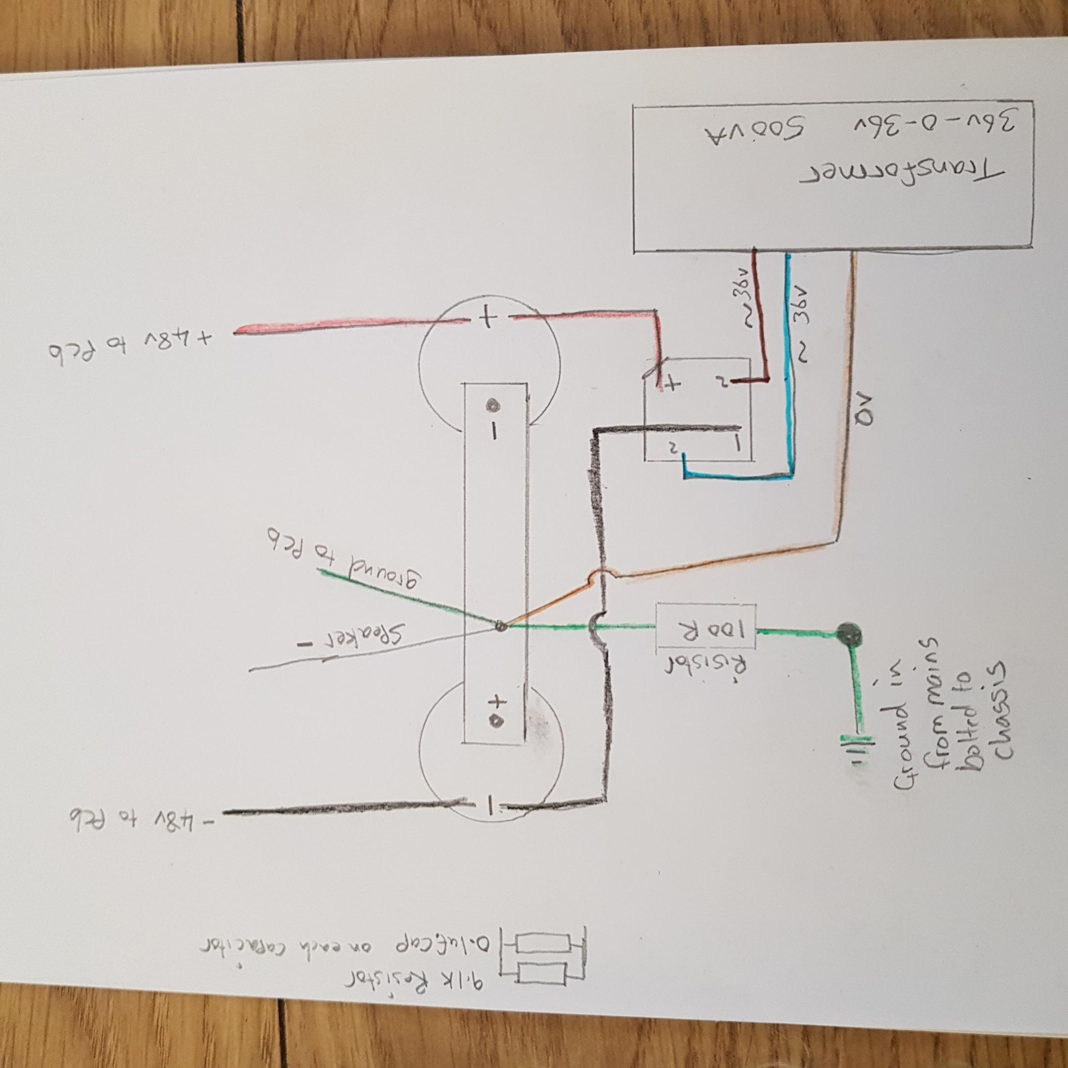

Hi Dave,
The wiring is correct on the drawing, the 100R 'floats' 0V from the chassis helping to prevent ground loop hum.

Yes, but it should be 10R, not 100R 😉
Thanks neychi I will change them to 10R.

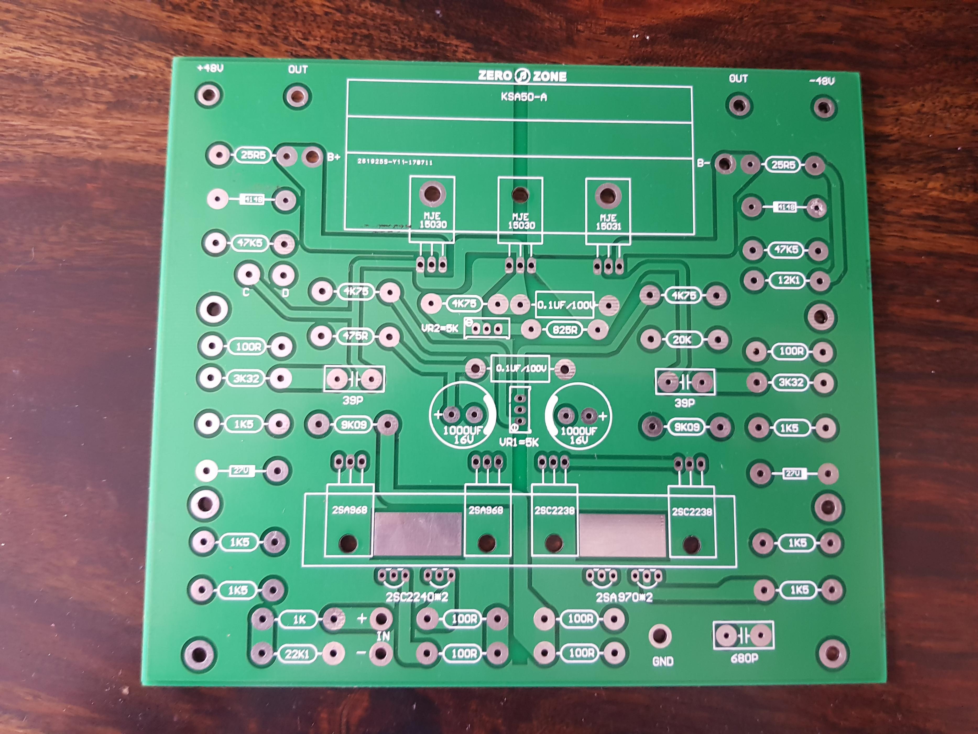

It helps if you post the schematic matching the PCBs you used.
Hi thanks for your help grimberg
I tried it with output boards removed with and without 25R resistor and speakers conected.
I get a low distorted sound from speaker of music playing.

Another thing is with no output boards 25R resistor meter conected my dc trim pot does nothing when I turn it and shows -0.7v.
A speaker is too low an impedance, got any headphones?

...my dc trim pot does nothing when I turn it and shows -0.7v.
What is the measured voltage range at the pot wrt 0V?

The 25R emitter resistors must remain in circuit for it to work properly.
Before connecting the output devices I tested my main boards with a small 8 ohm speaker attached and was able to hear music playing clearly. If the sound you hear is distorted, chances are that one half of the input is not reaching the output. Remove and test the drivers (1503x) to which the 25R resistors are attached.

Thanks grimberg I fitted the other krell ksa pcb but have exactly the same problem 1.5v dc.
I removed speaker protection and set bias to 280mv transistors reach 46c at heatsink after 45 minutes in hotest part.
Speaker I am using is a old 6 ohm centre speaker which works fine didn't fancy plugging my good speakers in until I have got rid of dc.

Hi supply rails + side I get +46.1v - side -46.6v but noticed -48v side transisters bias to 150mv when +48v side are at at 220mv bias.
Just noticed without speaker conected both sides are 46.8v and I get 190mv at resistors both sides

Same problem with a different board, are the supply rails similar?
Can you upload a schematic with the measured voltages (with and without load) just to be sure where in the circuit your measuring.

I was testing voltages with my meter not that I had a clue what to test and my meter probe slipped and shorted something out didnt see what.
I stripped all my output stage down checked all transistors are mounted properly amp actually works with a capacitor in line with speaker wire to get rid of dc.
Dc is coming from main pcb board just can't work out why.
Yes I have blown my 15030 and 15031 transistors and all the output stage on the -48v side.
I was wondering if it could be I have chosen a wrong type capacitor eva my jantzen mkp 0.1uf caps or my silver mica caps as both board's are doing the same fault.
My only other option is are those c2238B and A968B transistors can I test these somehow.
...Dc is coming from main pcb board just can't work out why.
Is D3 upsidedown?
