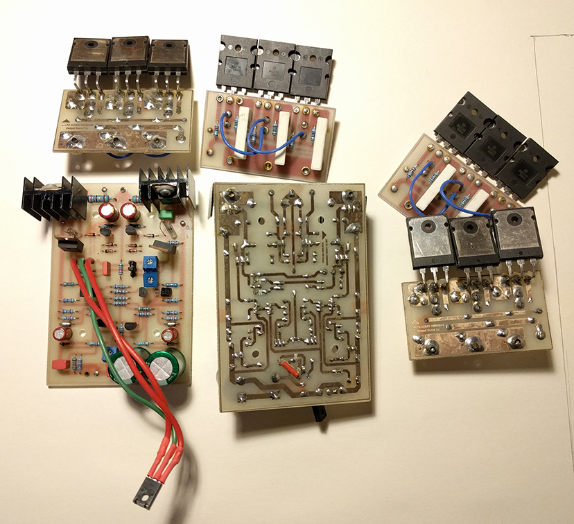

Awhile back I received these populated KSA-50 clone boards from a friend of a friend who was moving and had repurposed the power supply. Supposedly they work just fine. This will be my second class-A build, the first was a 10W JLH, so this is a pretty big step up and I’d appreciate any input on my proposed clone.

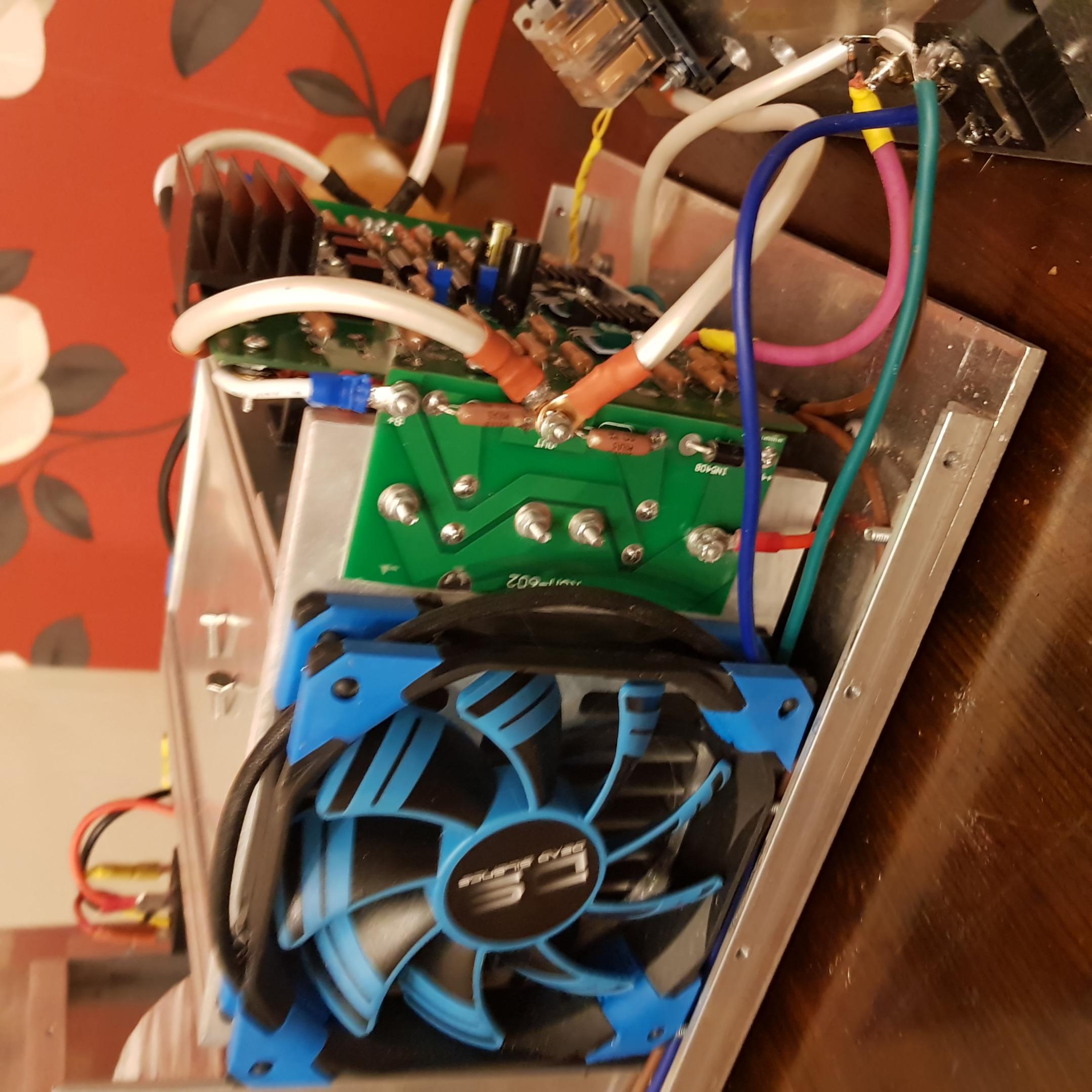

Hi looking for some help please as I made a mistake on my amp build.
My output transistors shorted because I used a conector which was too large and moved shoting out my B+ to out on my output transistor pcbs.
Which parts may I have damaged and how do I check please.

Did you test the main board before connecting the output devices? If you have not done so, that should have been the preliminary test before attaching the output devices. The main board should be fully functional and you can even connect a speaker and play it at low volume.

No I didn't I connected it all up and tried to afjust dc offset but can'tget it lower than 1.6v.
I suggest you remove the main board from the heat sink assembly, connect it to the power supply, start it and debug it until you can hear music playing through a speaker attached to it.
The power output stage drivers should be loaded by resistors of about 25R, so you don't need the output transistors attached to be able to have a fully functional main board.
It helps if you post the schematic matching the PCBs you used.

It does play music for a couple of seconds but output protection kicks in.
These are the pcbs I am using meant to be exact copies of original krell ksa 50 mk11.
I am not sure about the ground on this amp if I have got it correct.
Should the pcb ground go to the same ground as speaker or to chassis ground or should the be a resistor between speaker ground and pcb ground.
I need to solve the problem of 1.6v dc at speaker and then I think it will work ok.
