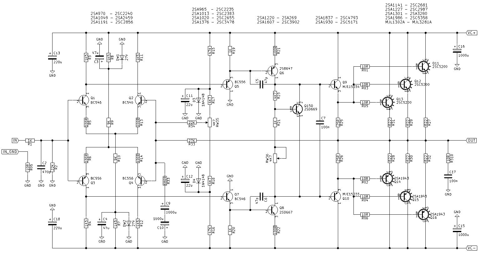

This is a 1:1 of original layout. It is this im using to build my clone.
It is also possible to use delta audio boards,but they are not the same as original(parts also differ). Well documented in thread.

Well, what is the recommended board version ?
Attached is the version most people built (including me).
The KSA50 is very dynamic and fast, but most of all "listenable". It has an extremely wide bandwidth (200kHz at 1 watt), low distortion and low noise.
Even though is is an "old design", I believe it is a benchmark even today. It is a very forgiving design and a lot of parts (many different transistors can be used) are not critical.
The design is tried and true as built by many DIYers.

medisinmannen, I got the schematics of your boards, they seem to be the early Mk2 version without mosfet ccs. They as well have some changes compares to the schematic from THD+N...(not sure how I can attach a pdf here)

And you would recommend this version of the PCB ? I see that this one has the LM339 CCS on board, while the green ones above do not have them on board and I guess the ones of ounkmouse neither ?
I am asking if you think which version to pick as Jim is charging a hefty margin on the red board (80$ for a stereo set)...you could get for that money a fully stuffed set of boards incl. speaker protection from aliexpress.

LM334
I can't give you a recommendation for other boards that you mentioned, but I can tell you my experience with boards that i have and they are very positive.
If you want to go a simpler way then buy green boards without mosfet-ccs, but if you want the option of upgrading to ksa100mk2 some day then buy Jims boards.

You will change the characteristics of the input filter somewhat.
And you will find there is somewhat less noise with 22k than 100k.
I would be surprised if a line stage can't deal with 22k ?
Is it a special configuration?
