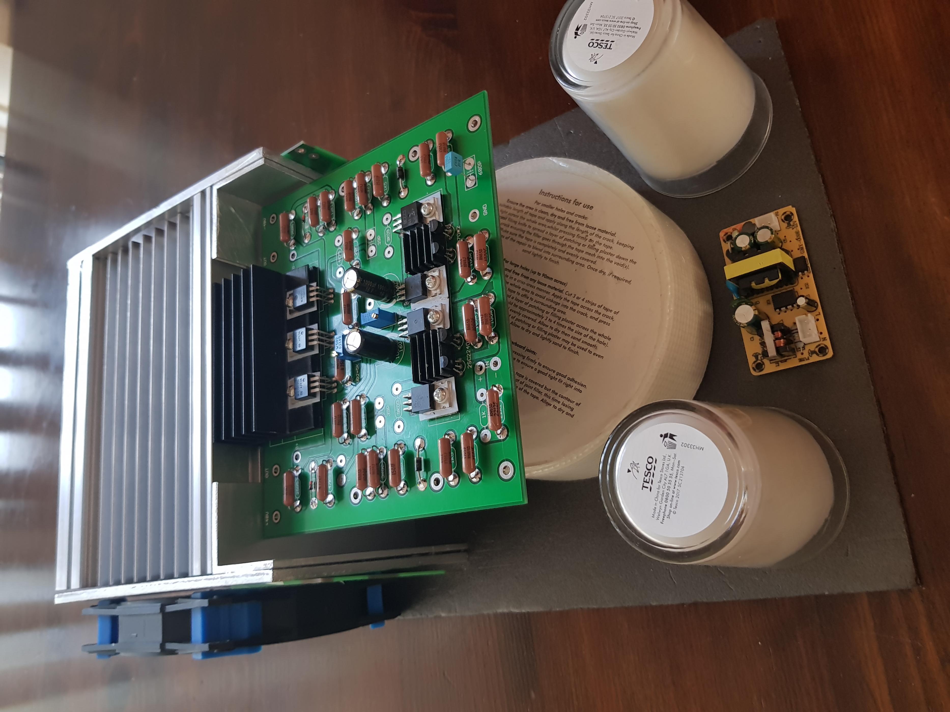

I have got a few questions.
should I use kemet ALS70 51,000uf 63v capacitors x 4 2 for each mono block £19 each are these suitable (RS components).
Just that i read somewhere 105c are better but ALS80 are twice the price.
also are SMC silver mica 39pf 500v £2 each a good choice for the 39pf on this pcb.
Are mills 0.5R 5w resistors a good choice for the output transistor pcbs 0R5 position also noticed some people are using 0.68R (hifi collective).
what is a good choice of 0.1uf capacitors for this pcb I was thinking of Audyn true copper max 0.1uf £13.99 (going by humble homemade capacitor test) but they are large 21mm x 45mm so i would have to mount them onto back of pcb.
500Va 32v x 2 transformers from airlink transformers £50 each should give me 48v DC I hope.
I am going to use two pc fans in push pull at a lower speed to keep heatsink cool and noise down will I be able to run in full class A at 48v.

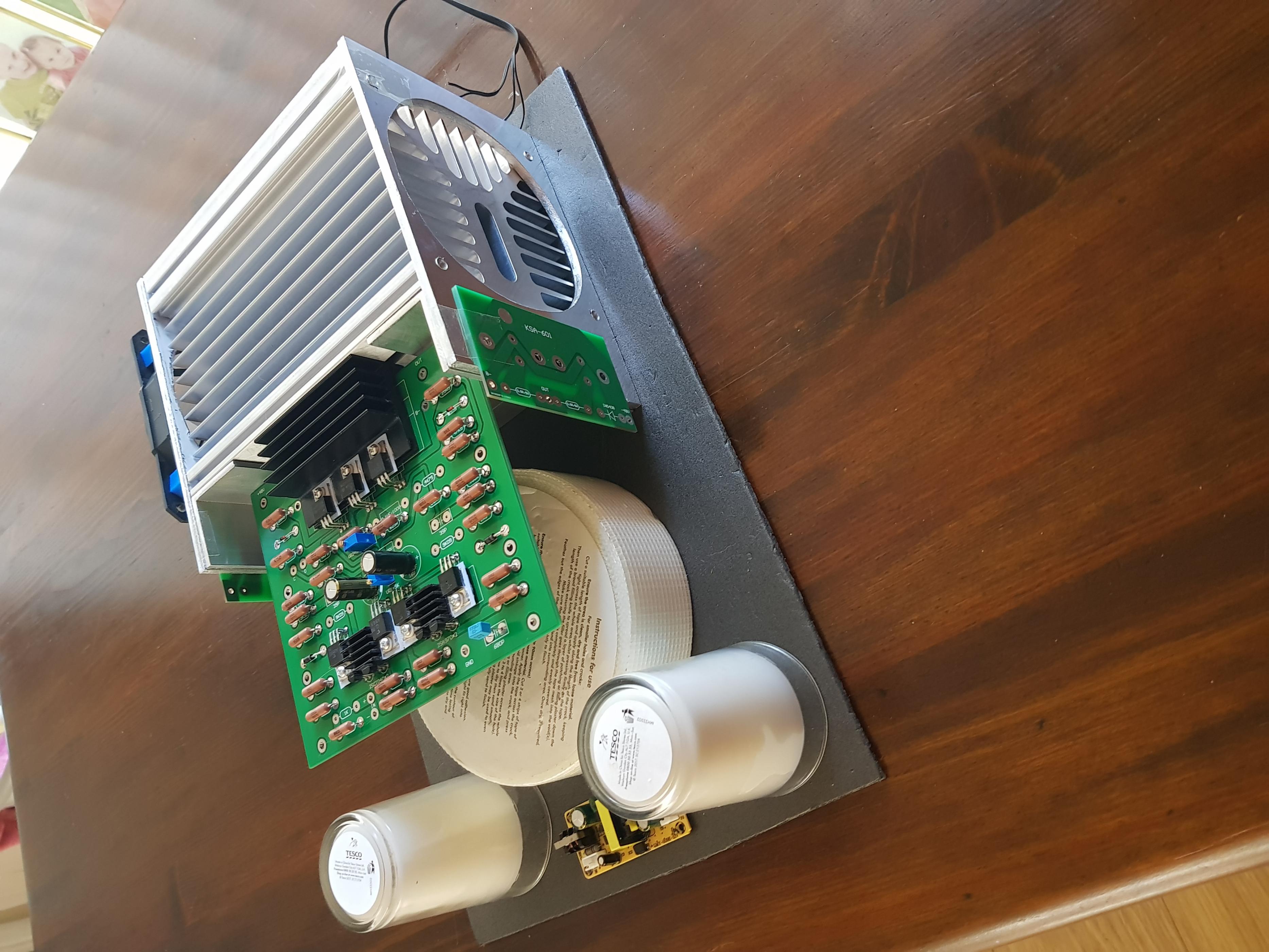

Is it ok to mount pcb above transformer Like I have it in photo.
Should I add speaker protection or is it not needed.
Just do not want to start ordering these parts if they are wrong in any way.

Hi Dave,
I've looked at the data sheet for ALS70 51,000uf 63V and the ALS80 47,000uF and they both have the same ESR (100Hz) and impedance (10KHz).
If I was buying these I would go for the ALS70 and save the money for something else.
Go with the mica - for caps that are pF.
I would not go higher than 0.5R. The Mills are non inductive and don't use steel endcaps, so they are not attracted to magnets.
If you are bi passing filter caps, you can use Wima 0.1uF 100V polypropylene etc.
The caps that you are referring to (Humble Homemade capacitor test) are used in the signal path or in speaker cross overs.
I would not mount the PCB over the transformer as you are most likely to pickup hum and/ or noise.
A "better" arrangement would be to have the heatsink between the transformer and the PCB. It might act as a shield.
Hope that helps.

Thankyou this has been really helpful I will change my layout and use wims caps.
